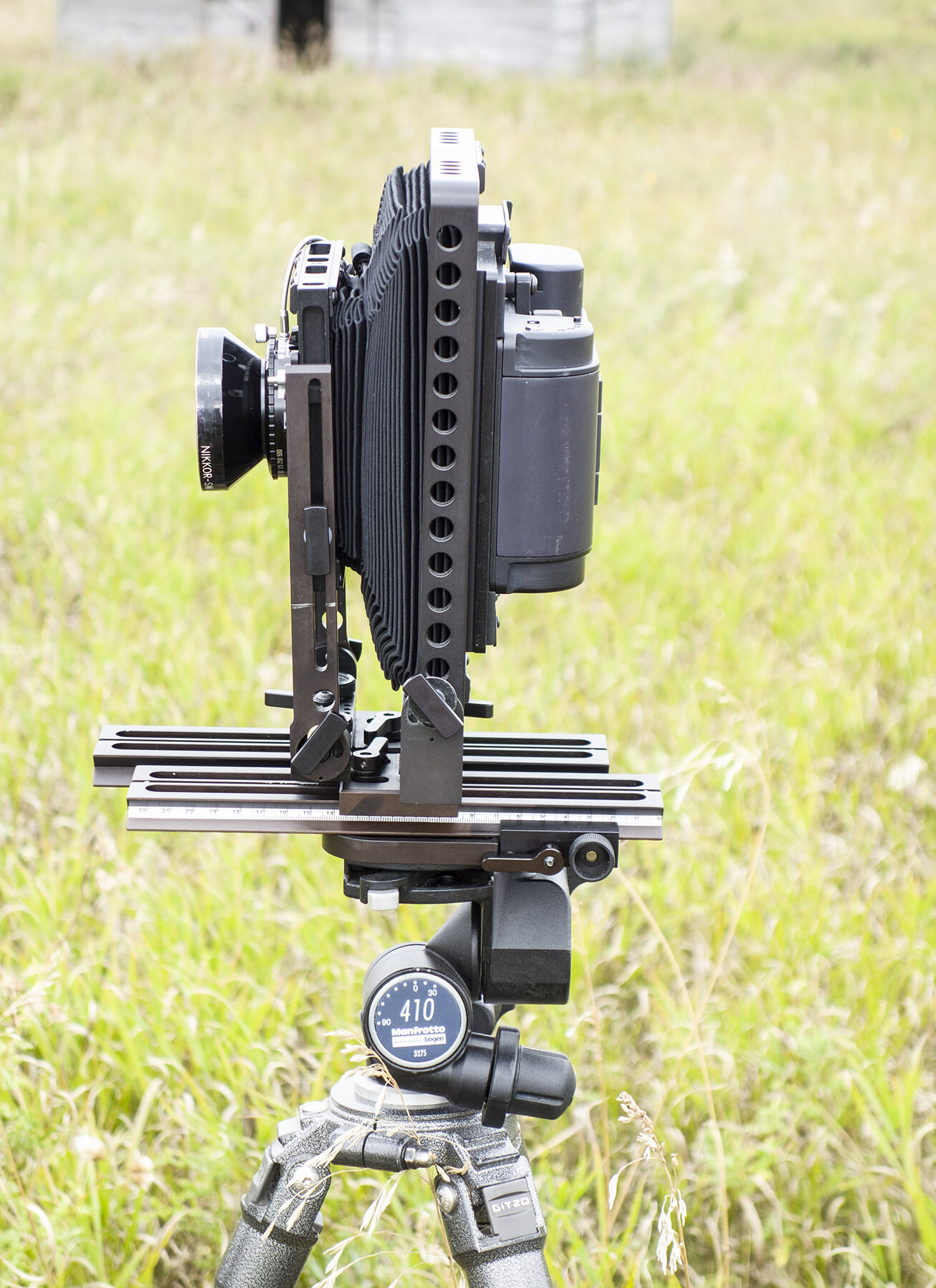

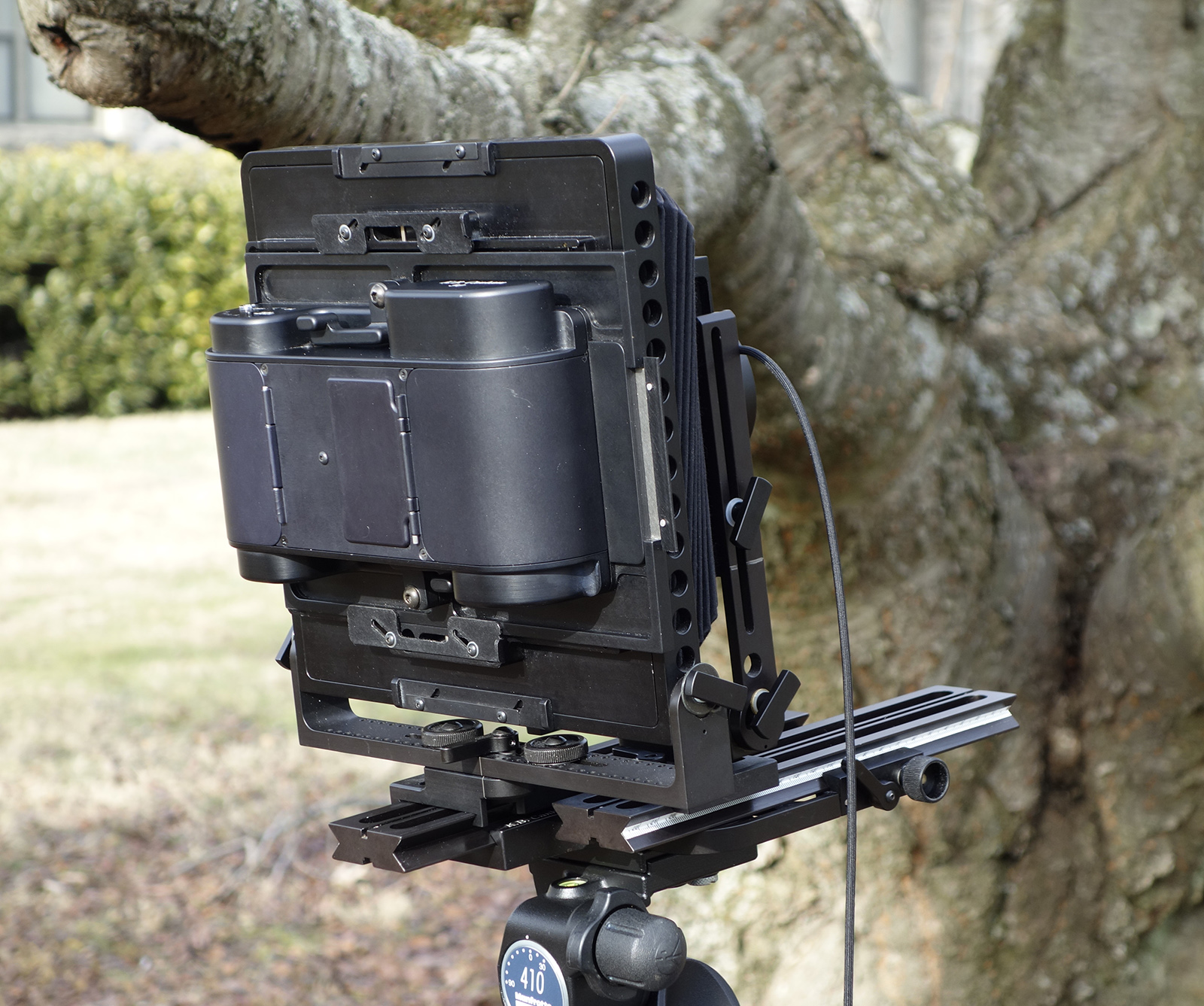

If you want to use more lenses and perspective controls of 4x5 camera, then the cheapest option right now might be the Intrepid Super 120 multi-format roll film back. I don't have experience with that yet.
