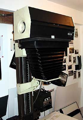

  2. claytume
    claytume Member
    Messages:
    279
    Joined:
    Jun 2, 2004
    Location:
    Wellington,
    Shooter:
    Med. Format Pan
    That's interesting stuff you've found there!
    I shoot 6x30+ and stretched an enlarger to cover the negs, so yes it can be done ok if you're prepared to do the work. I usually print mine a metre long, at that size they're less than 4 times enlargement and extremely sharp.
    If you want I can print a few negs for you to give you an idea how they look.
    attached is a pic of the enlarger.
    Clayton

  5. OP
    PhotoPete
    PhotoPete Member
    Messages:
    320
    Joined:
    Aug 23, 2005
    Location:
    Waltham, MA
    Shooter:
    Holy smoke! I'm not sure I could even fit that in my darkroom! Did you make that entire enlarger from scratch? Are there plans for it or did you just improvise?
  6. claytume
    claytume Member
    Messages:
    279
    Joined:
    Jun 2, 2004
    Location:
    Wellington,
    Shooter:
    Med. Format Pan
    I stretched a 4x5 out to 4x14........no plans, just improvise.
    Clayton

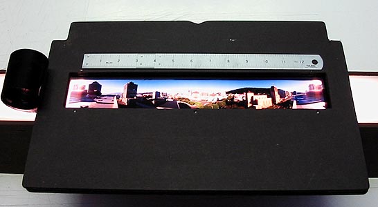

  7. claytume
    claytume Member
    Messages:
    279
    Joined:
    Jun 2, 2004
    Location:
    Wellington,
    Shooter:
    Med. Format Pan
    Here's a neg carrier with a single 120 frame in it.
