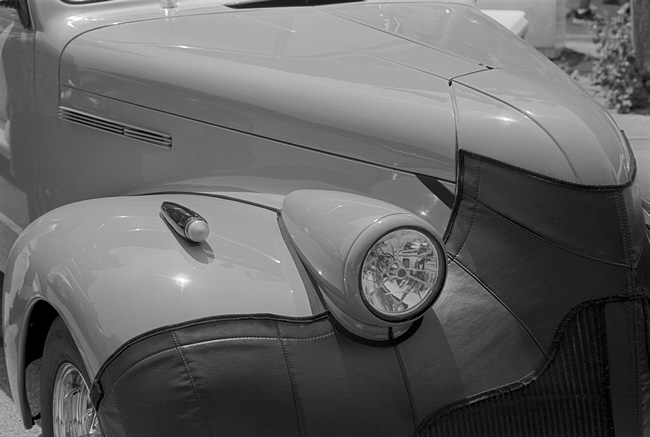

I started back testing this combo this winter, but didn't get far, and only developed a 35mm roll with no solid tone test frames. As I recall, I went 1+100, 12 minutes, 20C, with a couple of inversions each 30 seconds. My negatives were a little underdeveloped, but I don't have any sensitometry on it. Then I tried Efke 25 and haven't gotten back to the PanF+. I've always done the slower films, Agfapan 25, Panatomic-X, and Pan-F at 1+100 in Rodinal, so I don't have any times from old memory at 1+50.
I recently did a roll of Efke 25 at EI 25 and titrisol's recommended lesser agitation, one inversion every 2 or 3 minutes after the first minutes, and got gammas of about 0.6. There's another thread here discussing that tactic with PanF+: (there was a url link here which no longer exists) but it came to no final conclusion.
I'll attach a frame from last week with Efke 25 at the lower agitation rate, one inversion every three minutes after initial agitation of 45 seconds, and with a 3 minute presoak.
In any case, I'd recommend a shot at reduced agitation and perhaps greater dilution as well, as ways to keep effective film speed up while controlling highlight densities.
Lee
