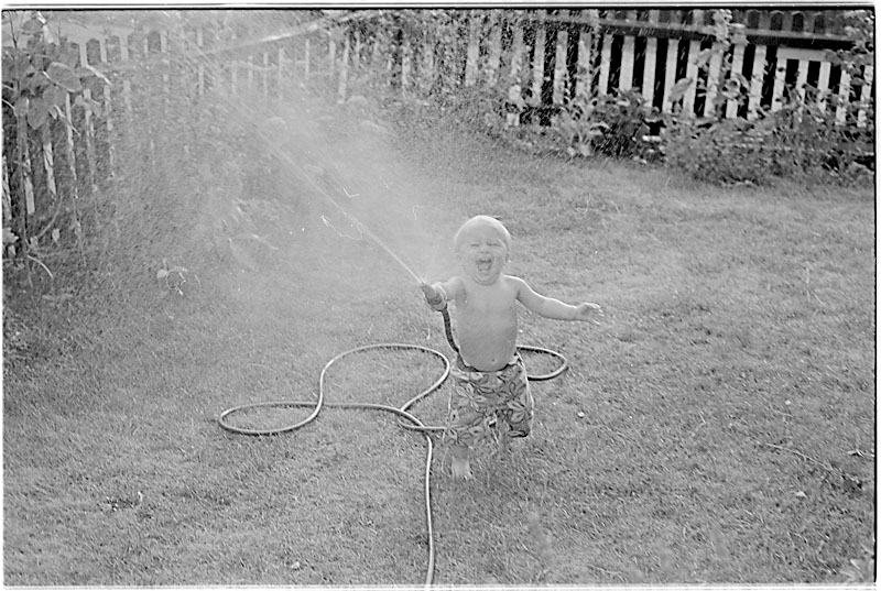

As I couldn't stand the uncertainity of this I rolled up 12 frames of efke 100 and took some pics watering in the garden (I got some help, as you can see.). Then I developed exactly as before, well not exactly, as it worked fine this time! I am puting my bet on some fixer staying in the spirals.
thanks for the help.
/matti

. . . But the start of the film look black, if small ammounts of fixer was the problem, I suppose it would look grey, wouldn't it?
/matti
Fixer contamination could affect the image without noticably thinning the grossly overexposed start of the film. If the Efke film has factory printing on the edges, that can be used as a rough guide to analyze exposure or developing problems.
