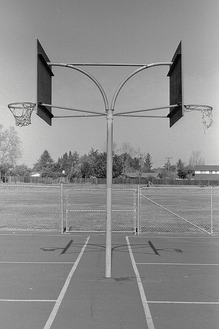

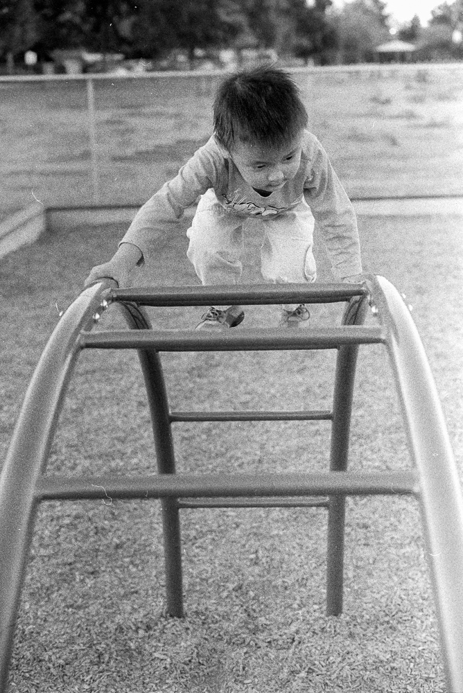

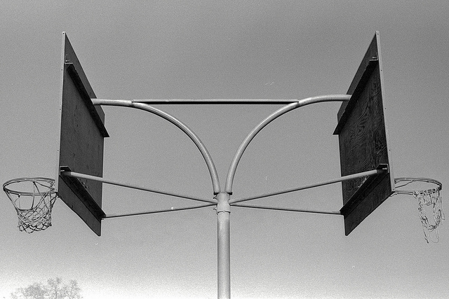

6900677779_eb911aace9_z.jpg 6900677585_c028fa2f69_z.jpg Hi films gurus,
I ran into a problem of development and would like to know your opinion. I often got negatives (35mm) with the edge on one side appearing to be over-developed - meaning brighter and often blocked highlight. I diluted 15ml HC-110 syrup into H dilution and developed 4 rolls of 35mm films in a stainless steel tank. Temperature was 20 C, and development time was based on recommended time. I did 30 seconds initial inversions, followed by 2 inversions per 2 minutes.
Thanks,
Jimmy

Looking at the climbing gym photo, it looks like it may be a light leak. I would guess that it is in the tank looking at the horizontal basketball hoop shot......it it were in the camera, it would need to be toward the top of the camera which doesn't seem likely on a Leica.
