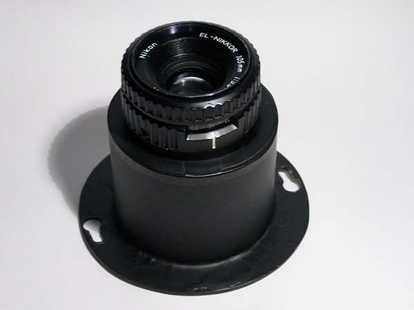

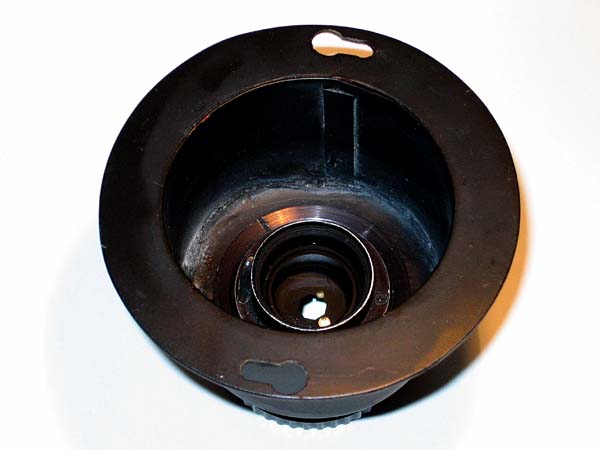

I did a survey of my forty year accumulation of junk and turned up some copper flashing and some copper-clad fiberglass printed circuit board laminate. From the PC board material I cut a ring and a disk with a hole to mount the lens. Then rolled up a strip of copper around a mandrel (AKA piece of old pipe) for the barrel. I trimmed that down to butt joint the ends, then used a quarter inch strip to lap the butt joint on the inside. The stuff was then soldered together, cleaned up, and spray painted flat black. I made the screw holes on the mounting flange with keyholes so the cone can be switched without taking the screws all the way out.
Nothing too exotic -- soldering the stuff together took a bit of improvisatory jigging in lieu of having three hands. And no, the soldering will not win me NASA certification. :tongue:
Here's outside and inside views with an EL-Nikkor 105 f5.6 installed in the 2 inch cone ...
The flange outside diameter was based on the flat disk for the 50mm lens and the rest was guesstimated to allow room to get the locking ring in to mount the lens.
