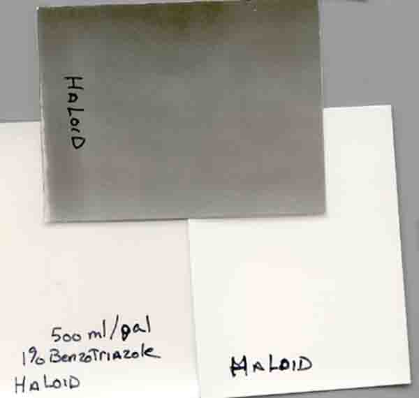

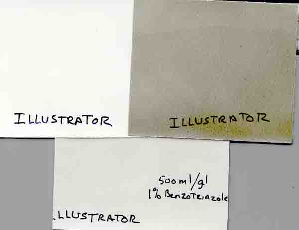

I finally got the time to go test some of this paper. Here are the results so far.
IÂ’ve only wrote about 3 of the 4 papers. The Opal did not respond to the anti-fog solution.
All the paper were extremely fogged as seen in the attachments. I took a piece of the paper out of the wrapper and put it directly into the developer. I then add 50ml, at a time, of a 1% Benzotriazole solution until the fog was reduced to a acceptable level.
All paper came down to a level simulating flashing the paper. The following is what was used in this process.

Illustrator
Exposure: F4 for 18 sec. The attachment below is a scan of this paper. It seems to have lost some contrast. I will try with a more active developer next time. To my surprise this is a beautiful paper. I think with toning it might have the same look as the palladium paper that the Palladium Co. made.

Haloid
I ran out of time so I didnÂ’t get to play with this one at all. I did a couple of sheets at 1 min. Still a little light but I will be able to get a good print eventually. The anti-fog worked best on this one, almost no visible depreciation. Even when it was the worse when I put it straight into the soup.
Well thatÂ’s what I got for now. Any ideas or comments will be appreciated.

Haloid Paper: Developed in Amidol with some Pottasium Bromide The rest was sent to Michael Smith and Sandy King for testing
Best, Peter
Contact
Haloid is a CONTACT PAPER. So yes; I did contact print this. Same photo as I put up in the critique gallery but that one was a Platinum print. Sorry I really did not do much notation as the paper was intended for Michael Smith and Paula Chamlee in the hope that it would foward the research into a new AZO. My small contribution.....
Best, Peter Schrager
haloid
Don't use any antifoggant-it doesn't need it. For Haloid)
Best, Peter Oh yes-have fun with those other papers!!!
After printing some of the Illustrator, I found it to be quite beautiful. Almost with a platinum look after selenium toning. I put the paper into the toner diluted 1:20 for archival toning. Within a minute, seriously I was caught off guard on how fast this print changed color, it changed to a nice brown.
I have a couple of questions is will I still get archival properties if I dilute the toner say 1:50 or 1:75? Is one minute long enough to do the job?
Also when processing this print I get a odor I've never gotten with other paper, could this be the cadium in the paper?
I like this paper alot, I'm already visualizing some shots for it. Most people have ask where I got the antique print from. They hardly believe me when I tell them only the paper is old.
Okay, I finally got around to testing the Haloid Industro today, and I think it is from the same batch as the Haloid that Peter had, and mine was pretty foggy. I processed it in Michael Smith's amidol formula for Azo, and to get the fog down to a reasonable level, I had to add 75 ml/l benzotriazole 1% and develop for no more than 30 sec. Contrast was about a grade less than current Azo grade 2.
Peter, what were you developing it in that you didn't need any antifoggant, or is yours not from John Stafford's cache?
haloid
David-I'm pretty darn sure it was M. Smith's amidol formula with perhaps a bit extra Pott. Bromide. The paper was from the same source. Personnally I wasn't overwhelmed by the Haloid but I just played real fast with it then sent it out.

David, Did you have any luck with the Haloid? Mine was projection paper. Slightly fogged but workable. Not sure I like the look though.
The Haloid Industro grade 2 that I have is foggy, but definitely a contact paper. The speed is comparable to Azo. I get pretty decent results if I treat it kind of as Azo grade 1, add about 75ml/l benzotriazole to Michael Smith's amidol formula for azo, and expose for a development time of 30 sec.
