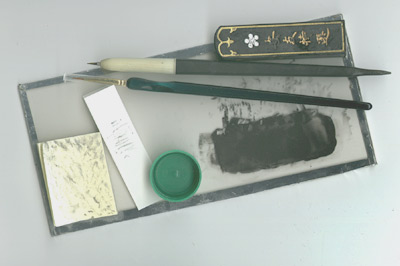

This is a lousy flatbed pic of my spotting rig. The palette is a piece of non-glare picture frame glass with a piece of photo paper taped behind it. I've seen this brand of Sumi stick in several large art stores. It is pretty recogizable. Here's a tip: There are other sticks that I haven't tried but don't use the liquid stuff. Sounds convenient but doesn't work well for spotting. Also, Inks are a different technique than dyes so the first time you try it, you'll probably say "this sucks", play around with it and once you pick up the style (probably easier than learning dyes), you can whip over an entire print very quickly and if you screw up, wipe it off and fix it.

Flotsam- I like the Sumi approach and although I've not had problems with the spotone except for the VERY light spots this sounds very practical. I always love learning something here. Thanks!

Neal (Flotsam) - Sound lilke a great idea. I assume Art Supply stores have the Sumi Sticks? By the way, what is that pen-like thing with the sharp tip in the photo of your set-up?

Peter, A stick of Sumi costs 4 or 5 bucks. It is worth playing around with even if just out of casual interest.
I've seen Sumi sticks all over the 'net and and my local Pearl Paint.
That pen-like thing is a Robert Simmons Lancer 3/0. It is my favorite brush because of its big diameter barrel. It is perfect for gripping and twirling with my big, fat fingers. I've had it for many, many years and will be heart broken when it wears out. If anyone knows a source for these or similar brushes, please let me know.
