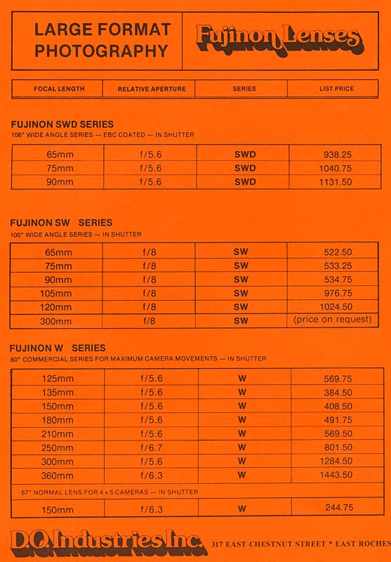

The 80 degree coverage Fujinon lenses were better than the replacements because the replacement lenses no longer covered 8x10!! I was fortunate to get the whole set of lenses for my 8x10 use, back when they were considered 'outdated.'
