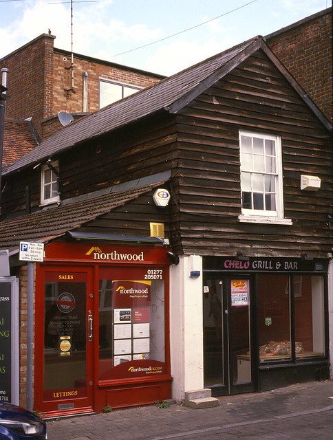

Using up a 2002 Fuji RMS Film in my 2002 Hasselblad 501 CM + 80mm f2.8 CFE Planar T* + 16-on back I used full aperture as sometimes I have been disappointed with the full aperture results on this lens but this time I could see all the fine detail under a x6 magnifier on these old buildings in Hart Street, Brentwood, Essex, England.

Nicely done!
The 80/2.8 may be underappreciated since it's so common, but Zeiss made a great lens.

Since you are disappointed with the 80mm f/2.8 lens you need to rush out and buy the 100mm f/3.5 CF lens. You will not be disappointed at full aperture.

I think the plasmat is too sharp even wide open. Perhaps a soft focus filter or lens would help reduce the signs of aging on these old houses.
Isn't the point of these photos of old buildings to show their character. Would you hire a carpenter and painter to spiffy them up before taking pictures.

What do you attribute your previous disappointments to, if you are satisfied with this result now? Missed focus, I presume?

No-one has asked this question, so I will. Why do you have to shoot at full aperture?
Depth of field at f/2.8 with an 80mm Planar isn't particularly great. Very very very careful focusing is essential. Also the use of a tripod. Your best images will be head on. Sidelong shots as you posted, will often result in the actual area you focus on being sharp, and most of the rest slightly to very unsharp with consequent loss of fine detail due to blur. This latter point is a definite and cannot be avoided. If you intend to shoot with an 80 f/2.8 at f/2.8, you will have to learn to live with out-of-focus areas. End of story, basically.
Like you I used a Hasselblad (500C, then 500C/M) with the 80 and a 16 back to shoot interior designs. I had all the problems listed above. For interiors (which I designed and consequently had to photograph in detail for visual records), I found f/5.6-f/8 was the sweet spot with the 80. Eventually I bought a 50 which gave me much better sharpness wide open at f/4.5, but selective focusing issues as well. Not exactly a win-win, but a make do. I used mostly the 80 in my work for ten years. I found the two lenses gave VG+ definition and fine detail, so for me lack of sharpness due to focusing was the problem.
For reasons other than the 80's sharpness and ability to shoot fully open, I sold the Hasselblad and initially did my work with a 2.8E2 Rolleiflex with the 80 Xenotar, which gave much sharper results. After experimenting I discovered the sweet spots was f/4-f/5.6.
I changed over to another medium in the mid 2000s and found this largely eliminated the focusing/sharpness problem, mostly because I could shoot as many images as I wanted without breaking the budget buying 120 film. The 2.8E2 now mostly sits on the shelf at home but gets taken out a few times a year for my cheesy landscape shoots.The 500C/M went to a Melbourne pro who still uses it for B&W advertising work.
Unless you are a purist and absolutely must use your Planar 80 fully open, I would suggest you buy EI 400 film and shoot it at f/4 or ideally at f/5.6. A tripod is a must. Use a ruled viewing screen (I forget what these are called but they are easily found even secondhand on Ebay) and watch your verticals as these are the first thing you will notice if they converge.
Also check to make sure your focussing on the camera and the alignment of the A12-A16 backs are correctly set. Hasselblads work beautifully but are fiddly cameras and mine (also the film backs) seemed to required regular CLAs and minor adjustments to keep them functioning. I gave up on the 'blad when I found I didn't relate to the ergonomics of the camera and also disliked having to poke the thing into my stomach every time I shot off the tripod. As well it is an unfortunate "truism" that these cameras are pro gear and need a lot of maintenance to keep them working at their best. My Rolleiflex 2.8E2 on the other hand, was manufactured in 1961 and has had two CLAs in its 55 year life. It is now a beater but is still working as new.
A last point. On the few occasions I shot wide open, those viewing my images (mostly clients who were paying me for the shoots and thus felt they could be more candidly critical) always remarked on how distracting the out-of-focus areas were...
I hope these comments will be useful to you. My two hundred rupiahs' worth as a (retired) interior design architect.

Thanks to all for your great replies -- yes, it may be 'Focus' accuracy but when i first got the 501CM new in 2002 I tried the 80mm f2.8 CFE Planar at full aperture at 'Infinity' and I reckon the 80mm f2.8 'Blue Dot' lens on my Mamiya C220 beats it, and the C220 was FREE ! If I see the 100mm f3.5 going for a good price I might invest ( but don't tell the WIFE!! )

Magnifier hood, 2 -3 stops down, tripod and trip the mirror first. 2-3 stops down is the most important step. Why shoot wide open in sunlight?

That photo was taken in 'poor' light so I could get full aperture -- I got 1/500th @ f2.8 -- any sunnier light and I would have run out of shutter speeds.

I'm second here to ask why full aperture for totally static object. Poor light and tripod makes more sense for shots like this. Instead of 1/500 2.8, something like 5.6 1/125 and monopod. Where is no lens made to be best at full aperture, but most are the best at f5.6.
Or was it just for testing?

Were you looking for a narrow depth of field?

It was just for testing as the light was good for full aperture and the buildings had some good 'textures' -- i know that f5.6 is usually best aperture.
