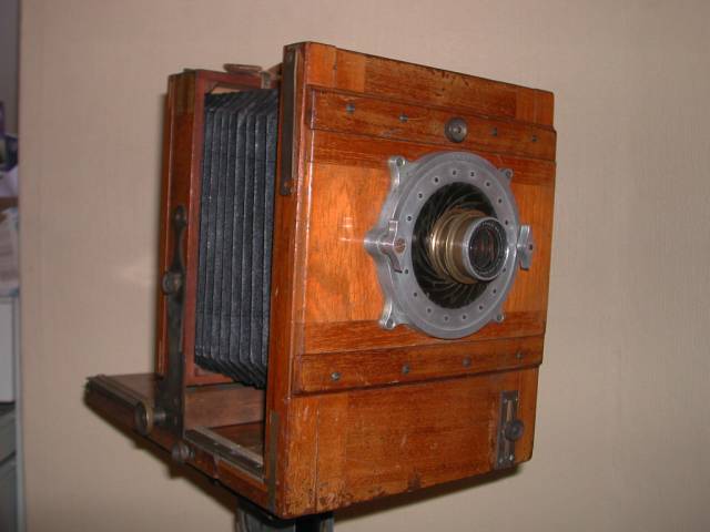

No, the easiest way is to get one of these:
It's an old plate camera, 13x18cm (takes 13x18cm or 5x7" film, and 4x5", 9x12cm and 6.5x9cm film with adapters), with a universal iris lens mount. Anything can be mounted on this camera, as long as the diameter is less than 8cm and greater than 8mm. If the back focus is less than 20mm or more than 600mm I'll have to use another camera, but I have that too. Only with less film size adaptability.
Ole
Sep 9, 2002
9,244
Bergen, Norway
Dan Fromm said:
Shutter, Ole?
Hat? Packard shutter? For small lenses (like the 180mm Dagor in the picture) I have a Thornton-Pickard rollerblind shutter I can put on the front of the lens.
But most of the time I use slow film, small aperture and a hat.
