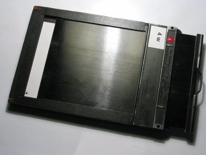

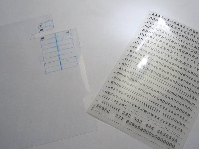

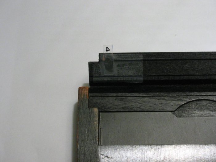

Mike, thanks a lot for the idea!
After seeing your system with film decal tabs, I decided to make something like that.
However, making copies using ortho/lith film was not very practical or easily available, so I opted for another system: I got a heavier transparency sheet (thicker than usual), some "Letraset" transfer lettering templates and followed the film decal tab idea. What I did was draw a grid on the transparency and just transfer the numbers from the transfer lettering "thingy"(TM) :smile:
Everything was done in about an hour - and I marked two holders. The tabs are glued to the holders and secured with clear sticky tape.
Another (a bit cleaner) idea, which I might try later, is to use transparencies intended for laser printing - draw the tabs in a drawing program and just print those on the transparency, cut them up and use those... The laser transparencies I found are a bit thinner than the one I used here, though...
It sure is easier and cleaner than filing/carving the notches in holders, particularly if you have older wooden holders (think sawdust!)...
Anyway, the photos are attached.
