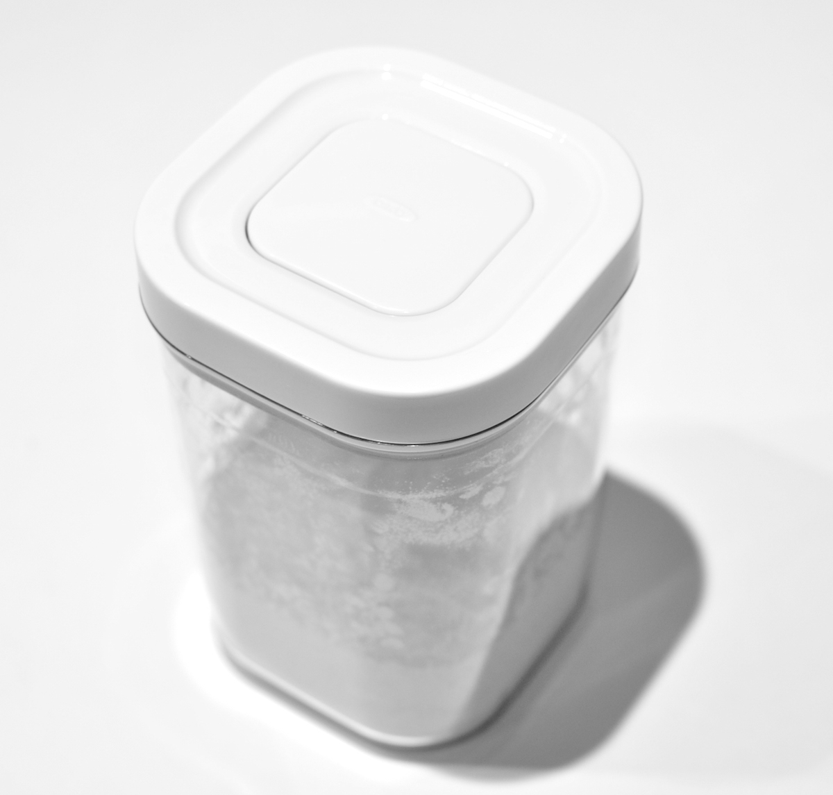

I have recently been exploring the possibility of extending the useful life of Dektol. I can't say I have ever used an entire 3.8Liters of concentrate before it turned almost black. What a waste.
With my last few powder packages of Dektol, I have been measuring out the appropriate amount of powder for working solution and keeping the rest in an air-tight environment. I shake the powder to keep it mixed well before scooping.
I scoop out 40ml of powder and mix that into 1 liter of water to make the working solution for an 11x14 tray.
Just last week I finished off an entire bag of Dektol that way. Perhaps the first time ever, even since the 1970s I was able to use the entire 11 liters without it spoiling near the end.

Of course, just when you figure out something, they change it. My last bag was the "Old" Dektol which was white powder. Looks like the "New" Dektol powder comes already brown. I just started my first bag of the "New" brown Dektol today. I'll see if it can be split up in its powder form like the "Old" Dektol powder.

Today I got some measuring spoons. I had been pouring the Dektol powder in a 50ml graduate to get the 40ml.
I got a whole set of these kitchen spoons but it looks like they make a big jump from 15ml (so called "tablespoon") to 60ml (so called "1/4 Cup").

There's no way to be sure your powder is evenly mixed, so its a risky method. Probably doesn't matter if you are willing to recalibrate with each batch, if necessary.
I can't say I have ever done a test print then processed the final print in fresh developer, so if there were a difference from batch to batch, I'd not know it. Though, people with other workflow might.
But this is somewhat of an experiment, to see what might happen. I'm just starting my second bag of Dektol today.
Maybe someone who has tried this in the past and had inconsistent results might chime in and explain the issues encountered.
I bought a bag of Dektol last week and returned it today. It would have cost me $13 for a gallon, but I realized I had everything I need to mix its equivalent, D-72. You might consider that and if you use a lot you'll save a lot, since you are willing to work with powdered chems anyway.

The biggest potential downside to inconsistent results arising from splitting up powder print developers is that for some papers, it will/may affect image tone.
Which only matters if you intend to display prints side by side, and/or to tone them to a particular target.
