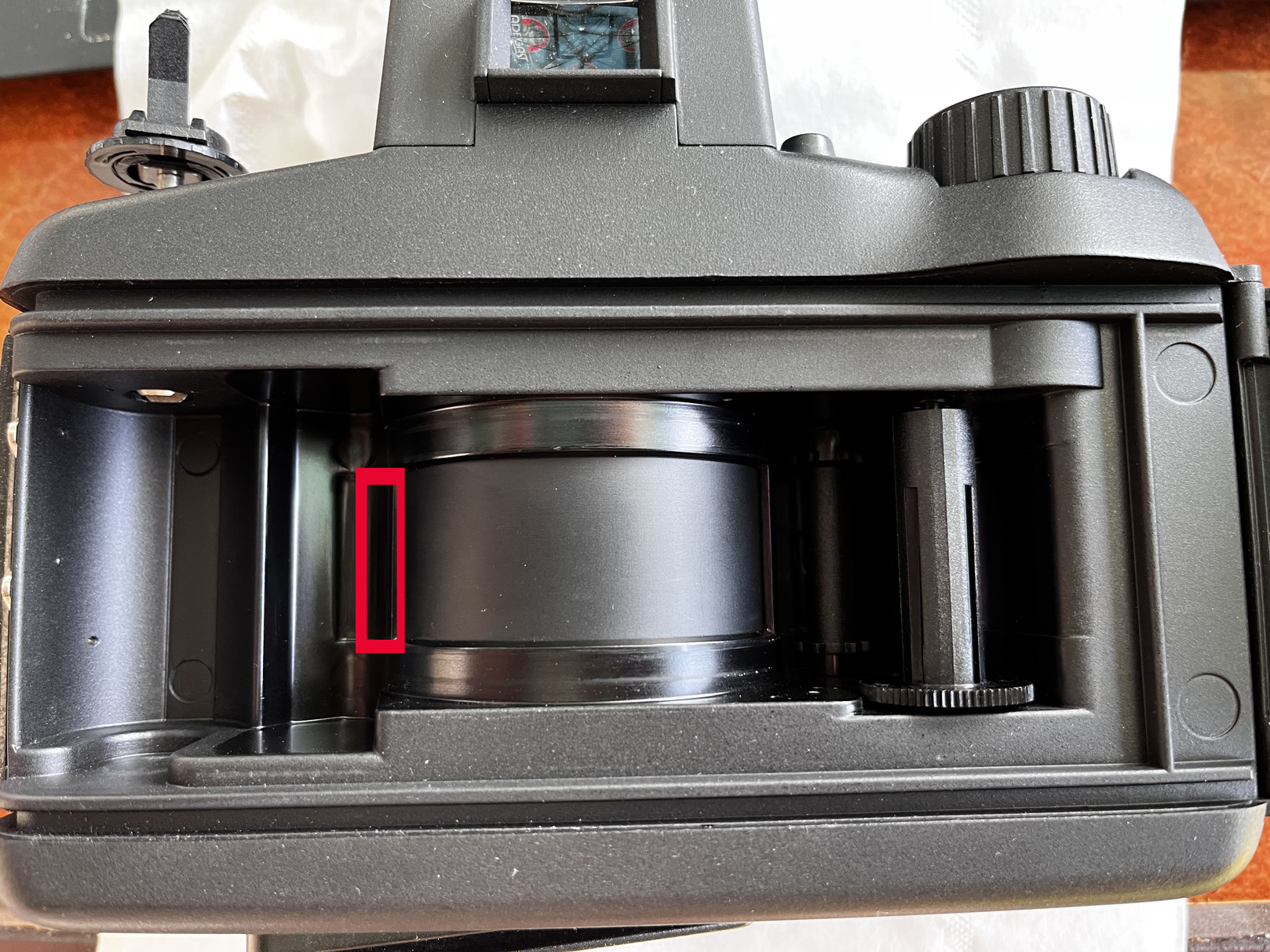

I found the problem with horizontal lines caused by scratching the film is common for Noblex cameras (models 135 and 150). I met the issue with Ilford HP5, Delta 100 and Fomapan 100. I try to polish inner areas using polishing paste where the film is in contact but have no reasonable results - one scratches fixed but new ones have appeared. I am struggling with the issue more then one year with no success. I have 2 Noblex 135 cameras and both make scratches. Scratches are on the emulsion/matte side. My guess of the critical place - check attached picture.
I have applied nail polish to some area - will let you know the results.

I am struggling with the scratches (horizontal lines) on Noblex 135 more than 1 year. I have found the critical area - contact with film. Many times I applied polishing paste (for car polish), also used the finest sandpaper (grain 7000) with results - some scratches dissapeared and some new ones appeared - never ending story.
Last chance - I have decided to use nail polish on the critical area inside the camera (attached picture) - result --> NO SCRATCHES FOR NOW! It seems to be solved but I will be sure when more rolls developed.

Yes, it is all right. But I have for the first time no marks/scratches on the film from my Noblex 135 S.
