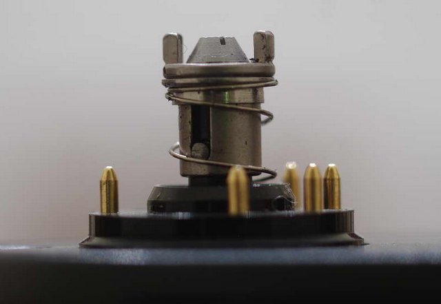

Nikon F3HP, Nikon MD-4 Motor Drive. I checked it before loading and shooting a roll of Tri-X. I had the orange dot set on the MD-4. Set the two switches, thought I rewound, and ended up exposing the film- it had not rewound. I did open it up without film in, released switch 1, slid switch 2 up- I can see the coupling spin. But for some reason, it is not engaging the film cannister. I can rewind manually, after releasing switch 1, but I'd love to automatically rewind. Any suggestions?

I am able to manually rewind it. But yes, the spindle is spinning- but maybe either missing a part, or not providing enough resistance. I know it is a silly thing, but I would love to get it to work. Today I was able to see the rewing side on the top plate move a bit- but still is not enough to get the film to rewind via motorized power. Someone on another forum said there is a spring that is supposed to fit over the spindle?

That's correct, there is a spring that puts tension on that part as shown in the pictures below.

Problem solved- it was the spring missing that caused the problem. Scooped up another MD4 at Photographica yesterday!
