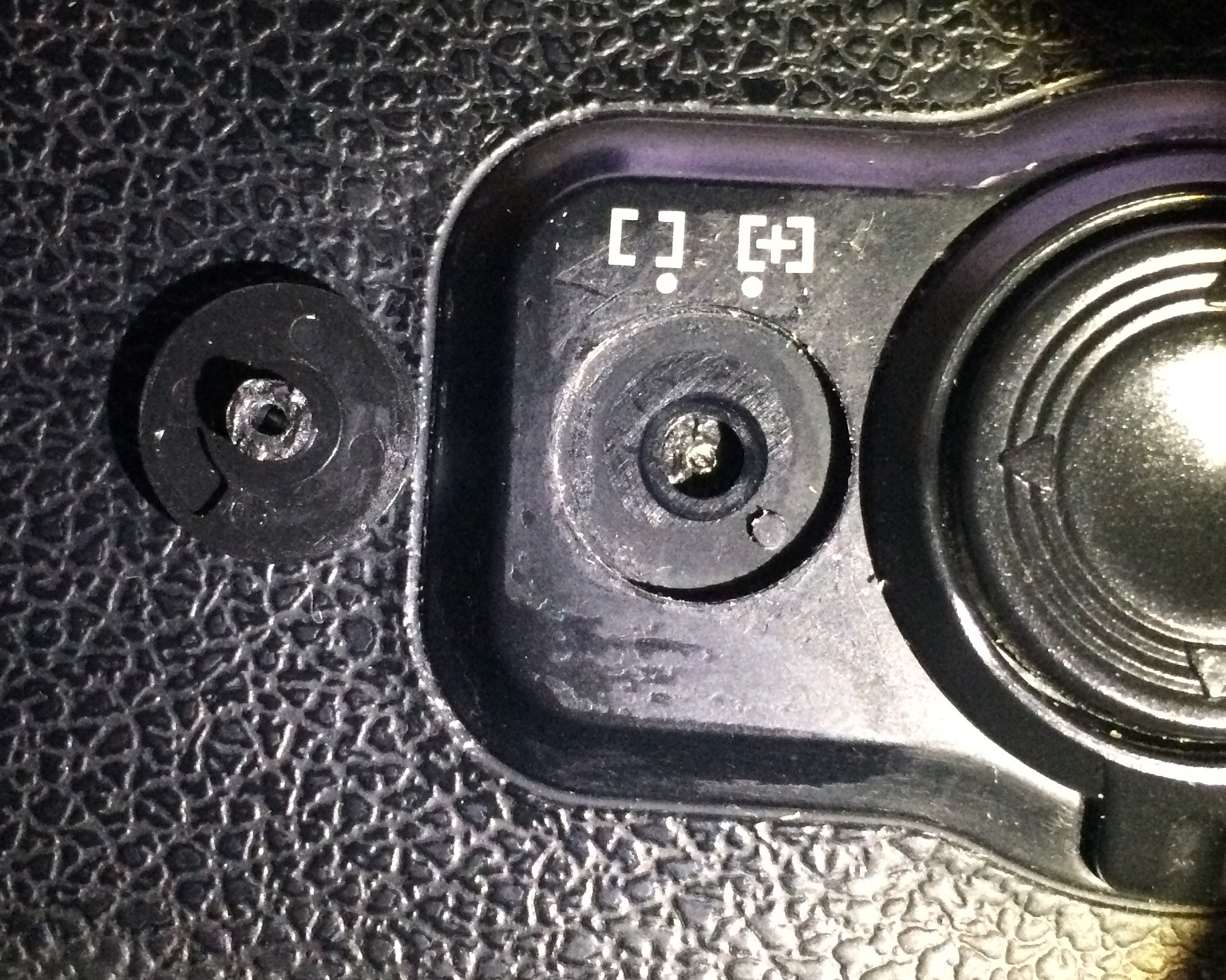

Small problem with my new/used Nikon F100. Overall, it's in great shape and works well. While shooting my first roll, the Dynamic AF dial (in the door) basically just fell out. I had been using the control, and it worked fine. Now, if I replace the button, it stays loosely in place but can easily be worked out with a sticky finger or just over time. It moves physically between the two settings, but moves past the left setting when it gets loose. But it won't change the setting no matter how I manipulate it. It's stuck in the multiple sensor mode. It's such a tiny piece, I can't tell if something's broken or it just came unglued. Thoughts?

The center shaft appears to be broken and jagged. Perhaps you can align the halves and drill/tap the thing as a repair...? Kinda' surprised Nikon used the proven bad plastic latches on the back. I remember when this was a serious problem years before with the N6006.

Yes, from my experience plastic on the cameras does not age well. Whole back body was cast from one piece of plastic. I have 2-F100 and both have latches problem. Was lucky to buy the last spare back from Nikon Canada. Now on one body I have back holding with just one tooth and another with brand new back. Good thing is, gaffer tape can hold quite well back closed if necessary

The F100 is the most over-hyped prosumer Nikon ever made. Yes lots of very nice features but throughout the camera inferior plastics and poor design abound. It's like the last great prosumer Nikon camera was designed to do just one thing exceptionally well, and that was to breakdown.

Obviously the back is an issue as there are an awful lot of broken F100s on ebay with the following description (taken from one listing):
And The Back Film Latch Is Broken So Door Will Not Close.
I gotta ask, could you have been sold the camera with the back already broken? Seeing this happened on your first roll. Perhaps send it back?
Well, it was a friendly APUG sale. The seller was forthright about its condition, which is otherwise excellent. I did contact him anyway, and he said he was unaware of any trouble with it. It could have been already broken, and the button just sitting tightly in place. I guess I just got unlucky.
