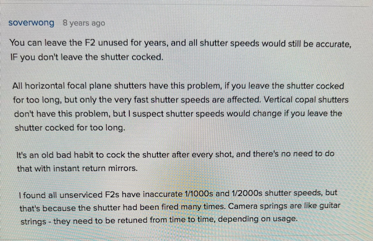

Sover Wong mentions that keeping the shutter cocked too long will affect the very fast shutter speeds.
What are the 1/500 & 1/250 considered…?

Are the 1/500 & 1/250 speeds of the Nikon F2 considered the fast or very fast speeds Sover Wong mentioned…?

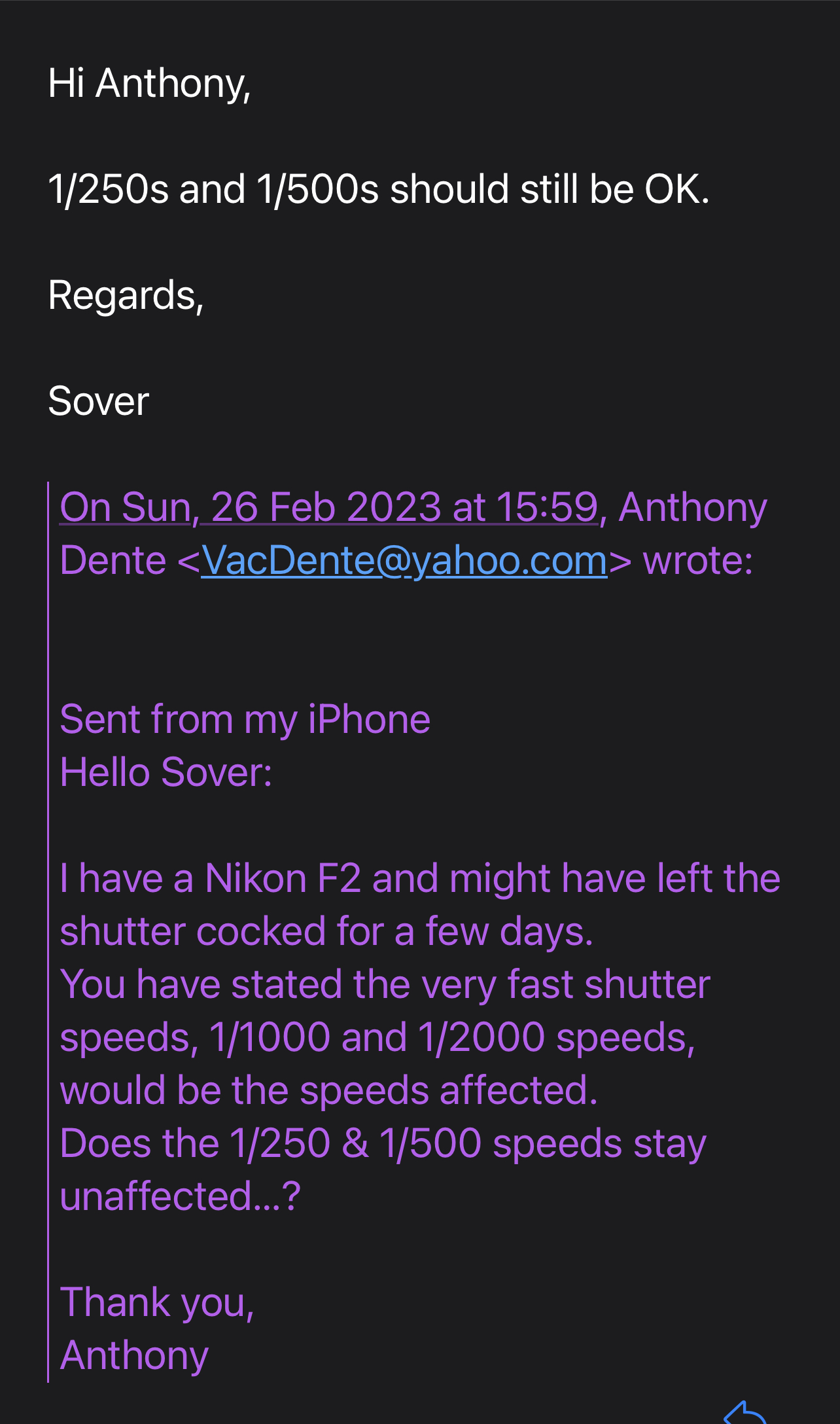

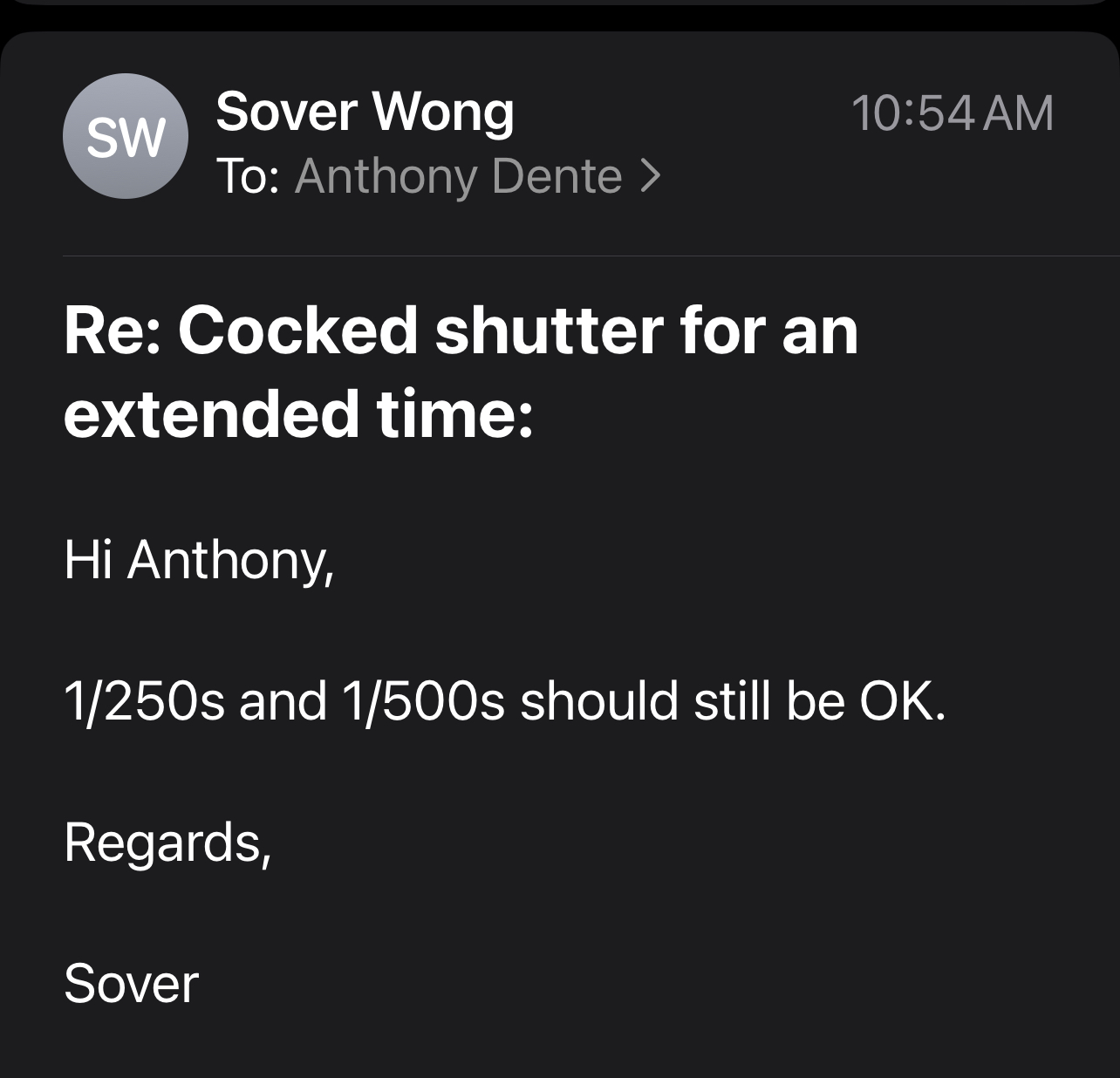

I know, but the thread digressed a bit. Sover stressed not to leave the camera cocked, and Leica says the same thing about their film Ms.
Sover and the Nikon F2 manual clearly states, don’t leave the F2 cocked for more than 12 hours...!
