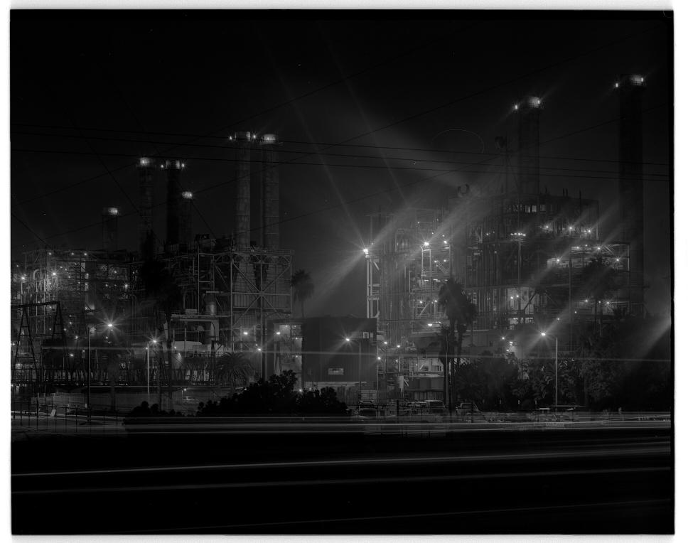

I don't know about 35mm, but this is a scan of a 4x5 negative. Fuji Acros @ ISO 50 developed in PMK. It really does hold highlights well without graininess. I deliberately overdeveloped a bit for alt. process use but I think you get the idea. Hope it helps!

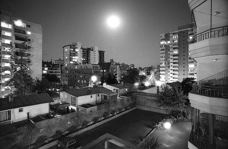

I've tried only Rodinal with stand development. For night photography I use Fuji Neopan 1600 rated at E.I. 1000, development 1+200 for two hours, agitation for just the first minute. I'm not interested in experimentation, so I can't attest this is the optimal combination, but works pretty well.

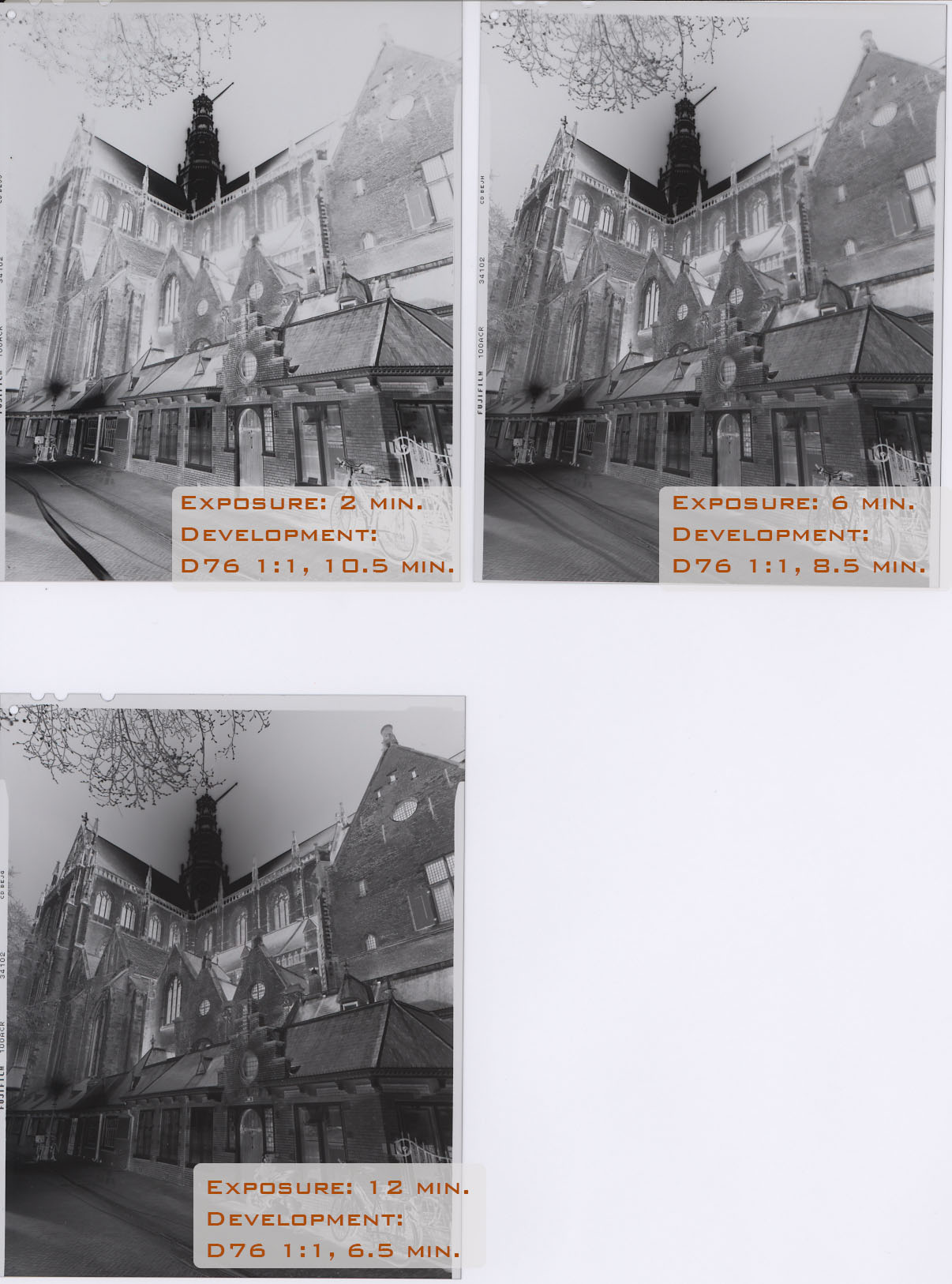

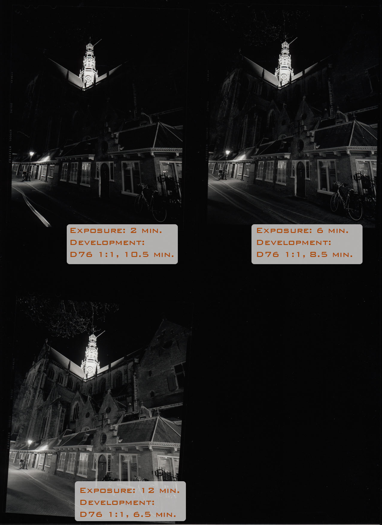

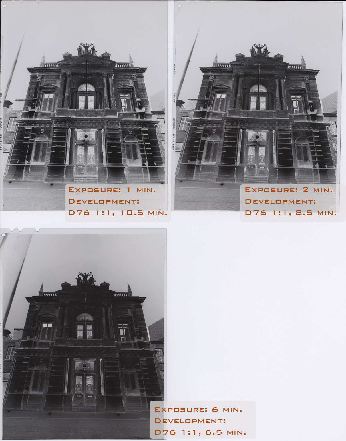

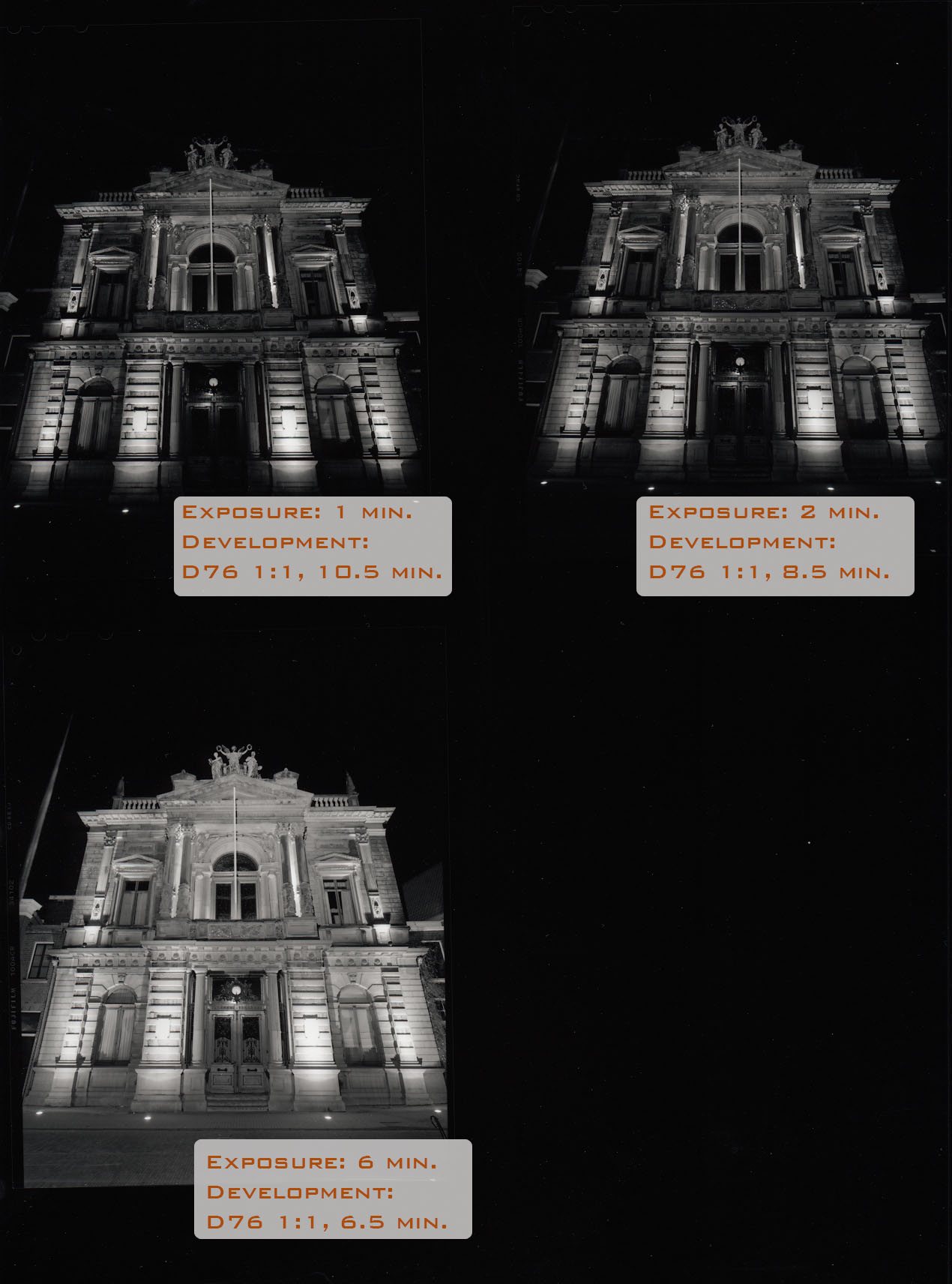

Examples of overexpose + pull development
Ok, I now scanned some negatives and contact sheets (printed at grade 2 or 2.5) I made for a small test I conducted using Fuji Acros 100 doing overexposure and shortened development.
See the images for the details of exposure times and development. Please note that the actual exposure times are not really "zone system" like, I simply overexposed by about 1 and 2 stops, while for N-1 and N-2 development, I think you would normally give less increase in exposure... On the other hand, we are already well in reciprocity failure range.
Anyway, I was flabbergasted to see these results when I first tested this last year. I didn't realize it was possible to bend the contrast curve this much... Although the negatives with longest exposure admittedly are overexposed, and loose the night atmosphere, if you look closely, you will notice the about 40% shortened development time has restricted the highlights very well... They are NOT more dense than the normal development of 10.5 minutes, in fact, they seem about equal or maybe even a bit less dense...
Although the 6 minutes exposure of the Teylers museum and the 12 minutes exposure of the St.Bavo cathedral look and are overexposed, since the highlights were restricted by the shortened development, I was able to get quite normal test prints from them using a longer exposure in the enlarger, and a harder grade (e.g. 3-3.5), to lessen the overdone effect of overexposure and shortened development.
EXAMPLE 1, Teylers museum, NEGATIVES:
http://www.boeringa.demon.nl/techni...tography/Example1_TeylersMuseum_negatives.jpg
EXAMPLE 1, Teylers museum, CONTACT SHEET:
http://www.boeringa.demon.nl/techni...raphy/Example1_TeylersMuseum_contactsheet.jpg
EXAMPLE 2, St. Bavo Cathedral, NEGATIVES:
http://www.boeringa.demon.nl/techni...ime_photography/Example2_StBavo_negatives.jpg
EXAMPLE 2, St. Bavo Cathedral, CONTACT SHEET:
http://www.boeringa.demon.nl/techni..._photography/Example2_StBavo_contactsheet.jpg
Hope this helps. Please note, that although this method works out very well for nighttime scenes, I am less certain it would be appropriate for daytime scenes, where the increased negative contrast caused by reciprocity failure is not a key factor, as in nighttime photography. Stand development and other specialized developers may be more appropriate there...
Of course, even using these methods, there will still likely be the need to burn-in some parts of the images, as is also the case with these two negatives, for example the lighted tower top.
Marco
