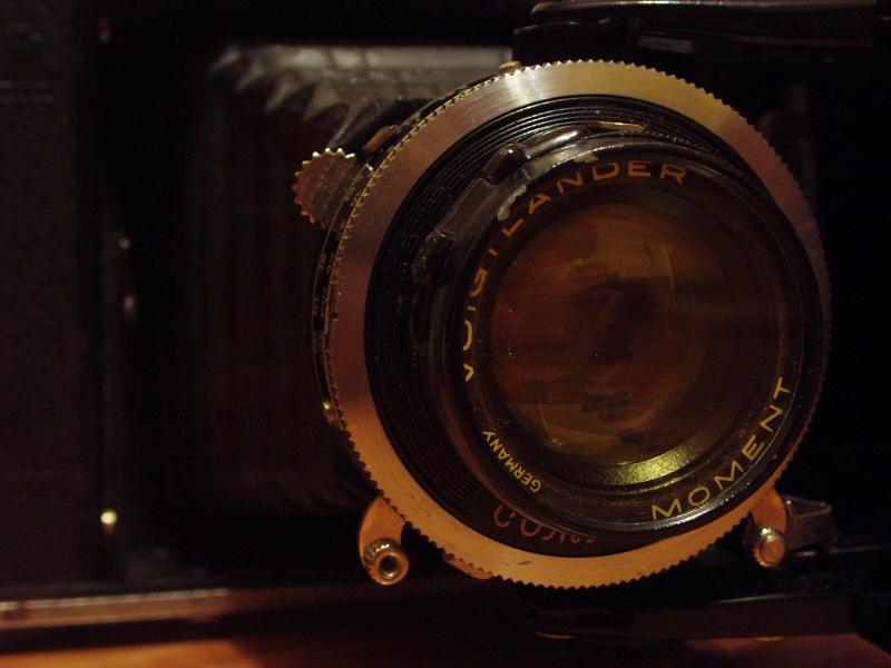

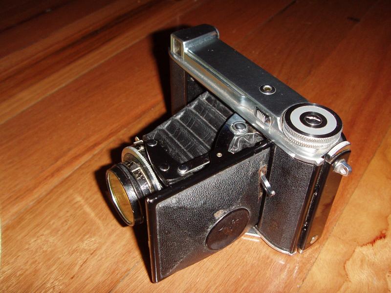

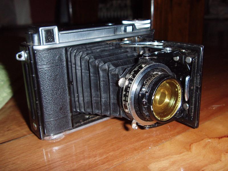

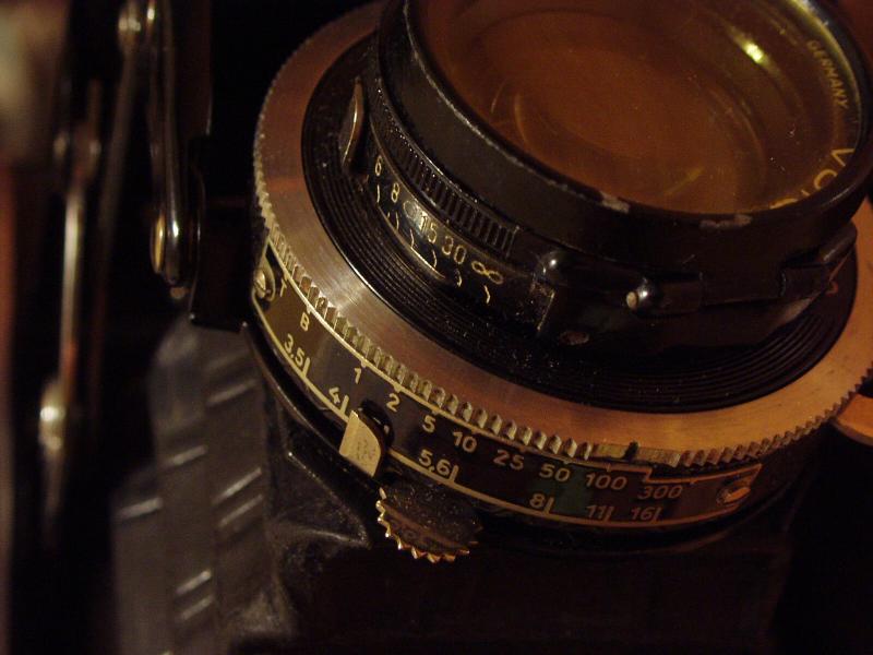

It has a yellow hinged lens over the front with "Voigtlander Moment" written on it. The main lens part has "Compur" on it. I will add some pics to assist.........oh, lookign through the lens as you've described....... it looks reasonably clean...... maybe a couple of small spots ..... its a little hard to tell.

That looks like a fine little camera!
The hinged yellow thing is a yellow filter, for use with BW film.
"Compur" is the shutter, those Compur shutters are very good and easy to repair if they're sluggish (or fast).
I can't tell what the lens is, somewhere it should say something like "Voigtländer Anastigmat "Voigtar" 75mm f:4.5" or something like that. Yes, I'm guessing - but that's what I have on my 4.5x6 Voigtländer Perkeo.

Welcome to the fantastic and non-plastic world of folding cameras. If you want to start with MF, they are a great way to go.
The first thing you want to do is to get a flashlight (torch) and take your camera into a darkroom (or just a plain old dark room will do fine too :wink: ) Anyway, shine the flashlight into the back of the bellows and in the dark, see if you can't spot any light shining through the bellows. IIRC, Voigtlanders have leather bellows so they *should* be okay but it's a good idea to check. Holes can be fixed with bits of electrical tape from the inside. Black nail polish works well too if it is basically liquid plastic with fillers and such. Wet N' WIld is a cheap brand here in the States that works well. Not sure what they have in Aus.
The compur shutter is probably slow. If you do a search on these forums you'll find that Rosonol is a good cleaner for them but if you are like me who doesn't want to disassemble it, you can just give it a few squirts. A professional CLA is reccomended but then, that will probably be at least $80 US if not more. To me, that's too much.

the lens name plate is located around the front of the lens, right under the "moment" yellow filter, but is missing from your camera, which is common in early Bessas since they were only weakly glued on. Since you have a compur shutter, and not a compur-rapid, the lens is likely either a tessar-type "skopar" or triplet "voigtar", 75 mm, f3.5 (heliars came in compur-rapids). If you are really interested, you can check the rear of the lens by opening up the camera back to see if it has a serial number, the voigtars weren't numbered pre-WW2, so if it's numbered, it's a skopar. All are good usable lenses.
This bessa also has a film counter built in, so you need to reset this using the levers on the top front and back before you load the film, and you only need to set the film to the first frame using the rear red window, and then the camera will take care of the rest. This process is a little tricky to get right, and a stuck shutter or linkage will give you problems, so best to practice first with a dummy roll of film in the camera. IIRC, the film winder (which also allows you to fire the shutter with the lever on front) only works with film in the camera. You also have to manually cock the shutter each time before you fire. I've seen many of these where the automatic features have been removed or disabled since they probably locked up at some point. They are easily fixed if needed. I have a Bessa 66 with a similar mechanism, so if you cant figure it out, drop me a post and I'll try to guide you through it.
These "baby" bessas are great cameras. I've used many of these, and shoot a lot of medium format using a Perkeo II and Perkeo E rangefinder, both of which have the advantage of coated lenses. I've made some nice 16x20" enlargements from these that are very sharp.

There is number (2286138) on the lens outer ring looking inside the camera.
