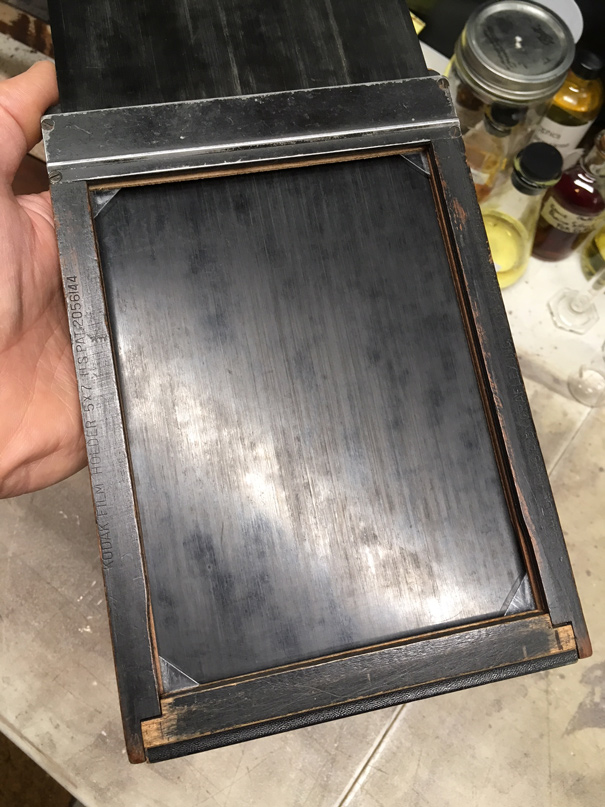

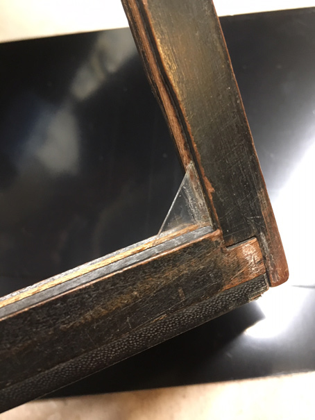

    Colin,
    As John has said, all you need to do is 1) replace the ground glass, and 2) acquire a wet plate holder for the camera. I recently acquired a 5X7 camera as well and all I had to do to use it for wet plate collodion work was to re-engineer one of the standard 5X7 film holders to accommodate wet plates. How did I do this? It was an older style film holder with two metal septums placed back to back inside the holder, so I simply took pliers and pulled out the septums. Then, I cut four clear plastic triangle pieces and glued them into the appropriate place in each of the four corners, creating corner pieces for the wet plate to rest on. I cut a small piece of plastic yogurt tub to make a 1" X 2" "spring" that is placed against the back of the wet plate (once its in the film holder) to hold it firmly in place when you close the film holder rear dark slide.
    All in all, its a very easy modification to do, and you don't need to modify the camera itself other than replacing the ground glass (which you can make yourself without too much effort, by the way)
    Paul

    I took the back off entirely. It's probably easier if I include a photograph of it as it now is.
