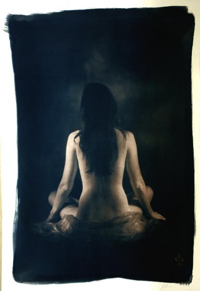

Peroxide does nothing to "fix" the image, it just speeds full oxidation (development). Air will do the same over several days. Cyanotypes aren't "fixed" because they are a product of oxidation (kinda like rust). Once fully oxidized (quickly by water and peroxide, slowly by water and air) they stop "developing". Your problem lies elsewhere.
One thing you can do is place one of your faded images back into water and peroxide and see if it develops back. If it doesn't return your prussian blue is bleaching to prussian white (from carbonate) or being washed away (phosphate) if it does return (re-develop prussian blue) your problem is in your chemicals or formula.
Once you get your process together you can use carbonate bleaching to advantage, like this:
