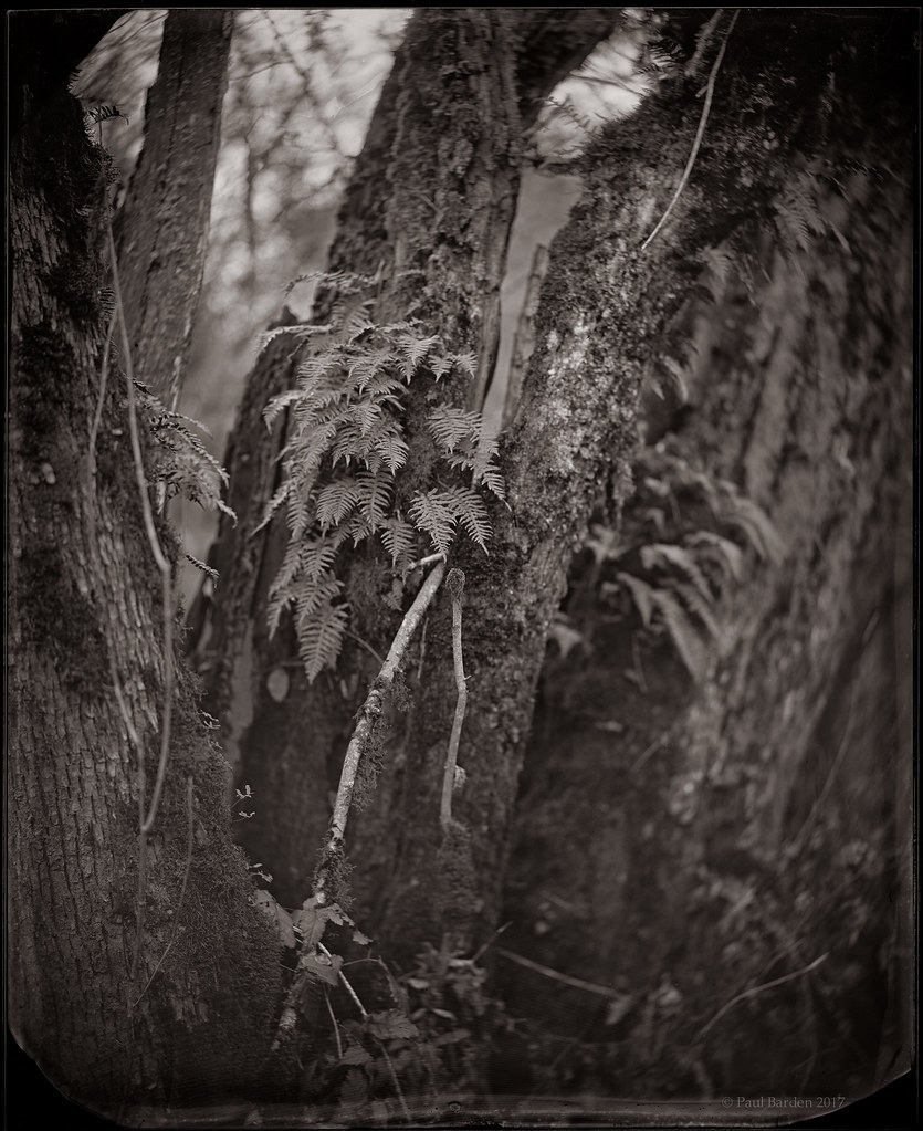

    A new wet plate collodion image made this afternoon, on 8x10 glass, with the Deardorff and 15” Lerebours et Secretan lens. Exposure was about 2:45 in the failing afternoon light. I find orthochromatic emulsions great for landscape work!

    Larger version here.

    wow ... this is beautiful paul,
    i can only imagine an almost 3min exposure
    and being nervous it would dry out and be useless !
    i find orthochromatic tones to be so much more pleaseing in every application :smile:

    Damn!!
    That's gorgeous!

    Thank you John
    Actually, on a cool day (48F) here in the PNW, I find I can easily take ten minutes from the time I pull the plate from the silver nitrate until I’m back in the darkroom to develop the plate. Which was useful yesterday, as it was a three minute (brisk) walk through the woods to this location, and another three minutes back. Add a minute of fiddling to check focus, insert the plate holder, wait for the camera to settle, etc., and I’m approaching the maximum time for the process. That’s actually part of the fun of it: testing how far from my darkroom I can wander to make a wet plate image.
    I’m a bit surprised to discover how much I’m liking red-blind materials! (But good luck recording sky/cloud details!)

    Paul you amaze me.. I am really glad you are making these wonderful negs, now I would like to see one on a grey background, this is the testing ground for good neg making.

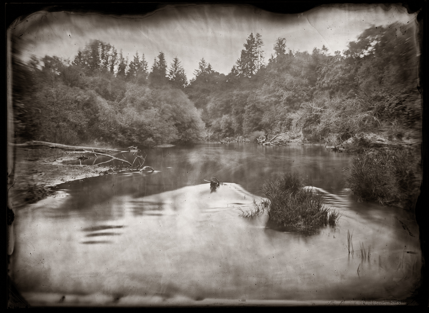

    Channeling Timothy O'Sullivan today, it seems.
    Its funny how some days the Wet Plate chemistry behaves flawlessly (the previous two forest negatives, for example) and some days its a dog's breakfast. This plate is very much the latter! (But I like its heavy-handed artifacts)
    This is my first wet plate negative shot in the Marys River - the south beach view from the grass island. Today was the first opportunity to actually get to this location, as the river was finally low enough to get to the spot. I hope to do many more of these river shots. Finally, I feel like I have at my disposal a medium that truly renders these views as I see them in my mind's eye.
    5X7 collodion on glass, old Seneca view camera with 1920s 5.5" Kodak f4.5 Anastigmat. 2 minutes exposure at f16. Lots of tripod shake because the legs vibrated with the river flow. riverview.glass.neg.01a.jpg riverview.glass.neg.01a.jpg

    I like your clean Plates Paul.. The area you live in is amazing . This last plate looks like areas in north eastern Ontario near Renfrew.

    Thanks Bob.
    Yeah, these "dirty" plates don't always work, but I'm OK with how this one looks. The farm here is a beautiful place, to be sure. We are surrounded on 3 sides by the Marys River and its a lot like living in a private wooded park, with pebble beaches in multiple locations. Quite a nice place to be, actually!
    I would say the big difference between rivers in our area, and Ontario is that the wooded areas are full of rank-growing Dogwoods, Ash and (ugh) Himalayan Blackberry - an introduced invasive. The undercanopy of the woods here are typically a chaotic mess of collapsing competitors that make for a tangle of green junk. Its hard to describe just how messy the wooded areas are.

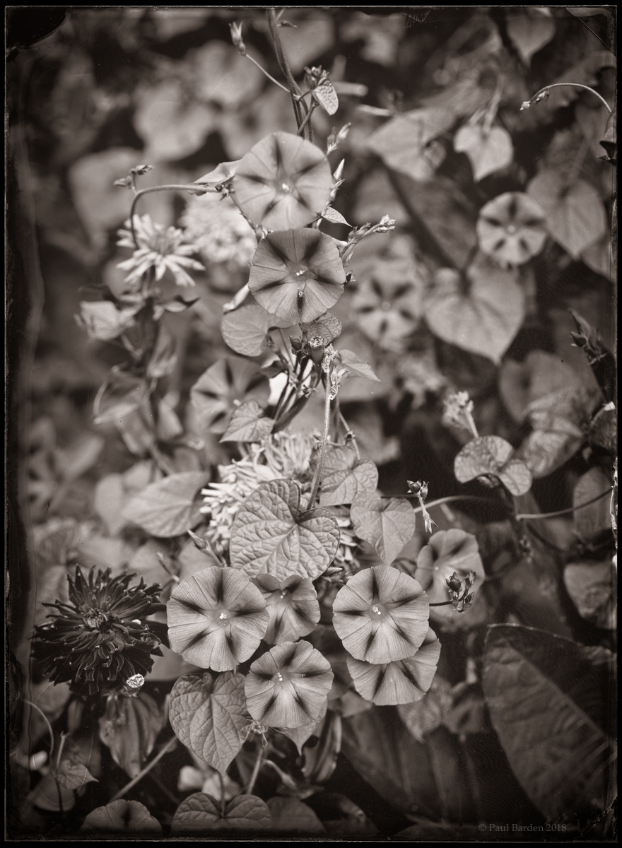

    Morning Glories in this morning's garden.
    5X7 inch wet plate negative on glass. Lens used was my 203mm Kodak Ektar at f11, exposure was 27 seconds.
