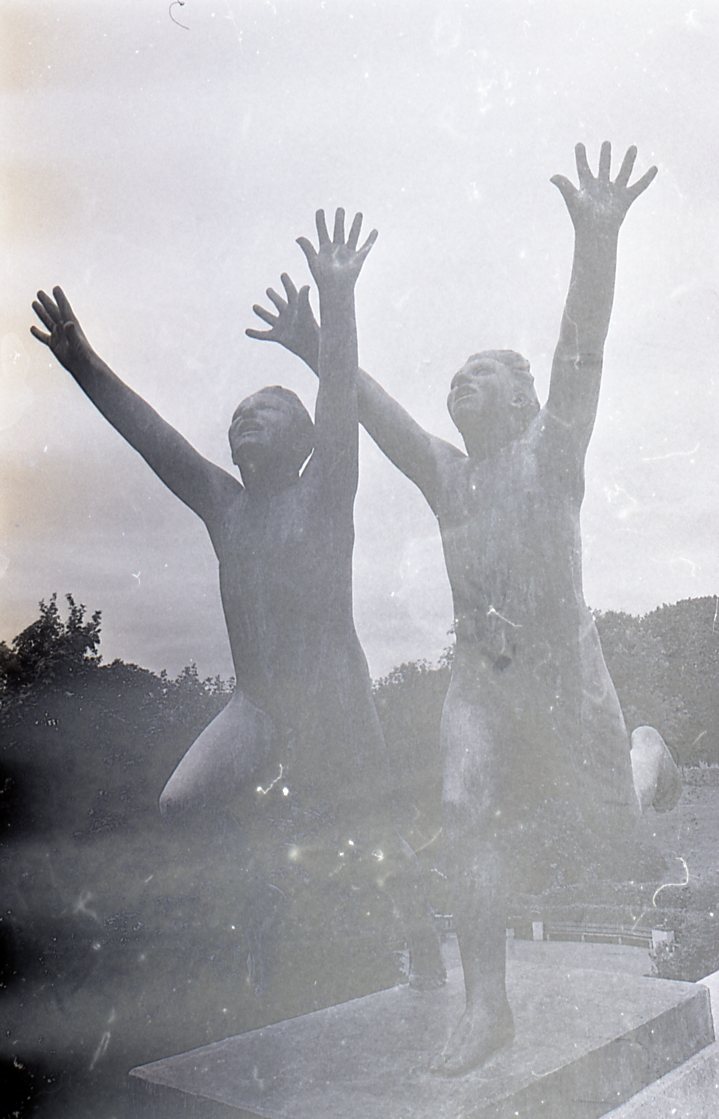

Hey all,
just came back from a weekend in Oslo and eagerly went on to develop 2 films (Legacy 400, which apparently is rebranded Neopan 400, in D76) last night.
It was the first time i used D76, but had already succesfully used ID-11.
The result is absolutely unusable. Looks like either there has been some sort of light leek or the developer (or fixer?) didn't spread evenly.
To be fair, it was only the second time i developed two films at once (in a paterson tank and with paterson plastic reels), and it hasn't been first time lucky when i first did, either, as the same effect came out (even if at a much lesser degree) here and there on the border of the films.

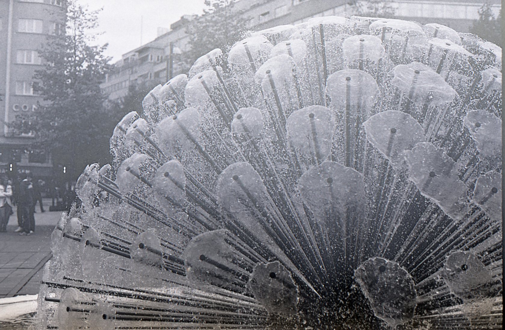

I was also disappointed to see that, apart from the obvious problem, the grain came out massive, as well, which never happened with ID11 (nowhere near as big with Rodinal either). I used the developer at full strenght, using 650ml for the two films together.
Attached is a scan for you to see what I'm about, the first showing the obvious light leek effect, the second the horrible grain.
So, has anyone a clue about what could have gone wrong?

The first looks like too much agitation in the developer, resulting in over-development around the sprocket holes. I'm not sure the excessive grain might just be from scanning and a result of over-agitation.

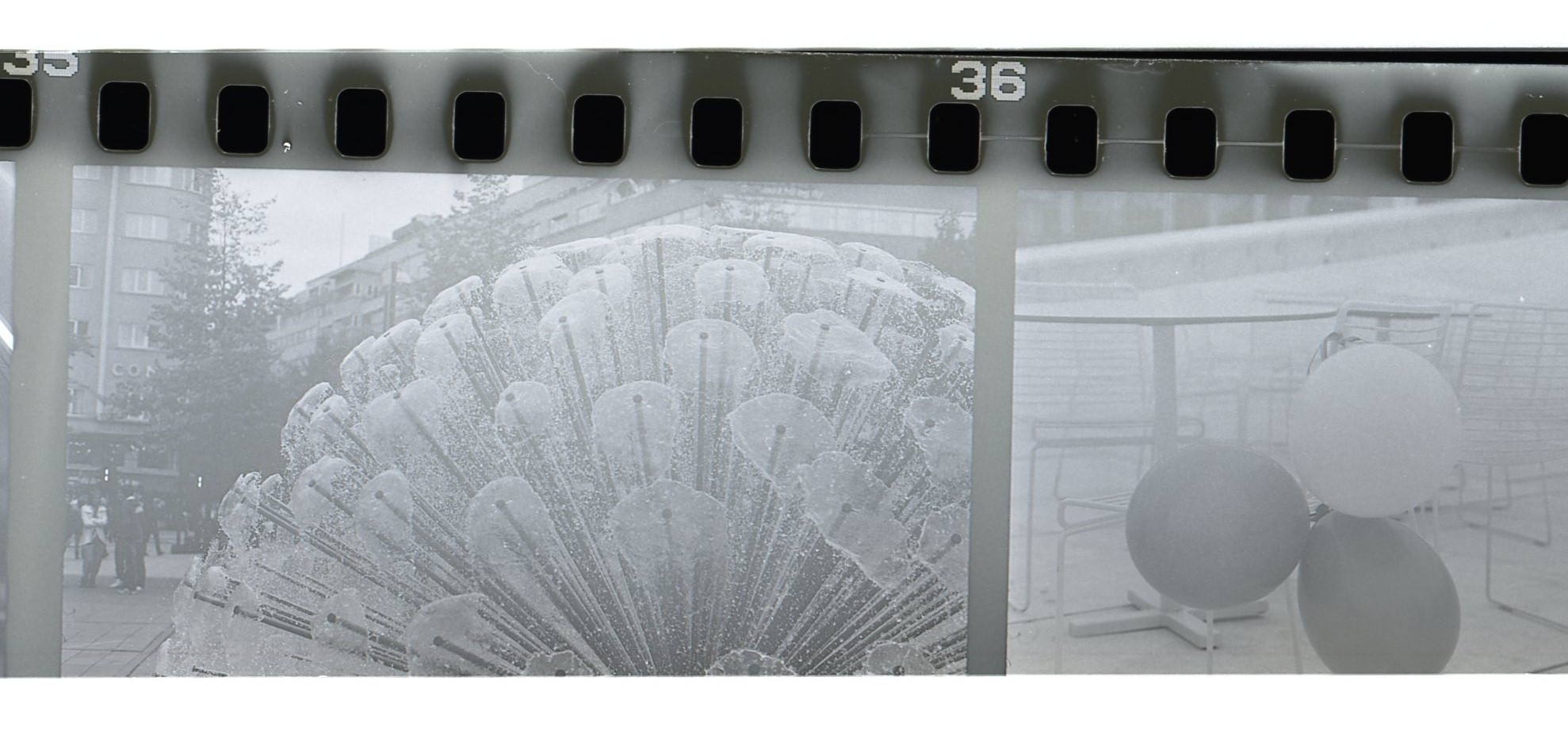

got some scans with sprocket holes, and i guess they prove your theories.
guess next time i'll use d76 i'll stick with the times/agitation routine i did with id11, never had a problem with it.

Have you checked the sprockets for deformation? Film fogs when bent or stressed in any way. For instance if you re-wind backwards (opposite the arrow direction, you will get similar marks.
Uneven development can also be caused by too little or too vigorous agitation, even films touching in the spiral.

Are you really sure the negs are fixed properly? Looks like some sort of fog to me, which may indicate not fixing enough/bad fixer.
Dec 10, 2009
6,297
I agree about the fix. Looks like the film hasn't cleared yet.

It seems to me that if the OP had success with ID 11 then we can pretty well rule out processing/agitation problems as D76 is much the same developer.
We are short of all the info we need for a full diagnosis but it looks as if using fresh fixer is worthwhile. It looks like the classic milkiness of exhausted fixer.

If fixing is the problem, re-fixing will cure it as long as the film isn't exposed to too much light and allowed to print-out. Time is of the essence here and it's something you should definitely do in this case.
I think your problem was insufficient fixing making the sprocket holes visible - note that there is not increased contrast (overdevelopment) coming from the sprocket holes, there is a lack of fog radiating from the sprocket holes. That means you didn't fix for long enough but (due to the fluid flow during fix agitation) the bits near the sprocket holes are not as poorly fixed.
To determine your fixing time, put a bit of exposed, undeveloped film leader in fresh fixer and time how long it takes to completely clear. The required fixing time is double that time. If you perform this test, you might find that your fixer concentrat has gone off (e.g. oxidised) in its empty bottle, making it slower than you expected even though you mixed up a "fresh" working solution.
You say the next film was stained. Staining (brown is what I've seen) can be visible when you have slightly- but not grossly-insufficient fixing. Refixing should cure it.
What is your fixing agitation scheme? For small tanks, I use continuous for 1 minute then 5s every 30s for the remaining time. One inversion* should take about half a second and you should invert about once per second.

Either x ray fog or incomplete fix. That is the overall effect.
The black around the sprocket holes is a light leak so there are two problems.

Ronald,
I think the "black" around the sprocket holes might be the film base, which may seem black and lightleaked in relation to the incomplete fixing.

Always do a clearing time test with the particular film and particular fixer in question. It's so easy with 35mm film and you can do it simultaneously when fixing, that there's no reason to skip it:
1) Pour out a bit of the same fixer -- I use the cap from the fixer bottle to pour it in
2) Cut a piece of film you are developing. With 35mm this is easy, you have the leader piece left you cut away first before putting films to reels.
3) Submerge it partially in the fixer. Agitate at the same times you agitate the tank.
4) Look at it every now and then, you can try to look at some text etc through it to see if it's cleared.
5) When it is cleared, nicely and fully transparent, look at the clock. Clearing time is usually around 1-3 minutes. Double or triple this time, and it will be the total fixing time for the film.
6) When the clearing time has doubled since the very first fixing with that fixer, it is time to make a new fixer.
When you do this test, you'll see straight away if there is any problems in clearing or if it takes too much time. If that happens, make a new fresh fixer and try again.
