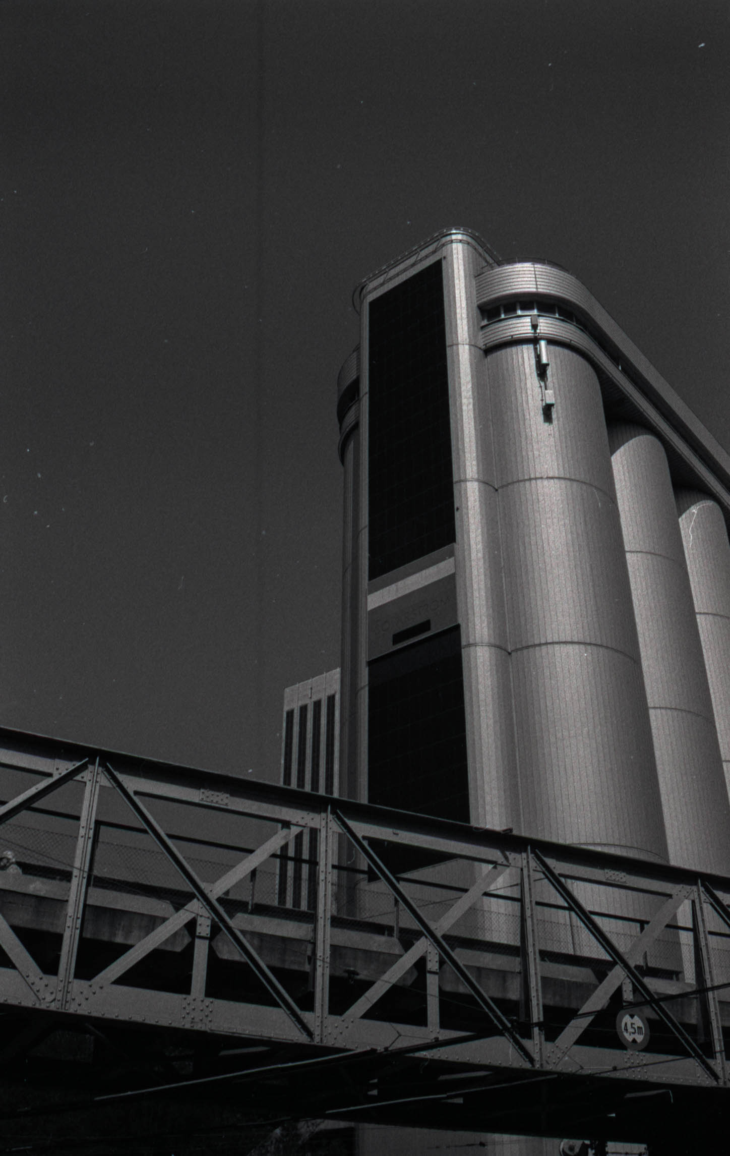

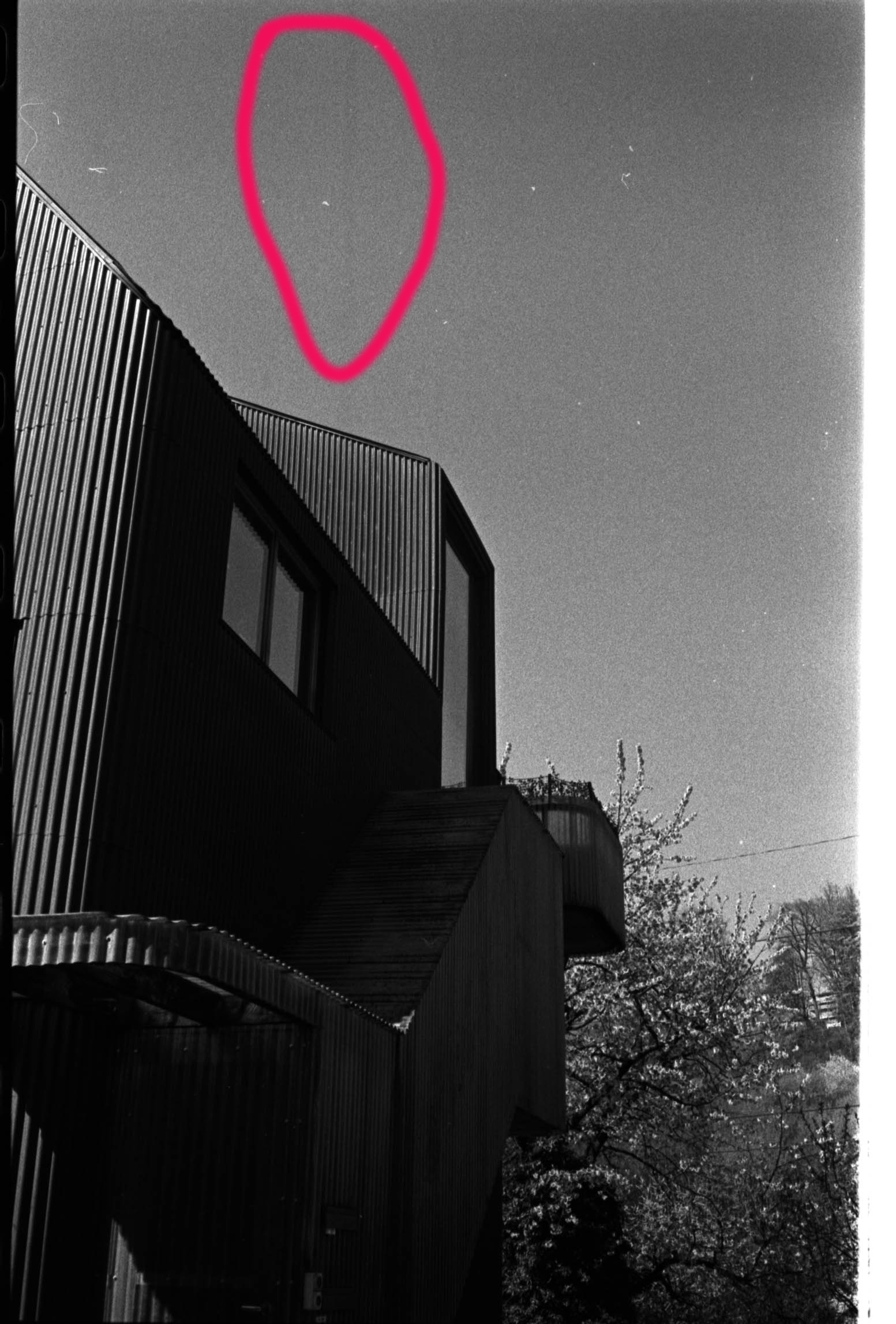

I just startet developing Kodak Tri-X 400 and i have so many Spots on the Image that its almost impossible to retouch. Also i feel that the light in the sky is not even.
Plus in every image i have a black stripe going thru the picture. This darker stripe apears also in the negative.
The film is shot at boxspeed.
I do a prewet for 5min, Rodinal for 7min, Stopbath with just Water, Kodak T-Max Fixer for 4min, Wash for 5min, Photoflo for 30sec.
After the negative is dryed i also have a lot of wet marks on the negative.
Having a pretty ruff start to developing black and white.

Hi DJ, I think there are three sources of the spots:
1. Tiny bubbles on the film during development. Try thumping the film can on the counter to dislodge bubble when you start the pre-wash and the developer phases. These may be the perfectly round and white spots.
2. Flecks of dirt or crud in your water. Use fresh distilled water for all chemicals. These may be the irregular flecks.
3. Dust that settles on the wet film when drying. More irregular flecks. Use a clean bag or drying cabinet. Most homes are full of lint, dust, crud, hair, pollen, dandruff, and more.
The dark line: were these examples all vertical format compositions from a focal plane camera (as opposed to leaf shutter)? If so, then the line may be from the focal plane curtains not sealing properly before after exposure.
Good luck. We all go through this type of stuff occasionally.

Thanks for the good reply.
1. I do thump the can on the counter after every step cause i know of the bubbles. usualy i tap it like three times before putting down.
2. Yeah i mixed my chemicals with tap water. We have really clean water in switzerland so i was thinking i can use that. but for the rince tap water would be fine yes?
3. i will try my bathroom nexttime. dont have the space for a cabinet.
Yes they are all verticals from my new Leica M6 that i got from a guy two weeks a go. From the outside the cam looks new and he said he almost never used it.
What he said, also the black line can be from a squeegee blade and you may have some precipitation forming in your fix which causes silver crystals to adhere to the film and is well nigh impossible to remove. Is it fresh or do you share chems with anyone else ?
Yeah i do use a squeege before i hang my negatives.

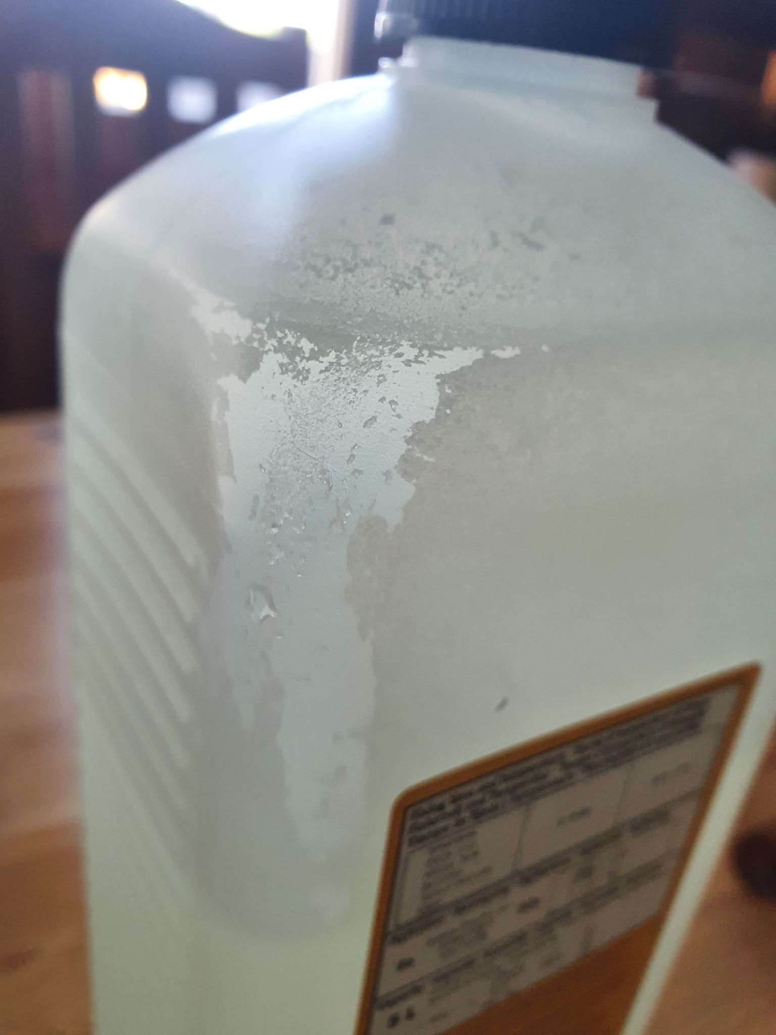

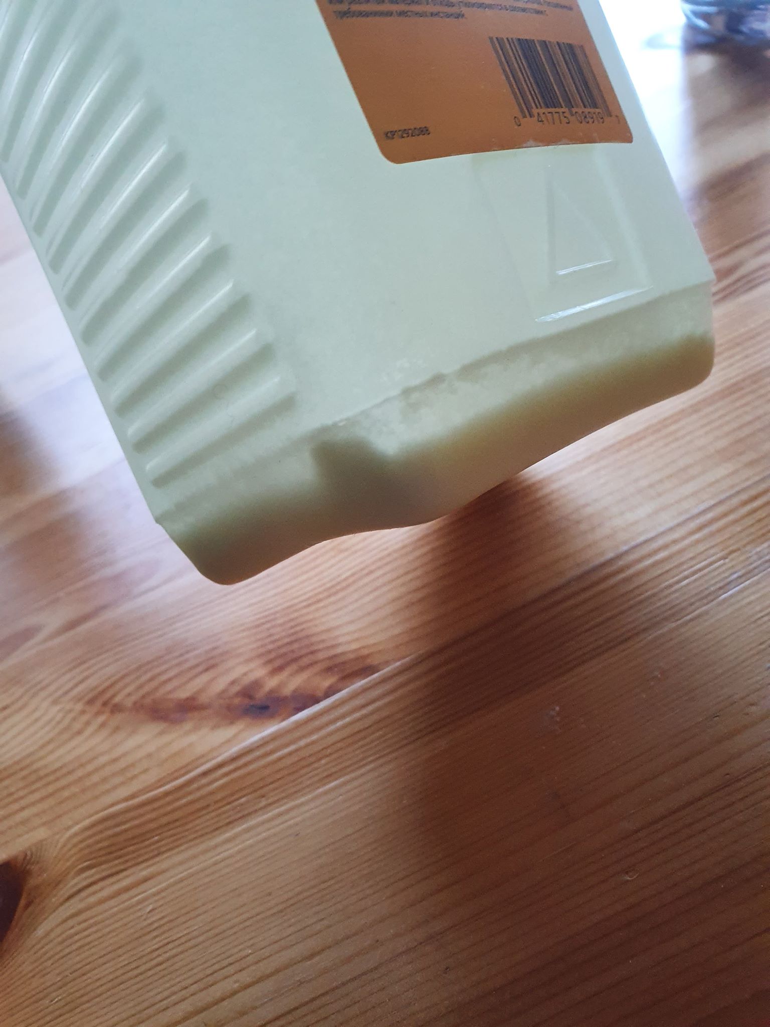

i bought the fixer 1 month ago and i just open the bottle. i just noticed that the liquid inside is not very clean and theres also stuff on the botom. the bottle expires in one month.

White spots/specks: dust/crud on your film. Usual causes (I repeat some of the tings already said above):
* Dust settling onto film as it dries
* Dirt in wash water
* Specks of metallic silver in fixer becoming embedded into emulsion (filter fixer before re-use or mix fresh)
* Dust on film or scanner platen during digitization
Dark band:
* Usually associated with a scanner issue; e.g. on a flatbed scanner, contamination of the calibration area, or on the strip light source or sensor.
* Fluid dynamics during rotary processing; i.e. laminar flow instead of turbulent flow. Change rotation speed, tap tank to dislodge air bubbles.
* Film manufacturing defect (rare, but it happens)
It's not a squeegee band; those generally show up as sharp lines, somewhat wavy, and white instead of black on the positive.
Check the film itself to see if it is in fact an area of reduced density. If it's not visible on the film itself, it's a scanning artefact.
BTW: your film looks underexposed and possibly also underdeveloped judging by these scans.

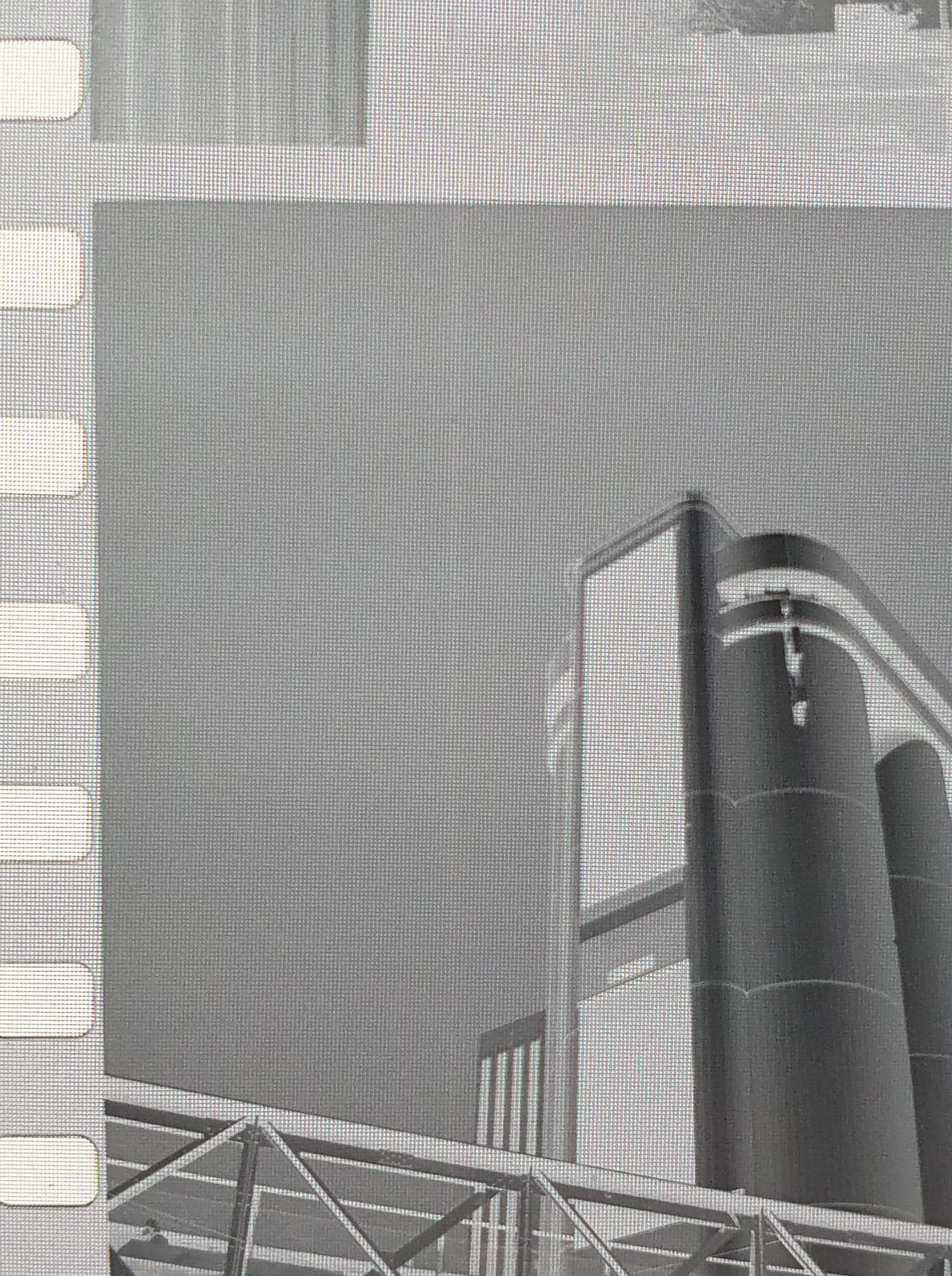

I see this line allready in the negatiive so it cant be the scaner.
this line appears in all 3 differnt films i used. Portra, Hp5 and tri-x

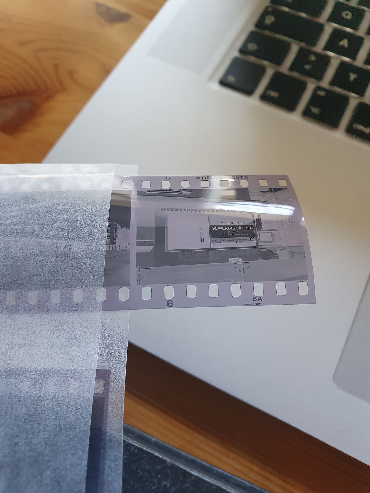

for development i used the times on massive dev chart that states 7min development with a dilution of 1+25
in the picture you see how the negative looks

The negative looks rather thin, mostly due to underexposure. Then again, exposure is also a bit of a matter of taste, but personally, I like a bit (much) more shadow detail. Development looks OK.
Do you use a jobo/rotation processor? I've had a similar dark/low density band show up on some films as well when using one. It went away when I (1) developed the old-fashioned manual way using a paterson tank and (2) when I used a different developer (I got the problem with Pyrocat but it didn't manifest itself with XTOL for some odd reason). It's an elusive issue and I thought it was a film manufacturing defect until I had the same problem emerge with an entirely different film stock. Oddly the dark band was always in exactly the same place, suggesting it's associated with the fluid dynamics and the shape of the development reels.
Sounds like you found the culprit then. Ditch the exhausted fixer and replace with fresh in a pristine bottle. Just finish off with a final rinse in Photoflow after washing, NO SQUEEGEE, and vigorously shake the drips off before removing from the reel to hang up in a dust free environment (I use a shower cubicle). FWIW, look into using the Ilford washing method. Quick and very effective. Good luck.

No i do it with the patterson tank by hand. so when the negative looks thin i should develop it for longer?

Thin negatives can point towards insufficient exposure or insufficient development, or both. Going by the photograph in post #7, I would say that development is OK, but the images are underexposed.
This, of course, is not related to the problem with the dark band.
I have the Problem with the Stripe with color and black and white. the really messy picture just with black and white.
The messy problems with B&W combined with the very messy/sulfured-out fixer concentrate implies that it's worthwhile trying some fresh fixer first.
The dark band is a challenging problem. It doesn't look like squeegee damage to me; as I said before, squeegees tend to leave sharply defined scratches on the film that show up as white lines, usually not perfectly straight, on scans and prints. This is a softer, perfectly straight band that shows up as dark on the positive.

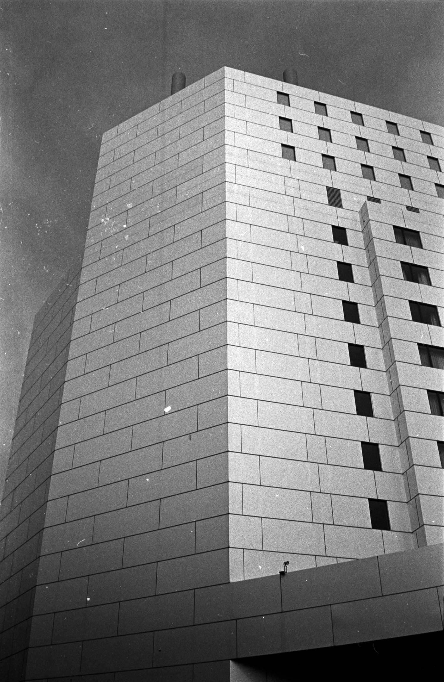

Ok guys. the cam is back from the cla. the guy said that the lightmeter was extremly off and it underexposed by a lot. they couldnt film test the cam but they pollished the inside and that should get rid of any streaks.
Meanwhile i filtered the fixer. used just one drop of photoflo at the end and stopped using the squeege.
the new result got rid of all the nasty stuff on the negative but the STREAK IS STILL THERE.
The streak has in my opinion two possible causes (out of a wider range of more improbable ones):
1. A a development-related issue
2. A scanning-related issue
You indicated before that #2 is ruled out because the streak is also visible in the negatives themselves; could you perhaps photograph an affected negative on a light box (or against a bright window) showing the defect in the film?
As to #1: how do you develop this film exactly? You gave some process specifications, but perhaps you can tell a bit more about equipment used etc. Some more details may help.
This is a very challenging one to troubleshoot however.
