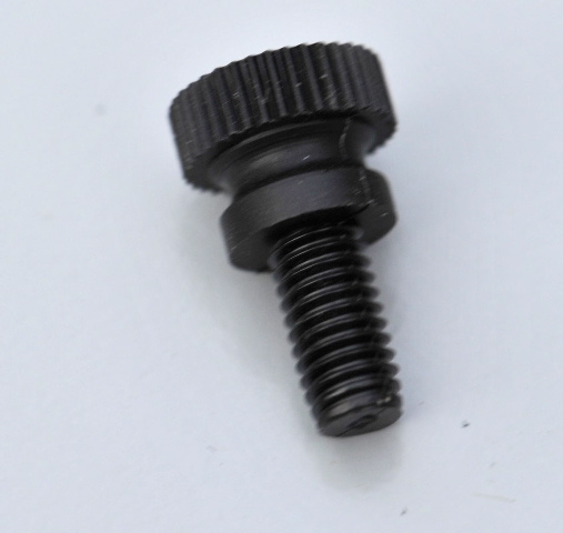

Hello,
i'm a French photographer using a 16x20 Beseler 4 bladed easel.
I've lost one of the Thumbscrew that blocked the blade.
Do you know where i can find some?
i've already tried Beseler Co, but i got no answer??
If you can help me
I pu a picture as well
Thank's for help
Karim

Are you in the U.S.? If so, you should be able to get something similar, or perhaps useable from a good hardware store.
If you're in Europe (or about anywhere else except for the US), it probably has English threads, so you will need a hardware store that carries non-metric fasteners.
FWIW, the last time I contacted them, I found Beseler to be very responsive. Try calling them.

Karim,
If it's plastic it's probably a #10-24 or a 1/4-20 (US thread) thumbscrew.
If it's metal it could be a #10-32 or 1/4-20 thread.
Here are some details:
http://www.mcmaster.com/#thumb-screws/=7kvwou
Unfortunately, McMaster doesn't ship outside of the U.S., but with this information you can specify what you need.
