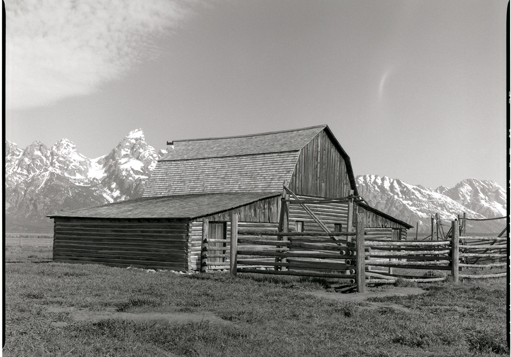

    I have a shot I like of the Moulton Barn in the Grand Tetons. But I was an idiot and managed to put a small crease in the film when I put it on the reel to develop it. Yeah, of course, it's right in the sky and there aren't any clouds near it (and the sky could be nicer with a few more clouds, too). I've tried searching for a good explanation of how to put a different sky in the print, but I haven't found one. Anyone have some good pointers? Or other ways to cover up my goof? Yeah, I can fix it the other way, but I figure this is something I should try to learn.

    And here's the image. I know it isn't the best, but it was a good trip and a nice memory. So I'd like to make a decent print.

    Honestly I'd try correcting it via judicious blending with spotting ink

    On the negative or on the print? It's 120 Acros, if that matters at all.

    I'd try the print. You can do over more easily if you screw up.

    You need to make a mask. Easiest would be to make a print then cut it out. Do your base print with the barn, then place the mask using the red filter on the enlarger. Change to a different negative with a sky you want, preferably a darker one which will print through what you already have. You could mask out the sky in your first exposure for the barn leaving nothing printed. That would be the best bet. Blending the horizon could be an issue which makes it difficult to do well. Keep the masks moving, just like when you dodge.
    The sky will need to be taken from the same angle to the sun and the ground at the same time of day with the same lens, otherwise it will look strange.
    Hope that helps!

    Yup! Thanks! I think I'll try this on RC first - I'm guessing this will take me a few tries. I need to find a good sky frame first, too.

    You could flip that sky and put clouds on both sides.

    That's quite a challenging retouching job. I'd be inclined to rotate the print easel anti-clockwise to correct the verticals and crop quite tight at the top.
    I'm assuming that.s a kink in the negative causing the crescent shape on in the sky top right.

    I'm with Ian Grant, a bit of judicious cropping may be in order. You can try localized bleaching and retouching the print, practice first. If your plan is to print on FB, cut a sheet into smaller squares and place them just at the bad area of the enlargement and expose a few of them. Mark your easel where they will need to be placed to capture it.

    bethe i'd leave it and weave it into the story about the image.
    maybe its just me, but i kind of like how it looks like wispy clouds ..
    and gives the image something no one's will have, some sort of random occurrence ..

    Sandwich a shot of the moon on another negative and position it over the crease. :smile:
