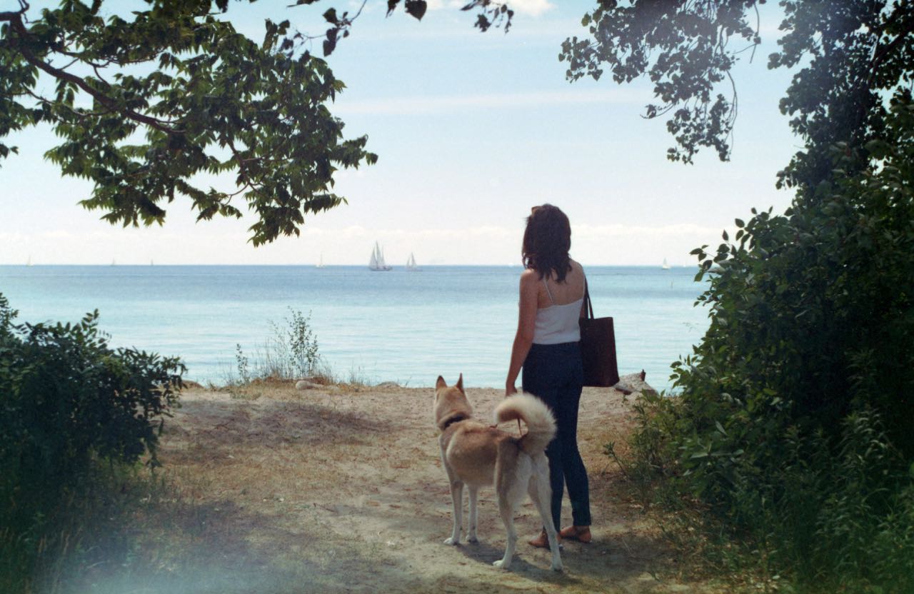

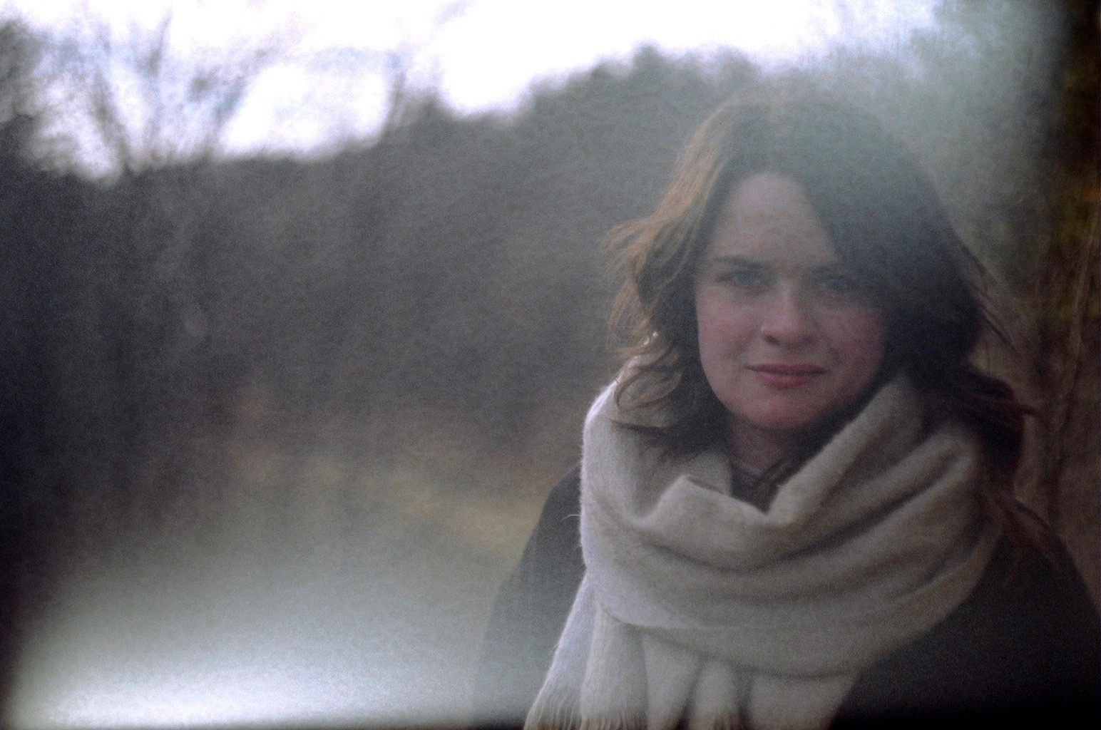

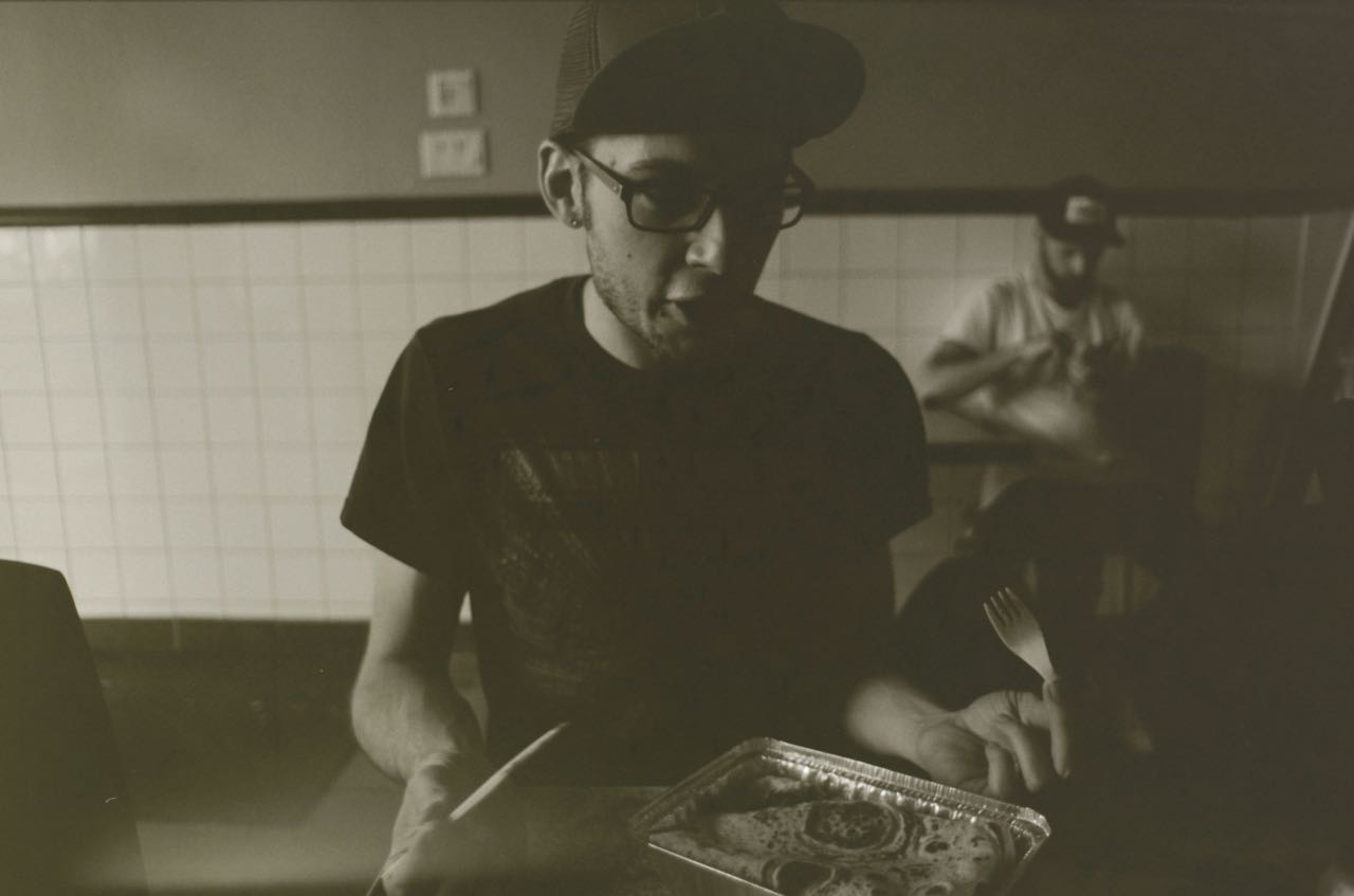

Hi all,
I'm having a problem with my Yashica body where whenever the light source (even a diffused one) is in in front of me, I get these hazy areas at the bottom and/or top of the frame. It happens whether I'm using my 50mm/2 ML lens or my 28mm/2.8 YUS lens.
The closest thing that I've found resembling this problem is the mirror box reflection issue that some Nikon D750s have, which is caused by reflections off the AF sensor assembly - But the inside of the Yashica's mirror box looks perfectly matte when the mirror is up.
Has anyone seen anything like this?
(The portrait of the lady has other defects caused by a bad development, but the haze is its own issue)

My best guess at this point is that it's either a light leak through the shutter (which I've tested-for extensively, and it doesn't seem to be that), or that something is happening with the mirror, and light bounces toward the film plane between the mirror and focusing screen.
I suspect that a lens hood will help, but I've never needed a lens hood in conditions like these before...

I thought so too for a while Matt - this camera had several light leaks, and I've been mostly successful in chasing them down. With these defects though, they are isolated to the frame--never appearing around the sprockets or across frames--and the only place where I can imagine this pattern happening is through the shutter...

With a white flare like that on color film, the light has to be entering from the front of the camera.

Ah, good point! And makes me think of something I hadn't considered - The leatherette covering had turned into a sticky goo, so I had peeled it off, which uncovered some holes in the front of the body. I bet that light was getting in from those holes through the mirror hinge area. I've just recovered the camera with leather, so fingers crossed this next roll will be defect free.

I assumed so too, but there is definitely some sort of opening for the mirror hinge that I can seen into. I'll post an update when I develop this next roll

I peeled-back a piece of the leather and shone a light on the body in a dark room-result: I can see light through the mirror box.
Looks like case-closed :smile:
