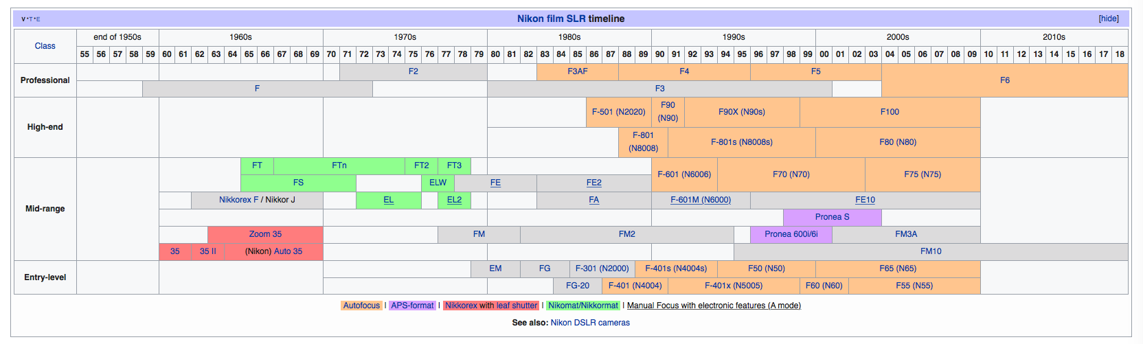

You can replace the N90, or look at any of the AF cameras to the right on this graph for an upgraded replacement. Most are in the $25 to $100 range these days. If you want to stick to a more 'pro' type camera, there has been a lot of interest in the N80 here lately. Otherwise the N75 is a little newer design that is lighter and smaller (if you like lighter and smaller). Also, this might be a good opportunity to move up the the F100 while they are still very affordable compared to the F6.

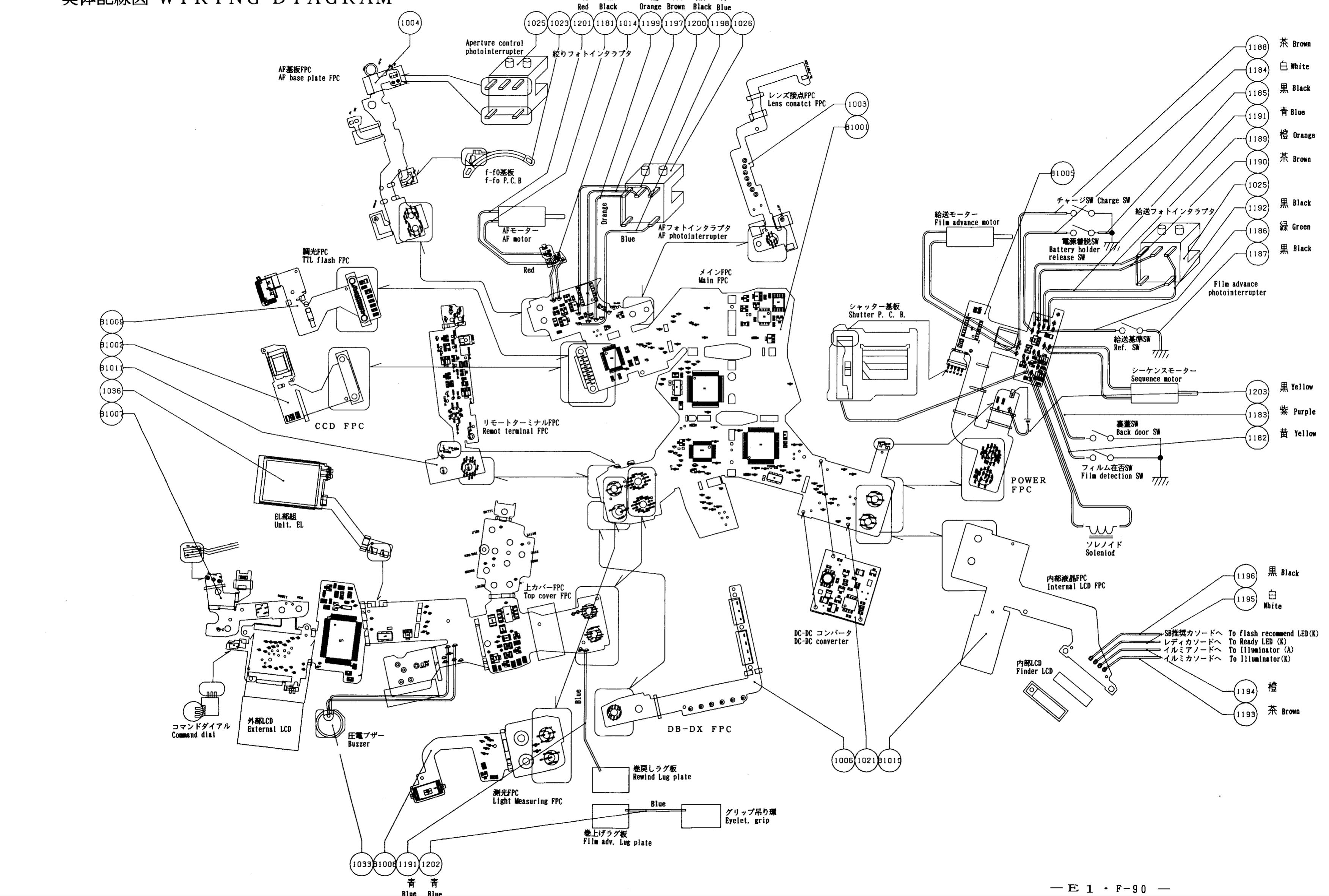

For an electrical problem in that camera, one could open it and trace the appropriate connections, looking for a bad solder joint or loose connection. If a electrical component is bad, a donor camera would be needed. Likely then, easier to just use donor camera. I was able to repair my N55 by searching for a bad solder connection.
N90 layout:
