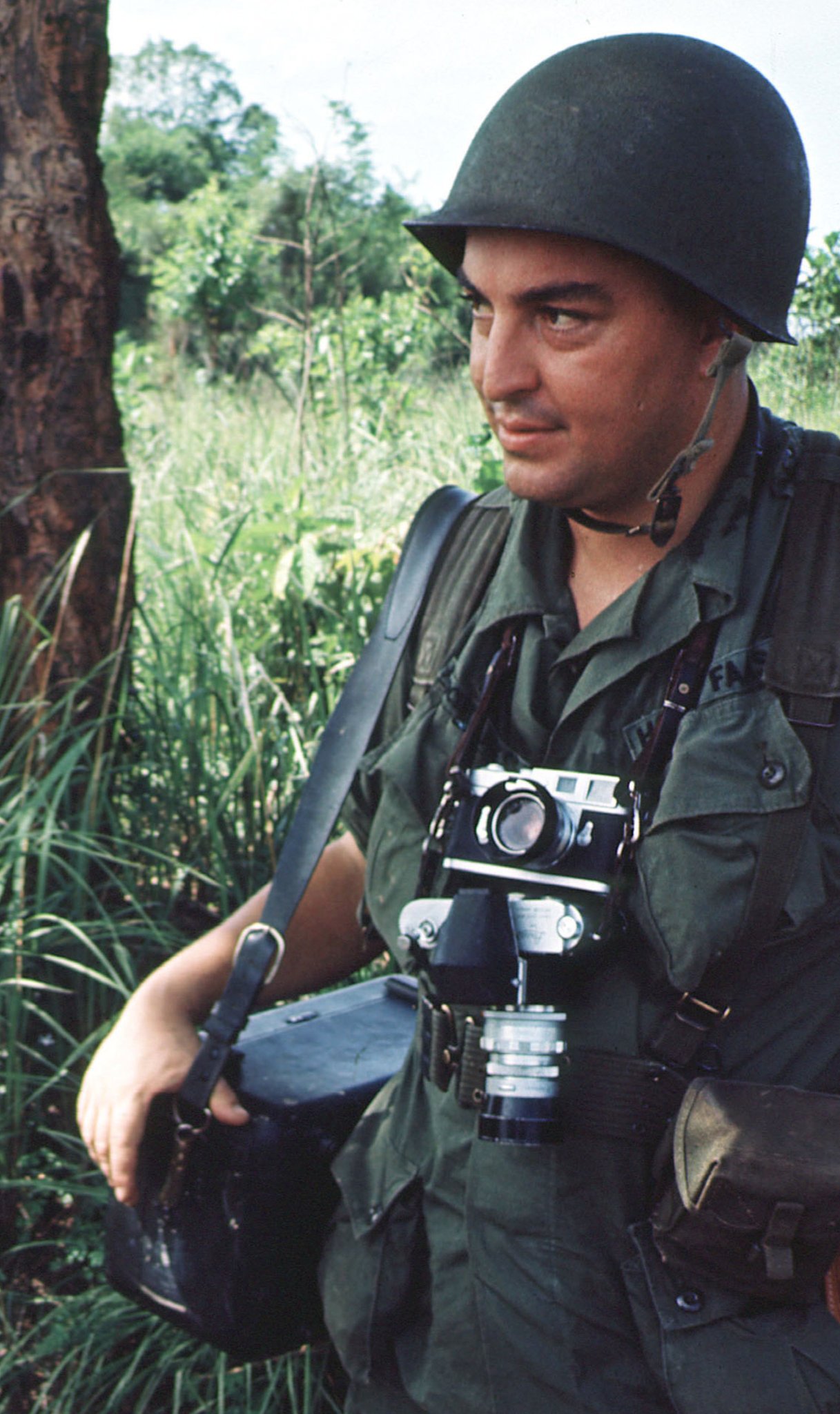

Howdy, APUG! I came across another old photo that caught my eye, and not only the photo, but also the third camera that this war photographer is hanging around his neck. The first two are obviously Leicas, but the third... is that an ICAREX 35?
If not, what do you all think it might be?
If yes, what cool lens do you think is mounted to it?

Definitely no Icarex 35.
But a Contarex Super.
(there has been a version with this blank focusing wheel)
EDIT:
"scale selector" wheel

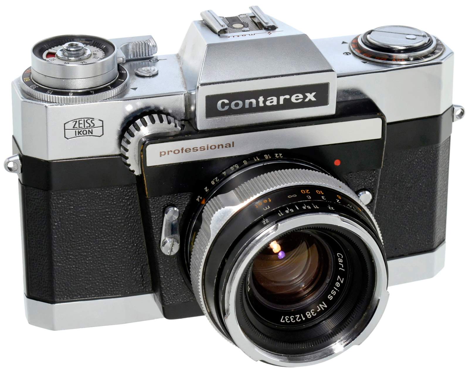

That's the legendary Horst Faas, pictured in Vietnam. According to a post on the Facebook page of his estate (https://www.facebook.com/pg/The-Horst-Faas-Estate-380358032082656/posts/?ref=page_internal) it's actually a Contarex Professional (which is quite a rare bird). Nice to see he was loyal to his German camera brands!
AgX
Apr 5, 2007
29,973
Germany
But on the photo you see a patch between the prism and the rewind.
The model Super has there a meter window, which may have been the cause for the different reflection.
The model Professional though has a plain top cover at that place and thus does not fit the photo.
From the model Super versions existed with blank scale selector wheel and lacking a black logo at their right hand side, thus in all these points fitting the photo.
AgX
Apr 5, 2007
29,973
Germany
I would not have thought that that a war photographer used a Visoflex.
AgX
Apr 5, 2007
29,973
Germany
What cool lens do you think is mounted to it?
Most likely a high speed 50, 55 or 58mm Planar .
(Though I see some blank/dark pattern that does not fit, but the shape fits perfectly.)

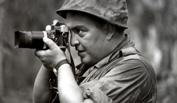

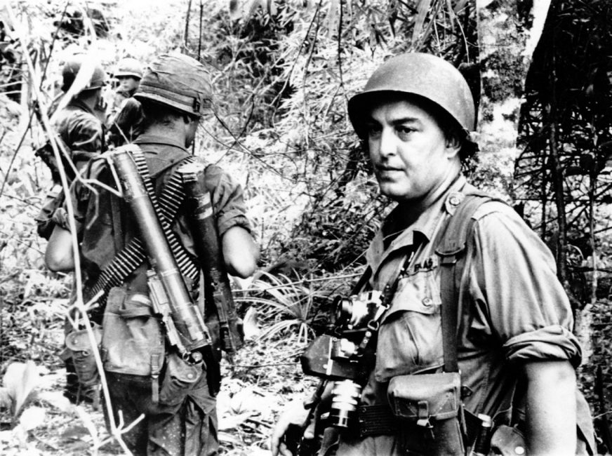

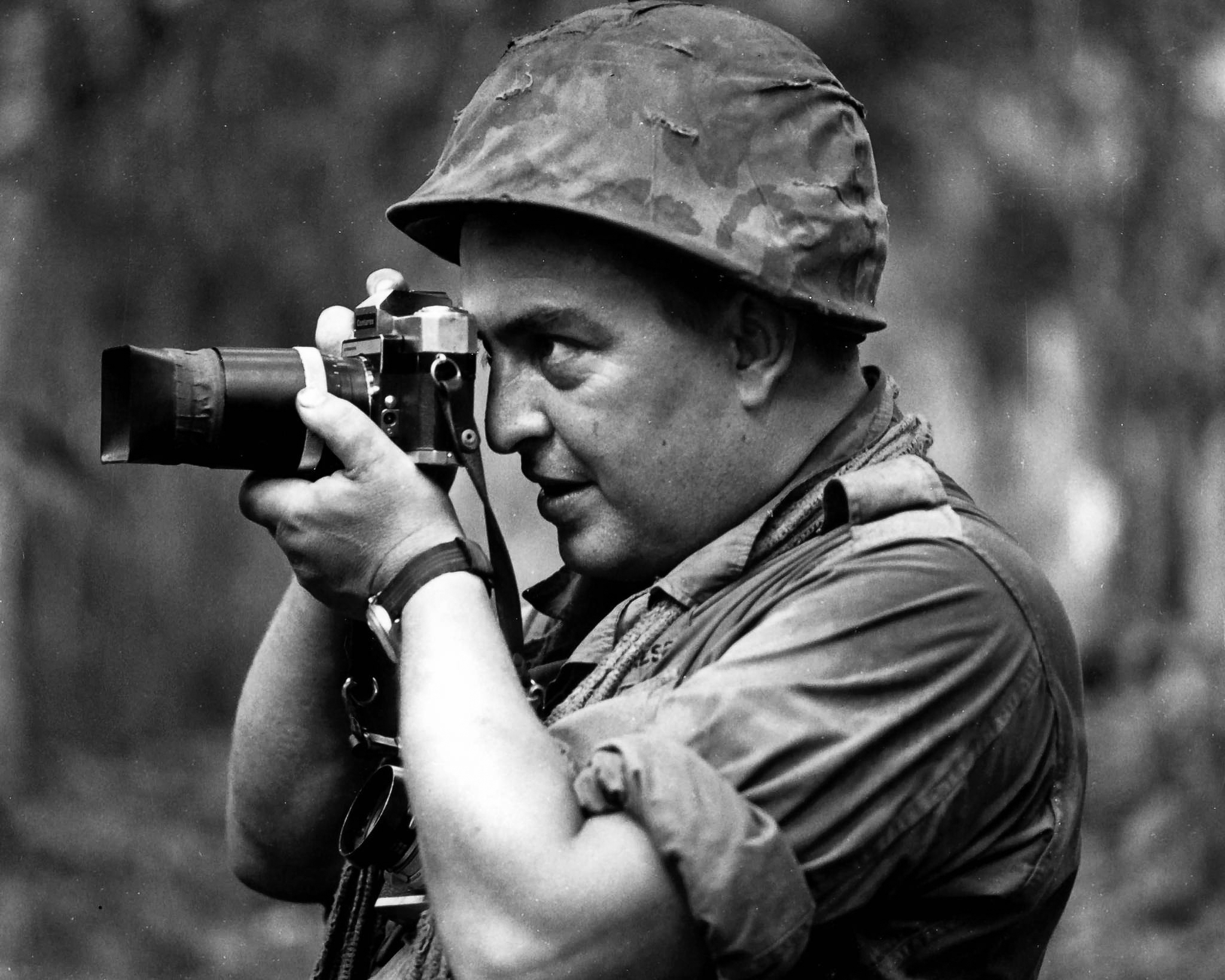

Have a look at this image. The camera he's holding lacks the Super's meter switch on the rewind side of the mirror box and has the lower profile rewind crank of the Professional. Also, although one can't read the model name, it looks to me to be a longer word than "Super" - nearer 12 characters than 5 (and no, the camera looks nothing like the Super Electronic) :smile: I think this is a Contarex Professional - although of course it's entirely possible that Herr Faas owned both a Super and a Professional.
