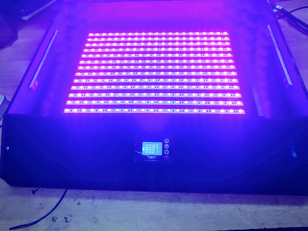

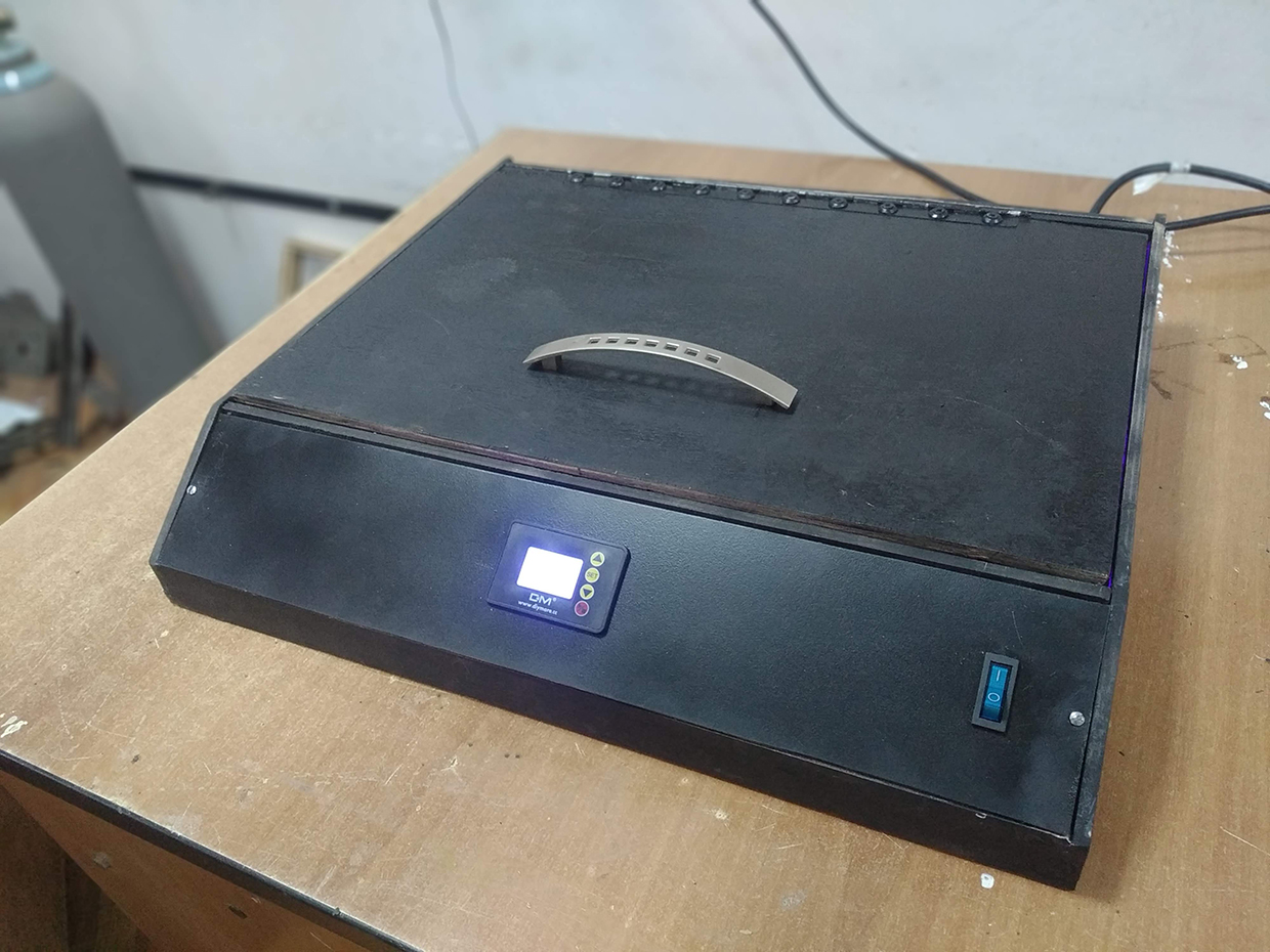

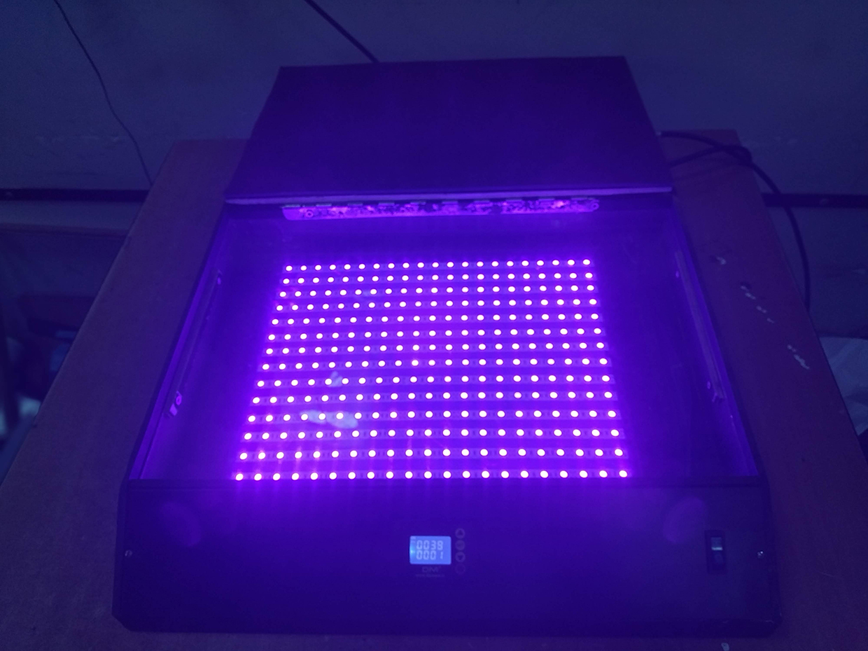

Hello, friends! My name is Sergey. I'm from Ukraine. For more than 12 years I have been doing alternative photography. Reading the forum, I often meet the question of UV unit on the LEDs. I made such an installation for my workshop. The first thing I wanted was compactness. I have to conduct workshops, and the possibility of transporting a unit is a great bonus.

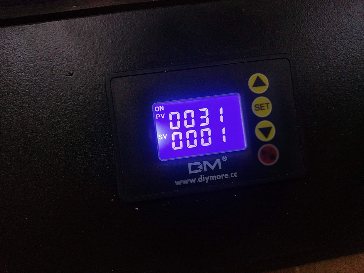

For installation, I chose 5050 UV-A LEDs with an emission band of 365-400 nm. 5 meter tape with a total capacity of 45 watts. 300 LEDs. LED strips were mounted on a sheet of aluminum. This is the basis and the radiator for heat dissipation. Although the LEDs are not very warm, this can extend the life span. The body is assembled from 6 mm plywood. The size of the LED panel is 48x36 cm, the size of the glass is 42x62 cm. I installed a timer that I bought on Aliexpress.
The test results are simply pleased.
Oilprint - 50 sec.
Carbon - 50-65 sec
Cyanotype - 80-120 sec.
The device is simple, very economical, compact.
I will be glad if my experience helps someone solve the problem of UV lighting for their work. I will be glad to answer all the questions.
Best regards, Sergei

Looks very good Sergey, congratulations! Those exposure times are nice and short, which is probably helped by the short distance between the light source and the print. I think you've shown very nicely that a perfectly functional unit can be constructed at a low budget and with great simplicity.

In LED devices, I apply the "5" rule.
The distance between the LEDs multiplied by 5 = the minimum distance of the scattering plane. In this unit, the glass is located at a distance of 6 cm from the LEDs, and has completely uniform lighting. The installation budget can be estimated at about 30 USD
