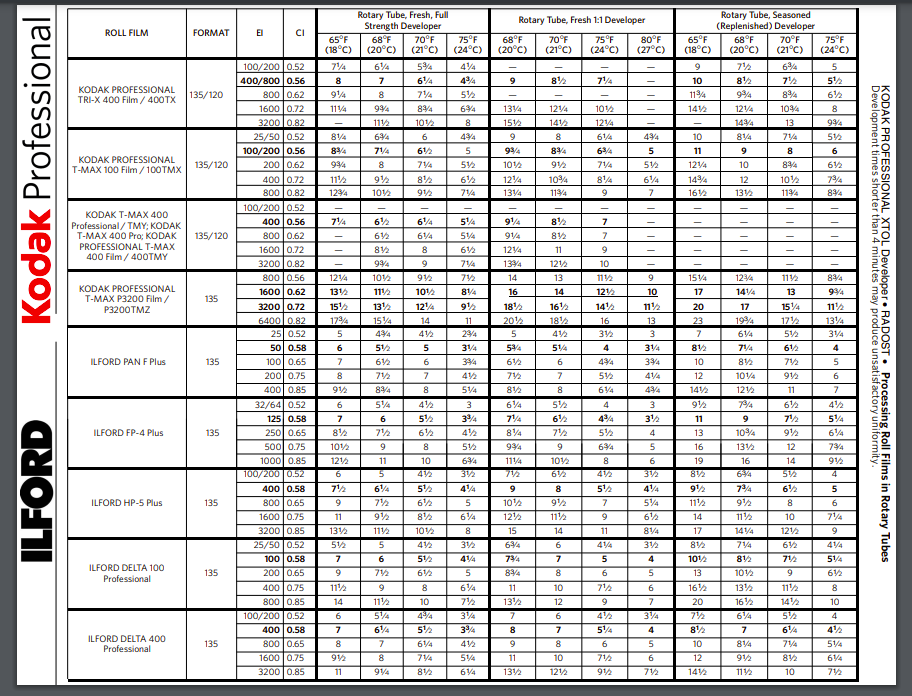

I made an updated XTOL rotary sheet.
Deleted expired films and optimized.
Separated ted a page for Kodak and a page for Ilford
Laminated in my bathroom.
  • Xtol Rotary RADOST version.pdf

Thank you. Now we need a line for Rollei IR 400 @ ISO 400 XTOL and Replenished XTOL.

It’s kind of strange KODAK does not recommend Tmax in replenished Xtol. Maybe that is why I ruined 2 rolls .

I mean give me all information for all temperatures Stock 1:1 and replenished.
I have not done stock for years and the last time I used 1:1 was the Twelfth of Never.
For clarity, Kodak does recommend T-Max - each of 100 and 400 and 3200 - in replenished X-Tol in deep tanks, and also recommends T-Max 100 and 3200 in replenished X-Tol in rotary tubes.
In my case, I get equally good results in replenished X-Tol in rotary tubes from both T-Max 100 and T-Max 400, but Use a full Paterson 1 litre tank, rather than the minimum volume of developer that often gets used in rotary tubes.
My failure with replenished XTol and tmax3200 @1200 was in Paterson tank full chemistry 600ml

Radost's further updated sheet - both as a jpeg and a downloadable pdf.
"My Final XTOL Rotary document
Kodak and Ilford existing films on one page.
Kodak Tmax 3200 only 800-6400iso
Delta 3200 missing since it is not on the official Kodak j-109 Xtol document."
