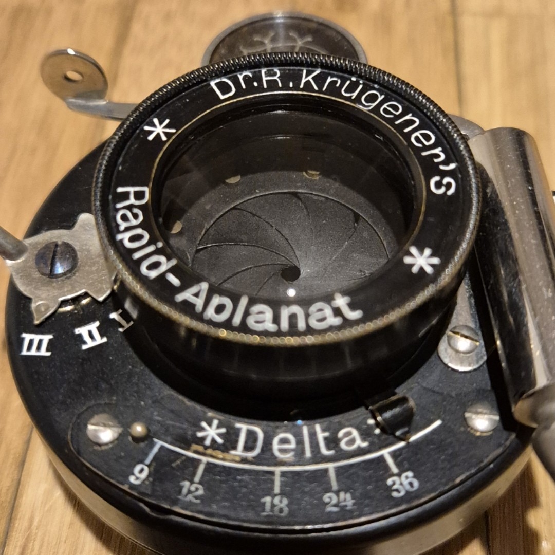

Hi Friends,
I just want to show you this lovely lens i got,
Dr.R.Krügener's Rapid Aplanat 165mm/f9.
Its super clean, working shutter, metal blades.
Unusual to mount but i will print a board.
Its from around 1905! Thats crazy, i can't wait to shoot some dryplate with this beauty.

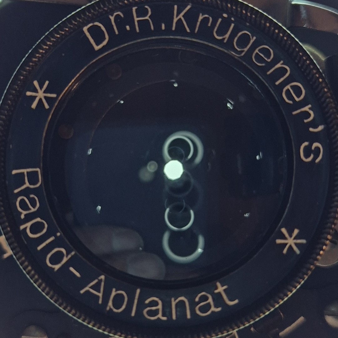

One strange thing is, the aperture is asymetric and there are additional pinholes in aperture. See image.
What beautiful images this is going to produce :smile:

I think you stopped down too much, that`s why there are additional holes. The aperture lever is beyond f36, this is too far.
Maybe that`s why the aperture is asymetric.
The holes are certainly there because of stopping down too much. If the aperture assembly is opened up, it'll become clear why: the aperture blades need to fit in the aperture torus and there needs to be space for the little pins the individual blades hinge on. As a result, the blades are limited in width at the base, and stopping down too far essentially breaks the overlap between the blades along the outer rim of the aperture.
The asymmetric aperture is pretty normal for older lenses; there are minor imperfections in tolerances/play and this compounds into a slightly irregular aperture shape. It'll be virtually impossible to spot this in an actual photo; the only way I could imagine is in a sun-star image where the angle between the stars is being measured - but who on earth would do something like this (unless working for the FBI, MI-5 or the KGB back in the 1950s), and the whole attempt would likely be thwarted anyway by the massive flare in a use case like this (uncoated lens!)

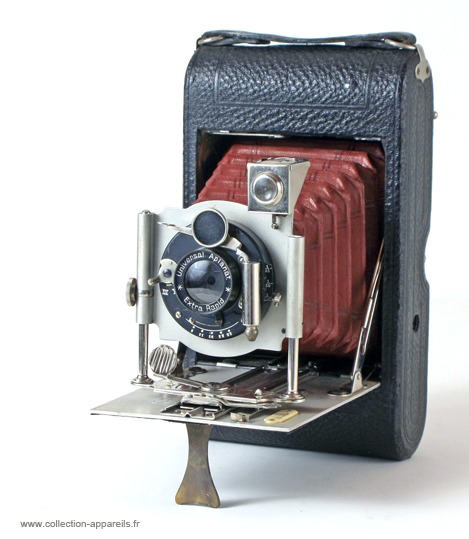

Your lens would typically have sported a Delta 7 camera by Krügener (the lens was advertized as coming from Jena - so most probably made by a Zeiss plant - not by Krügener himself):
The camera used Kodak 118 rollfilm, but could also use platefilm. The camera's by Krügener seem always to fetch relatively high prices.

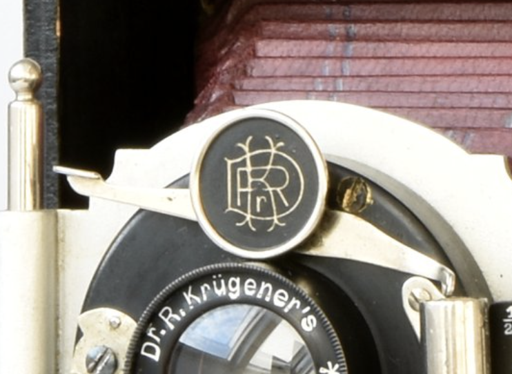

Looking at the logo of your shutter (at least what I can make of it), it seems to be made by Friedrich Deckel....
