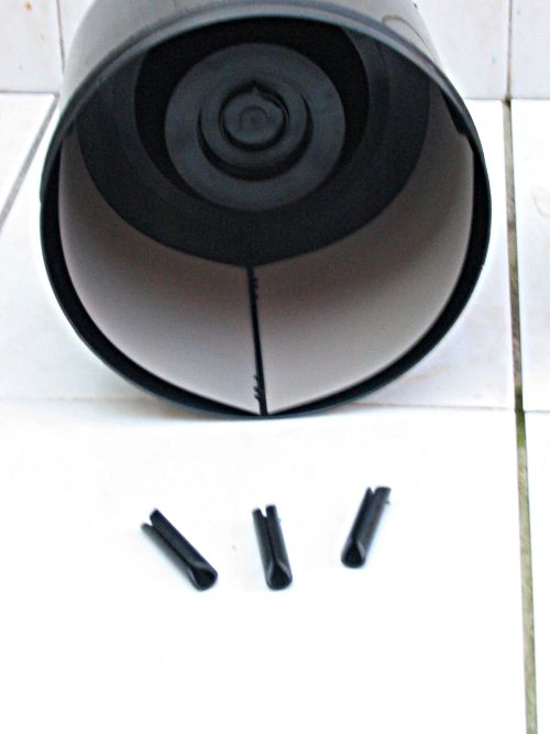

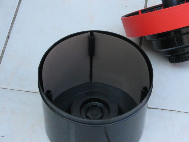

What I find most rewarding is that my development system in the small JOBO tank on a JOBO rotary processor succeeded! I thought the negs (there were 2 inside) would slip and scratch during rotation...
Attached are quick illustrations of the system I used - perhaps this info would be interesting to other beginners. It's just JOBO 2523 tank/drum, with 3 spacers attached to the inside ridges, keeping the 2 negs fastened.
However, this allows you development of 2 sheets max. When I get the proper JOBO 4x5 reel, it will take 6 sheets max, AFAIK.

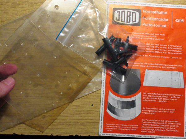

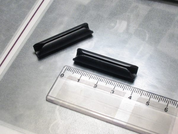

Paul, if you take a closer look at the first digi shot of the setup I posted above, you'll see three plastic "tubes" - that's what I used. Those are part of JOBO "Formatholder" (JOBO part. # 4206) that was used for their paper drums, for developing of test strips and negatives. It also has a clear flexible plastic "wrapping", which I did not use. The three digi shots show clearly how it's done.
I'm not sure you can easily get that JOBO part any more. However, it should not be difficult to make the needed "spacers" yourself. Just get some rigid plastic tube, diameter of about 8-10mm (or anything you can lay your hands on of similar dimensions, even a plastic casing of a ball-point pen), cut into pieces of about 4 cm long, and cut these short tubes lengthwise. Then try attaching them to the inside ridges of the drum. It may take a few tries to find the right material, but it shouldn't be too complicated.
I'm attaching photos of the spacers I used and the original JOBO "formatholder".
NB: the ruler is in cm (centimeters).
