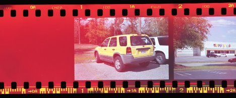

I have been developing c41 with Kodak Flexicolor for a long time but I've lately ended up having a couple of rolls of 35mm that have a green mask(same density as an orange mask in the unexposed frames and rebate). Is this likely due to a contaminated reel and tank, or to bad developer? The first 3 blank frames are uniformly green, the exposed frames are pretty much the correct colors except in the shadows, and the mask and rebate after the exposures begin is pretty much orange at the bottom of the film and gets more green nearer the top of the film. I've cleaned the tank and reel with kodak tray cleaner, and then let it soak in water overnight, but still have the same green mask even with a different developer kit. ??? Anyone have a suggestion? Thanks!

The scan attached is from a stip developed with the full Flexicolor kit and the Bleach III and the Flexicolor Fix. All entirely Kodak mix. The scan is not corrected in any way. The same results are had even if from different films shot in different cameras and in fresh mixes of the chemicals. I'm leaning towards PE's suggestion of fogging. Please notice that in each exposed frame the green mask isn't uniform but it is pretty uniform in the blank frames.

Well, the pH and sulfite levels would be off to start with and then in the image it looks like severe fog from a red or tungsten lamp or bad keeping. It is hard to tell. The overall density and contrast look off as well. The unexposed frame should be black or at least much darker meaning that the dmin is very high.

Ok. Another roll, and with a check of lights out in the 'darkroom', I see no signs of light. But, I'm convinced that it is fogging, and the reason why I'm convinced is that the leader and the first frame pretty much make up the circumference of the film developing reel in the middle of the reel. This area is the area that has the most evident green mask. The remaining frames are only slightly affected more as you travel down from the top of the film strip. So, the top of the film and the leader are the parts receiving the most fog and those parts are the most exposed to light when wound onto the developing reel and in the tank(open tank, I'm developing in the dark in open tanks). Now, if I can just see the light.

Dummy me. I'd changed two things: where I had placed the patterson tank that held the film loaded on the reel until the developer temperature was correct, which was a very dark spot in the cabinet under the sink, and how long I'd taken to get the developer temperature to the 100.5. As it turns out, the red ring around the top of a patterson tank will allow some RED light thru it. The last few times I'd developed film, i'd left the tank in a dark corner, but not in the cabinet with the door closed. And, I'd been slow about getting it in the developer. Thanks for everyone's input, especially about fogging.
