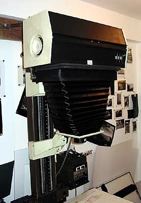

my enlarger takes a 14 inch negative, I stretched a 4x5 out to that size, just one of the many things you have to be prepared to do to shoot these odd formats.

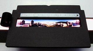

it's easier than you might think, the secret is finding an enlarger suitable for the conversion. At the time I owned one enlarger so it was the obvious one to investigate first. It's an early model De Vere 504 with colour head, this model was very common in this country in pro labs and I gather the same in the UK. I know there are plenty in the US as well. The later versions of the De Vere aren't suitable (for the way I did the conversion) because construction is quite different.
Basically the De Vere is made of 3 castings which are two end plates and another plate that the dichroic filters and lamp bolt to. The main body is folded sheet metal that the end plates attach to and also the filter plate.
So it was a simple matter of unbolting the original body and having a new one folded up that was 9 inches longer. Of course new bellows had to be made, a neg stage and carriers.
It took me 3 months to do the conversion doing bits and pieces when I had time. I had the body folded by a sheet metal shop, the guy that did it is the best I know in the business and it came out better than original because he improved on the design somewhat.
I have an engineering background and made all the other bits including the bellows. It took 2 goes to get them right and they're still not perfect but do the job just fine.
The conversion cost something like a couple of hundred dollars.
These days with modern equipment it would be easier to scan long negs and print digital output, I haven't gone down that route because digital printing is too slow and expensive.
My enlarger has printed many thousands of panoramic prints and never given an ounce of trouble.
I suspect most other enlargers wouldn't stretch as easy as this one due to their design but I think it could be done to most if you were prepared to put the work in. Like anything hard work has it's rewards.
The pics show before and after the conversion and a carrier I use
