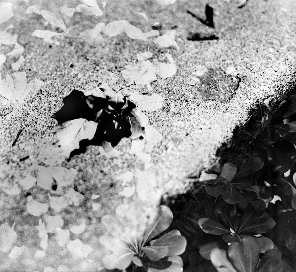

I sometimes shoot upward of 10 or more images pers negative. Here are a couple of examples, and when the darn scanner quits having a hissy I can show 3 more. It was a series I was doing to experiment with the Button on my Mamiya's. The first one was a pure accident. I didn't know I had it depressed. That negative has about 35 images on it. Yet it is the least dense of the bunch.
