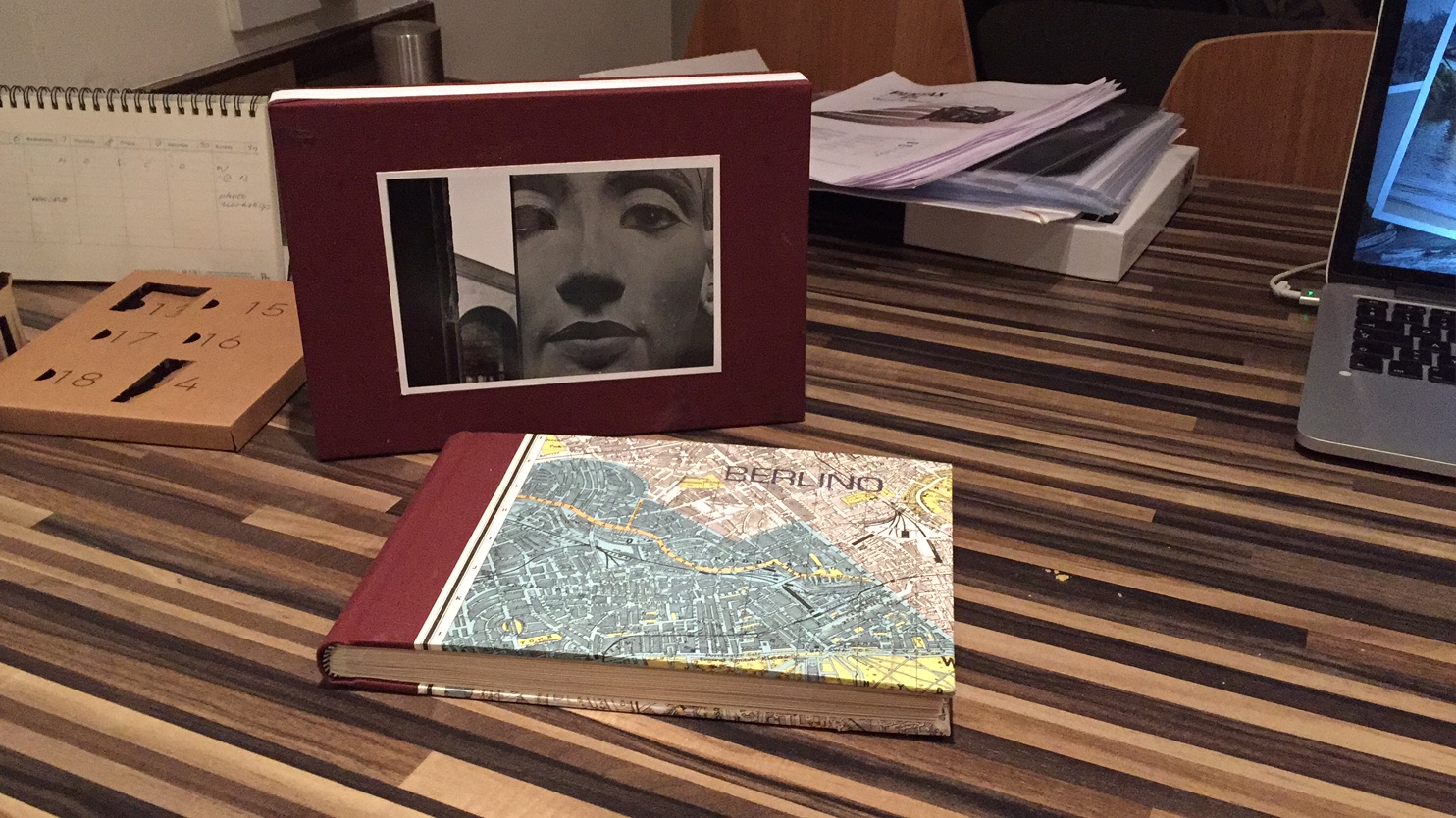

    Many thanks to all of you.
    I binded a couple of photo-books using traditional methods (sewing the pages and so on), I agree is kind of addictive and very time consuming but the results are astonishing. Here is the last one I did as a present, all from sketch, cotton paper, press printed and fibre based pictures. However if I had to sell one of those it will cost you a kidney :wink:
    So I want to make something simpler but still very well-finished. A well-made box is not an issue. I tried to mound a 8x10 print as usual (using a 4ply matt and mount board) but the result is not very elegant. Far too thick and it feels like a brick.
    I discovered the 2ply mat online which is about 1mm, but I couldn’t find it here in the UK. I am thinking to give a try with a good cotton watercolour paper which is about 0.5mm as a mat and mount board. I give priority to handling-experience and aesthetic. Archival is not the ultimate goal but I am using exclusively real acid free materials.

    Just to give an update - at the end I used a 4 ply board and the result was good - in the picture the mounted print and the box (as well handmade from scratch).
    Initially I wanted the print to be floated mounted on the board with a window mat leaving 1/4" top and sides and 1/2" bottom around the print. However, despite using a T-ruler, I found it difficult to cut the print precisely square. For some reason I was always 1mm off...
