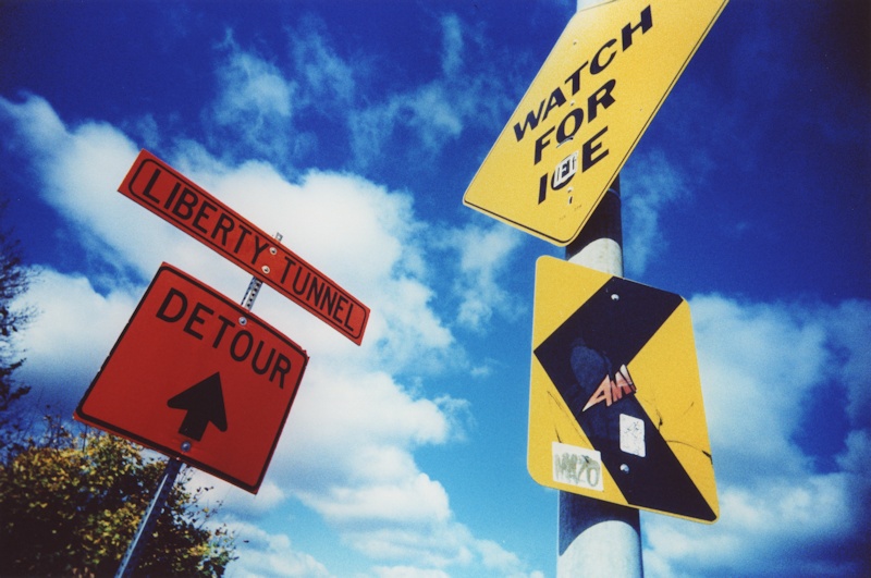

"Punchiest colors possible" -- consider cross-processing Provia or Ektachrome (expired or forthcoming) since you're coming from a background with slide film anyway. This is an RA4 print from a cross-processed negative (Ektachrome).
Whoa! I've never seen cross processing like that. The results of most cross processing I've seen come out very strangely colored...
Cross processed film may produce Color shifts that won't balance when printing. Sometimes it works good sometimes it doesn't.
