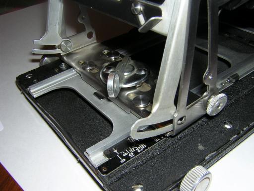

Ian,
I think I see what you mean (see attached photo). That should work and I suppose having the screw at the front end of each slot will get back to vertical. I'd hate to hack up a nice Graphic though.
Dan

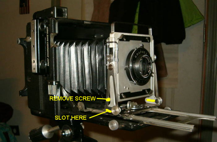

OK I checked on my 4x5 crown graphic with the TOP mounted rangefinder and reversing the front standard should not affect any other operation.
However on my 2x3 century graphic, reversing the front standard is not possible unless I completely remove one of the tilt-lock nuts, because it would not allow the standard to slide all the way back into the camera.
So I am not sure if you can reverse the front standard on a side-mounted crown/speed graphic. I used to have one that I hacked to get front and back tilt. Heres how I did it: (photos attached)
Cuting a curved slot in the standard will also work, but my skills at cutting a nice arc like that are not so good, so I drilled a new hole for one lock nut and you can see the rest.
How did you get the release lever to point forward? Did you remove it then reassemble it to face forward? This looks like the way to go.

Robert,
If you're referring to the lever that locks the standard to the rails, I found this morning that once the standard is off the rails it will rotate around 180 degrees. Whether it works properly at that point I didn't try.
