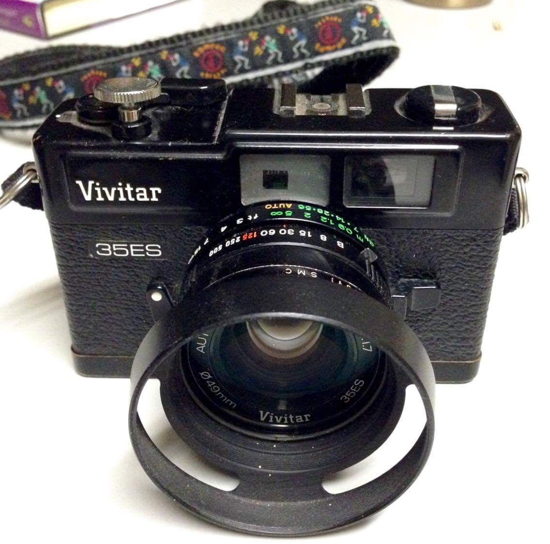

    I think the sweetest of all the Hi-Matics is the Hi-Matic E, if you can find one in working condition.
    And for those considering the 7SII or its kissing Cosina cousin, the Konica Auto S3, but who don't like that plus-$200 price tag, there is another member of the family that is basically the same camera, only prettier, and which often flies under the radar, the Vivitar (yes, Vivitar!) 35ES:
    [​IMG]
    Vivitar 35 ES by Greyscale3, on Flickr
