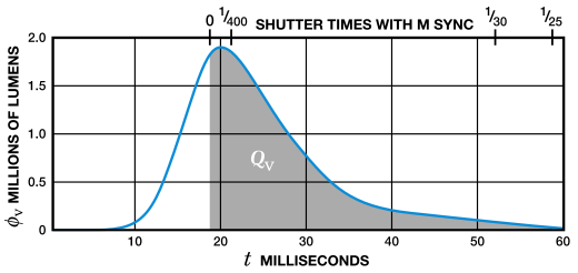

This graph from Wikipedia shows the bulb triggering off the M synch (20mSec before shutter opening). So if you trigger at X (when the shutter is fully open) you can cut off some of the light output at higher speeds as the curve would be shifted to the right by 20mSec.

- M sync would have allowed me to use the bulbs at any speed (within the shutter speed limitation of the bulb specified by manufacturer) since M is delayed 20ms, allowing for the light to be captured.
