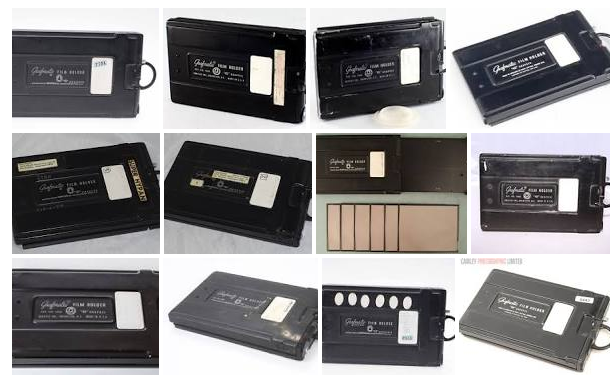

  15. Sirius Glass

  19. Sirius Glass
    Sirius Glass Subscriber
    Ads Enabled
    Messages:
    28,213
    Joined:
    Jan 18, 2007
    Location:
    Southern California
    Shooter:
    Groups:
    Yes, I do not have nor have I ever seen the MF Grafmatic, but one could put peelable labels on the back of the MF Grafmatic and that would help solve the OP's problem.

  22. Sirius Glass
    Ads Enabled
    Messages:
    28,213
    Joined:
    Jan 18, 2007
    Location:
    Southern California
    Shooter:
    Groups:
    Here are twelve examples:
