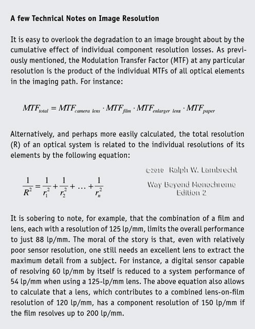

If money is an issue then wait until it is not. Have a garage sale, cut back on some other expenses (like not eating out so often) etc until you can afford a six element lens. Like Mr. Lambrecht stated, enlarger lenses are dirt cheap these days so it shouldn't take too long. Having purchased a medium format camera as you did, you obviously care about image quality. Having a six element lens to enlarge these 6x6 negs is simply another link in the chain that leads up to your final prints. Think about it - why bother shooting such a fine camera as the C330 if you are going to compromise quality at the printing stage with a cheap lens? Save your money and buy a top notch lens; you'll be glad you did.

Marc's point about the image link cannot be overemphazised. See attached:
