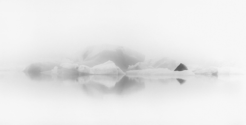

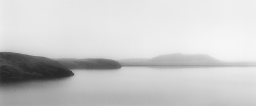

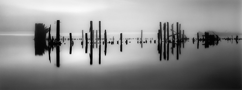

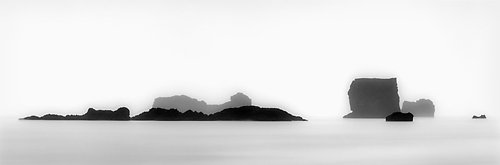

Here are a few fog photos. I find that higher contrast film helps because in order for fog or light values to have their sense of lightness you need some offsettting darker tone. Even a tiny bit of black or dark gray helps to define the lightness of the fog. I either will shoot with Techpan, or go N+1 , or more with foggy images. As for metering If I know that I want a small dark element to go Zone 3 or 4 I meter it and expose it for that, I then place what zone I want the fog to be in with processing pushes. However some scenes are so foggy and low in contrast that the largest tonal range I can get is from zone 4 to 6, that requires serious pushing and a high contrast paper. And sometimes it just doesn't happen.
