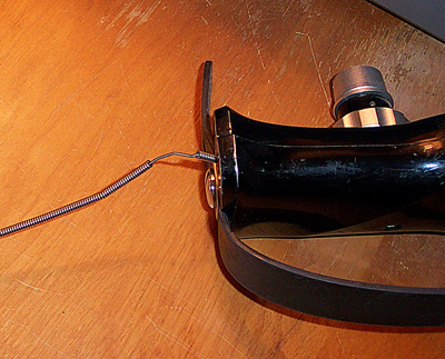

I just received a Mamiya Universal that I bought on Ebay. This is the first viewfinder camera I've owned (aside from polaroids and p&s), so I'm very unfamiliar with the way everything works. The description was;
"Mamiya Universal medium format camera. This camera has the 100mm lens. All functions work great.The back is a 6x9."
Unfortunately, the shutter release from the pistol grip (is that the right term?) is broken; I attached a picture below. Also, the light seals are in very bad condition, on the camera and on the 6x9 back. I plan on sending the guy I bought it from an email about these problems, but I wanted to ask a few questions of anyone familiar with the camera first.
First, are the light seals worth mentioning, or should I consider that a given with an older camera like this? Second, I thought that maybe I should quote a price on getting the shutter cable repaired or replacing the grip... anybody have an idea what either of these would cost? Lastly, the camera came with a Mamiya-Sekor 100mm f/3.5 lens. The lens is made to collapse into itself a bit and it must be pulled out fully to use, or the focus will be off. Perhaps I'm missing something, but when I pull it out fully and twist it slightly everything seems fine. Then I go to adjust ss or ap in a counter-clockwise motion and the lens collapses down. Should it be locking in place? Is this another defect?

I can't help you directly with your questions about the camera except to say that it's not at all unusual for cameras of this vintage to need new light seals. It shouldn't be an expensive job and depending upon what you paid for the camera shouldn't necessarily be a deal-breaker. However, considering the description and the condition you describe, you may want to return it to the seller. In any case, you should contact the seller regarding the discrepancies.

I have a mamiya press (basically the same camera). I shouldnt worry about the pistol grip too much, you cant really hand hold these cameras without camera shake. just use a normal shutter release cable.
The lens should lock into position (it clicks when you twist it), sounds like it is worn. It still should be usable if you hold it whilst adjusting the aperature.

I have an extensive Mamiya Universal System with multiple bodies and several backs. The light trap is not dependent on the foam seal. It's a mechanical trap and as long as contours are still closely matched I've never had a light leak with any of my backs. The foam is always dead on these. Gooey nasty stuff. I have a "near" direct replacement for the cable release. Identical but about 1 inch shorter. They were used for many years on Polaroid C4 tektronics CRT cameras. I can send you one for $15. Works on all of the Universal lenses but perhaps the 150 and 250mm. I always use a tripod and a seperate cable release anyways as a remotely held release button cures shake. Try giving your 100mm a harder twist. It should have a "high" spot it bumps over to lock in place. The other lenses for this system are all excellent. The Mamiya is my "color" camera. I'm a LF B/W guy but when people require high quality color I don't waste my time with expensive 4X5 chromes. I have many 20X30's in public places made with the old Mamiya and Velvia 50. The 50mm wide angle is Superb! Worth more than you paid for your whole system so far. It's a Zeiss Biogon copy. Do yourself a favor and don't buy one without the finder included. The accy. focus screen is worth it's weight in gold for anything that the finder won't tell you like macro etc.
