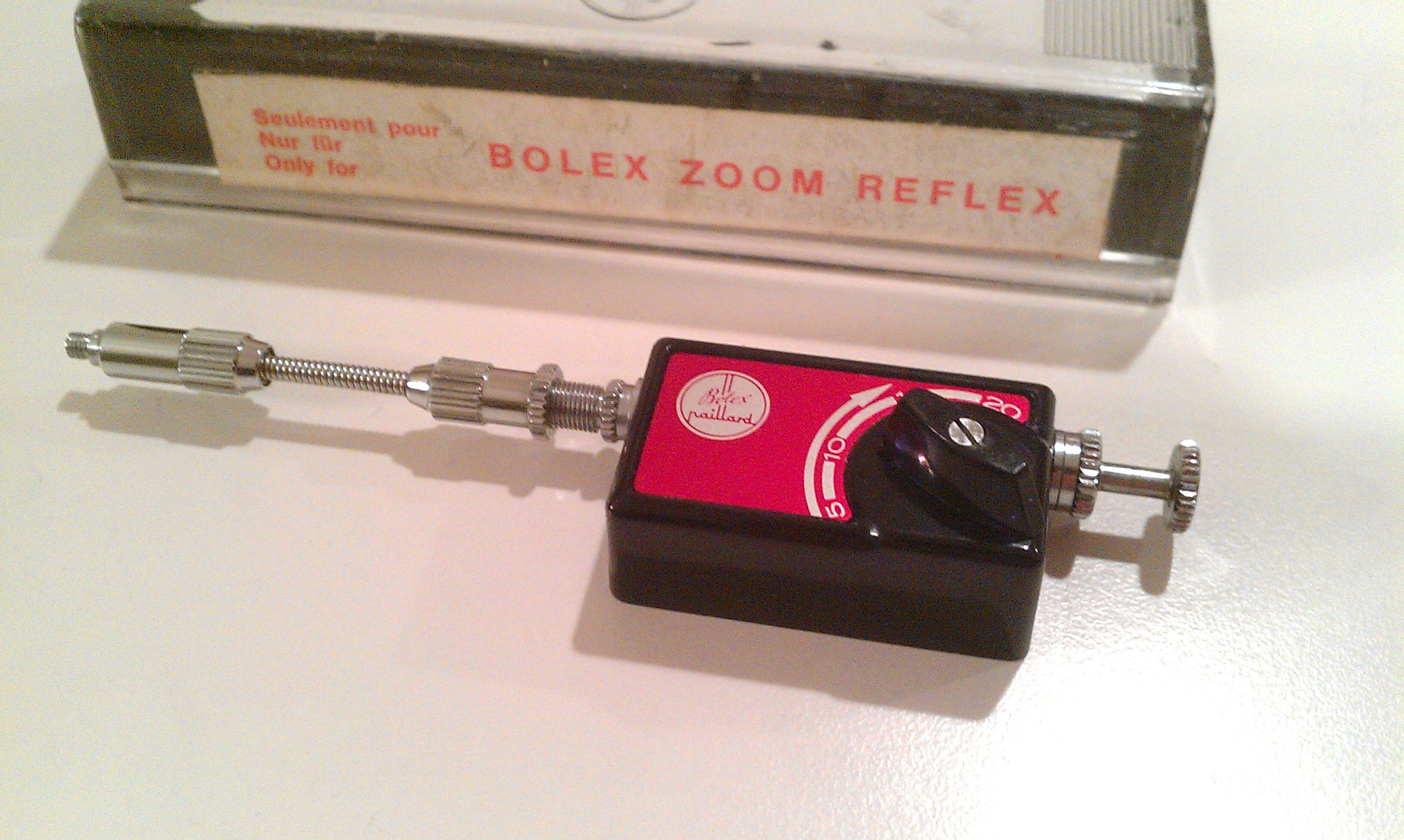

External self-timers can be found inexpensively. This one, for a Bolex ciné camera, was less than 2€. After a fixed number of seconds, it will depress the shutter for a selected number of seconds. If used on a still camera, it could be used to trip the shutter once (at your selected shutter speed) or it would hold the shutter open for a selected interval if you chose B.
