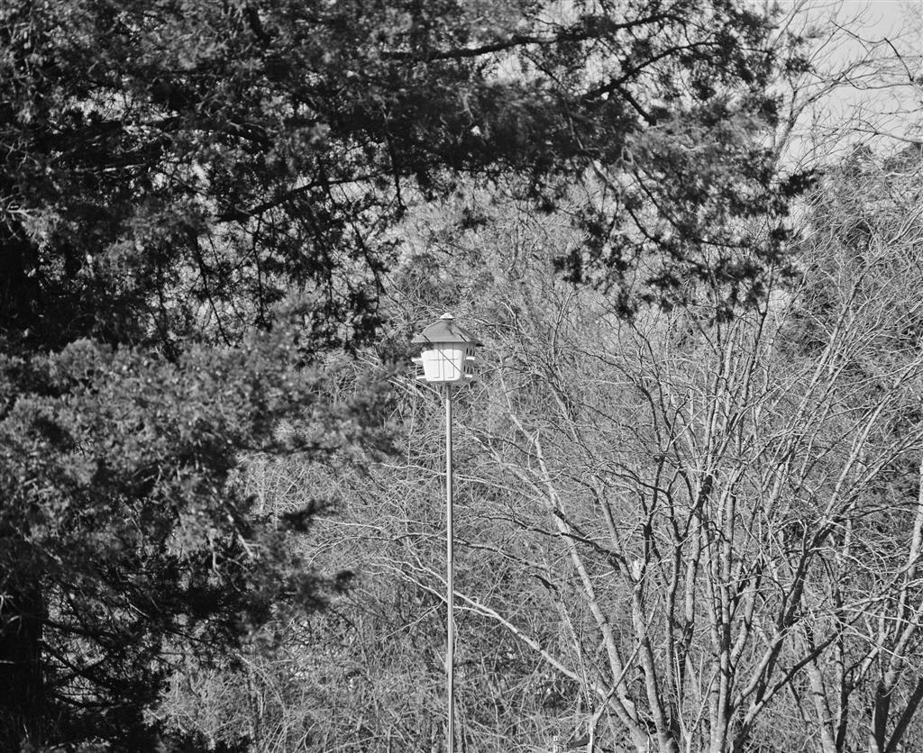

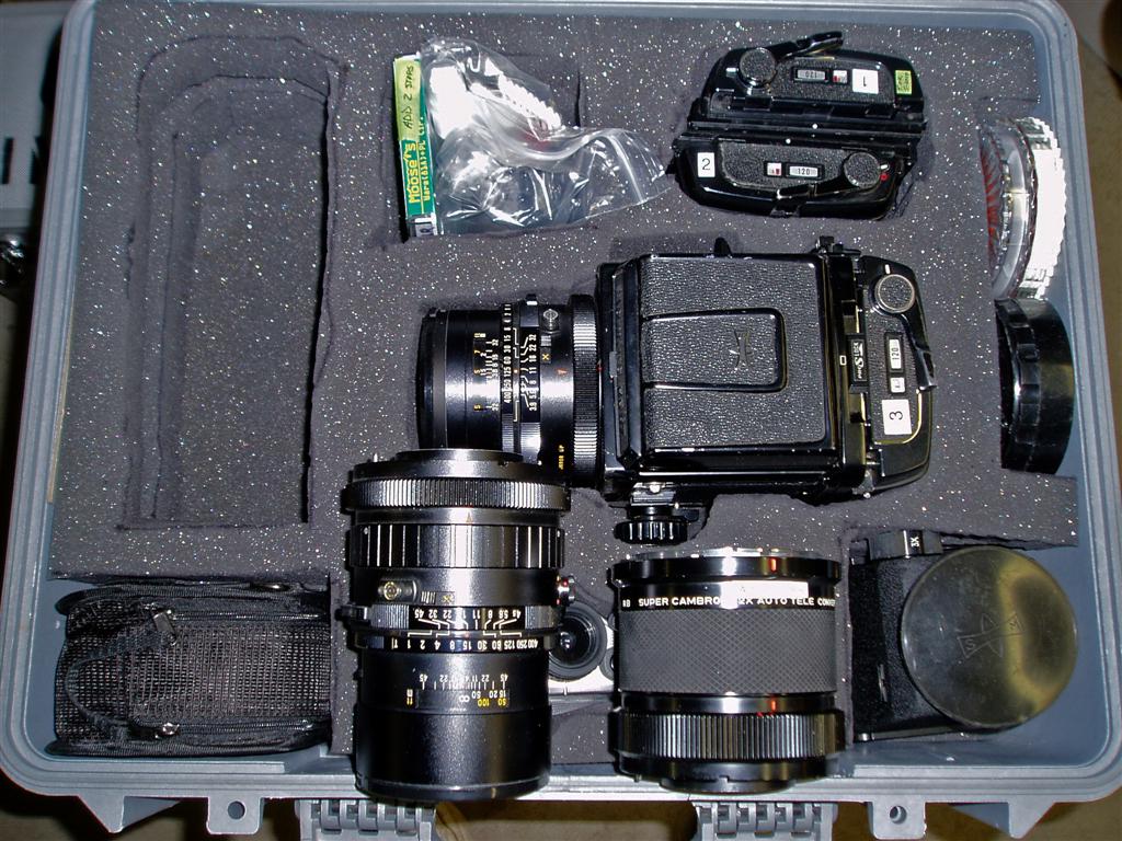

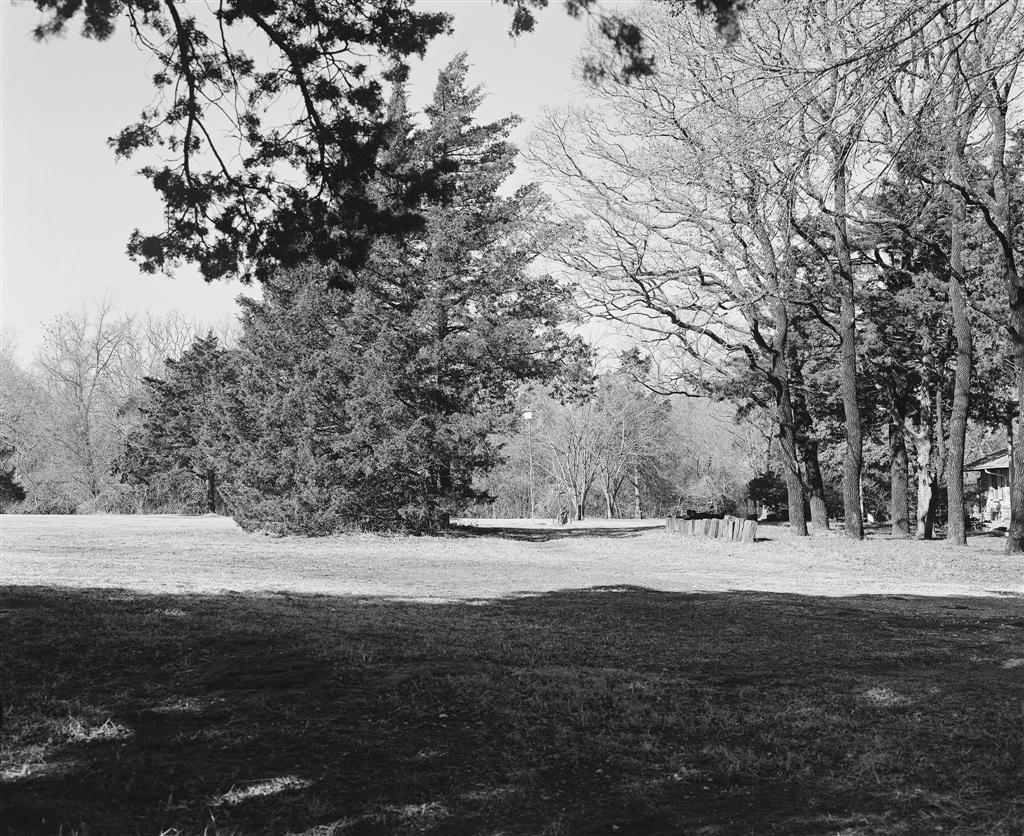

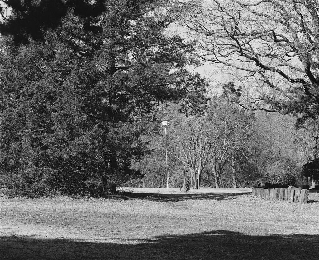

Augie, I realize you can't tell much about sharpness from an online image, but for object size comparison here are some images without and with the converter from last summer. First one is 90mm, second is 90mm + converter, third is 250mm, fourth is 250mm + converter. The white birdhouse in the center was the focal point. Even from this online image if you jack up the size of the 250+2x shot you will see that sharpness is not really a major issue with this converter, at least for my purposes. Maybe I just got lucky and got a good one? Last photo is my "road kit" to show the relative size of the converter vs other lenses.
FWIW, this 2x converter is branded "RB Super Cambron 2X Auto Teleconverter". It's a heavy sucker, about the size of a 90mm lens, and weighs 1 lb 5 oz. Locks up tight on both ends. The white label on it is a reminder to my feeble brain to add 2 stops when I use it, which BTW makes my 250mm an f/8 lens, the only real drawback. Doesn't bother me, might be a problem for some folks. More convenient to use and FAR cheaper than a big super tele, though, and gives me 500mm vs 360. Nyaa, nyaa, nyaa!
I have no idea whether Mamiya ever made RB converters. There are none shown on my Pro-S system chart.
