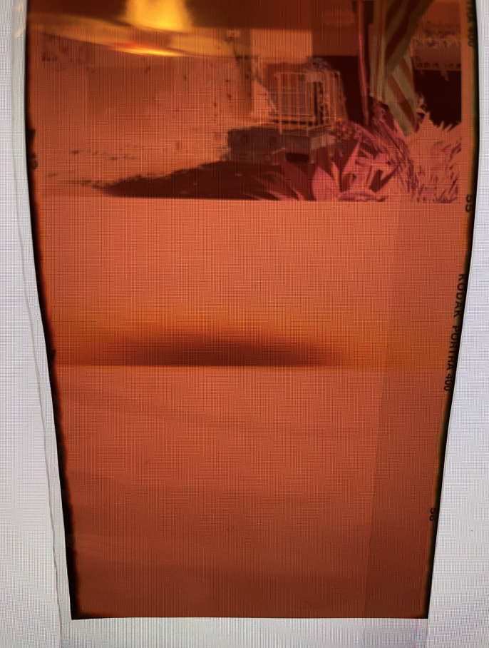

Hi, sorry if this is not the right technical term, but this is how the first frame of every single roll I develop looks like (see attached photo). The top half is burnt. This happened with 5 rolls, so I've started to think it's something I do wrong when I load the film.
Honestly I follow the steps that are shown in several YouTube videos, I aligning the START on the roll to the START indicator on the insert, put the insert back in and rotate until 1.
I was wondering if anyone can clearly recognize this problem and tell me what I do wrong :smile:
Thank you!

Is this slide film or negative film?
Can you show us the film itself, including the edges, the numbers and letters and the space between frames?
A backlit shot with a cel phone is often enough - a white computer screen can provide that back light.
Is there any chance that the insert you are using is for 220 film?

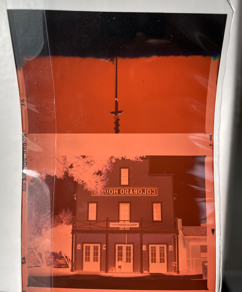

Thanks for the quick reply! I've attached a photo of the negative C-41. As you see the second photo is fine. The insert has the 120 number on it.

The number 41 should be adjacent to the middle of the first frame.
Before that frame there should be nothing but clear film - there should be no fogged area.
Is this lab processed? If not, how are you processing the film?
Is there any chance this is 220 film?

You should talk to the lab about the fogged area.
That being said, the camera isn't advancing the film as far as my Mamiya 645 Pro - by about 1/3 0f a frame.

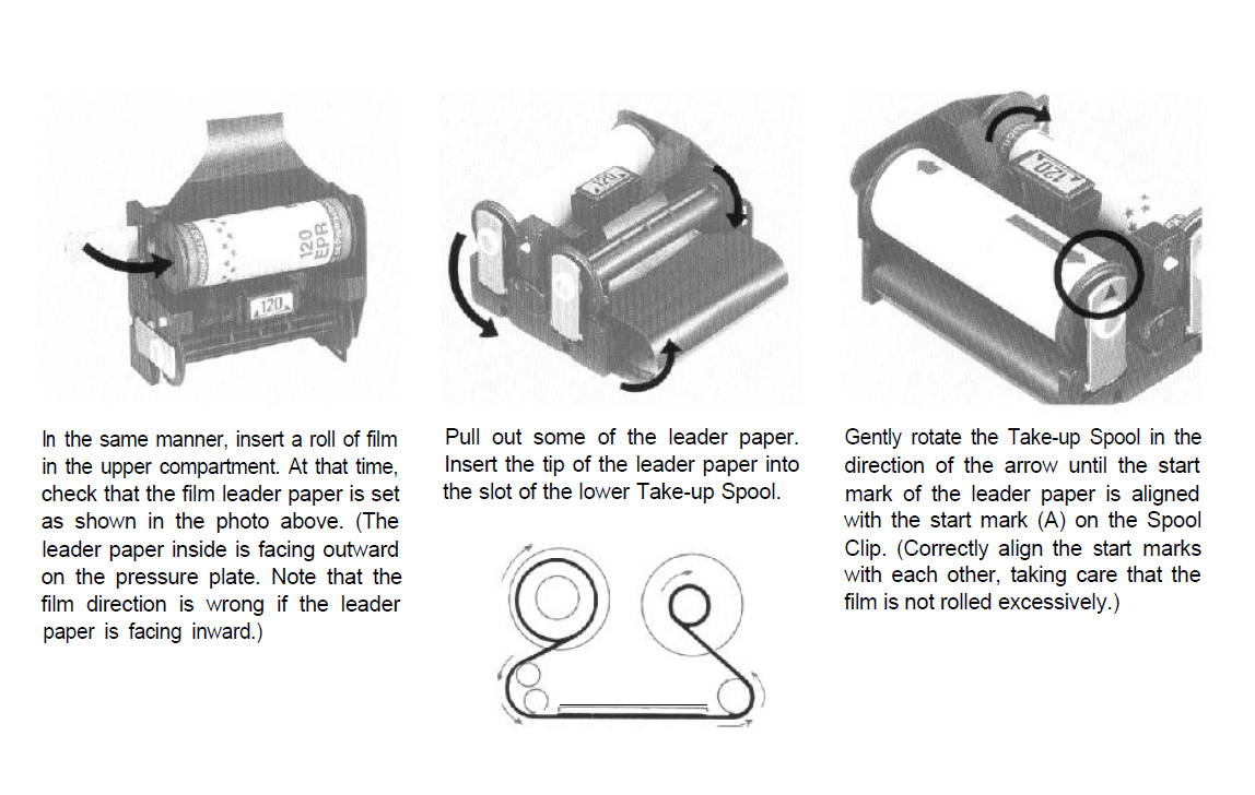

Is this what you have in the manual you are using, and are you doing what it says here:
(this is from the instructions for the Mamiya Super, but the inserts all work the same).

Thanks, I will talk to the lab. I have a Mamiya 645 1000s, and what you've showed is exactly how I'm loading the film. And actually another piece of important information (that I forgot to mention, sorry) is that this happened with 2 different cameras (same 1000s model, I had to return the first one because of another issue), so wouldn't it be a big coincidence if two cameras had the exact same problem? That's why I thought that it's either something I'm doing wrong when loading the film or something the lab is doing wrong (which I'd be surprised by, since it's their job).

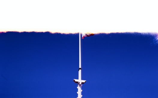

The camera takes 15 shots per roll. I've attached a photo of the end of the roll. It's interesting because that part with the light leak (I clearly botched the exposition) is the 15th frame. But there is a big empty area after it.
I don't have another insert to try sadly. I will show this to the lab when I go get my next roll.

There also appears to be more unexposed area on the film after the last frame than is normal - my 645 Pro puts the middle of the last frame adjacent to the 12 and the 55.

What cramej posted about the taped leader type of processor is what probably happens at the lab - if your camera and insert were advancing properly to the first frame it wouldn't matter.
When I'm loading my camera, I put the film into the insert with the paper retaining strip still on it. I break and remove the strip, and then carefully pull the backing paper around and attach it to the take-up spool, which I turn until it has full purchase. I keep tension on the feed spool throughout, in order to prevent light leaking past the backing paper. Then, before advancing any farther, I insert the insert into the camera (in my case, the camera back).
It is only when the insert is in the camera that I advance the film further (using my thumb on the edge of the spool usually) until the start mark lines up.
In the OP's case, I would suggest advancing it about 3/4 of an inch further before closing the back, to see if that compensates for the frame spacing issue. With the Mamiya 645 there is usually more unexposed film at the other end anyways.

Properly loaded, there should be areas of clear space at each end of the roll. Unfortunately, when getting negatives back from a roll, both ends are usually discarded and thrown away. As a result, we really don't know how well your camera is advancing the film. Nevertheless, if this was a film advancement issue, the defective part of the image would extend to the edge of the film and there would be no fogging. Advancing the film a few more centimeters before closing might save the first frame, but runs the risk of cutting off a portion of the 15th frame. Unlike 35mm, no part of a 120 roll should ever be fogged as a routine event.
If you choose to keep using the same lab, ask them to return your next set of negatives uncut so they you/we can evaluate the proximal and distal ends of the negative.
I have a m645 and m645 1000s. The only times I have had an issue was with a new film where I misread the labelling on the paper and a single roll where I suspect the film was improperly taped. That is not the case here, and if it were, we would have extensively discussed this on Photrio.
I am fairly certain that this is a lab issue of some sort. For the time being, you can ignore your first shot, or advance an extra 2.25 cm and be careful not to make an important shot with #15.
