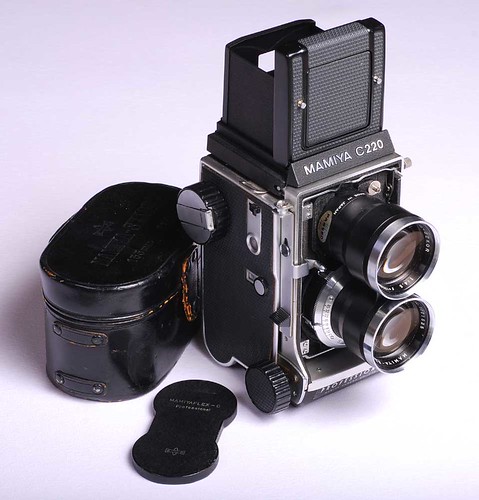

I am about to buy a c330 thats in great condition with a 135mm 4.5 Sekor lens. But the problem is, I cant hardly find ANY information about this lens. Do any of you have any experience (good or bad) with this lens and/or any pictures taken with it? I'm hoping its a good enough lens to use for portraits and such until I get an 80mm.
Any help would be greatly appreciated!

The camera and lens you have pictured shows a C220 with a chrome series lens. Your post mentions a C330. Is the camera and lens pictured the one you are considering? If so, you should be aware that it is difficult to obtain parts for the shutters in the chrome series lenses.

I have that lens for my C220. I've used it mainly for portraits, and I find it very good in that application. I think it's a bit too long for general street shooting, but for that I use either the 80 or the 105. It's true that the "chrome lenses are difficult to have repaired. There are quite old and the supply of parts for them is scarce. But if the lens and shutter are in good condition, it should serve you well for a long time. These things were designed to be used by working event photographers and they're not all that delicate.

haha, i just realized i posted a picture of a c220. My bad. I'm actually looking to buy a c330.
