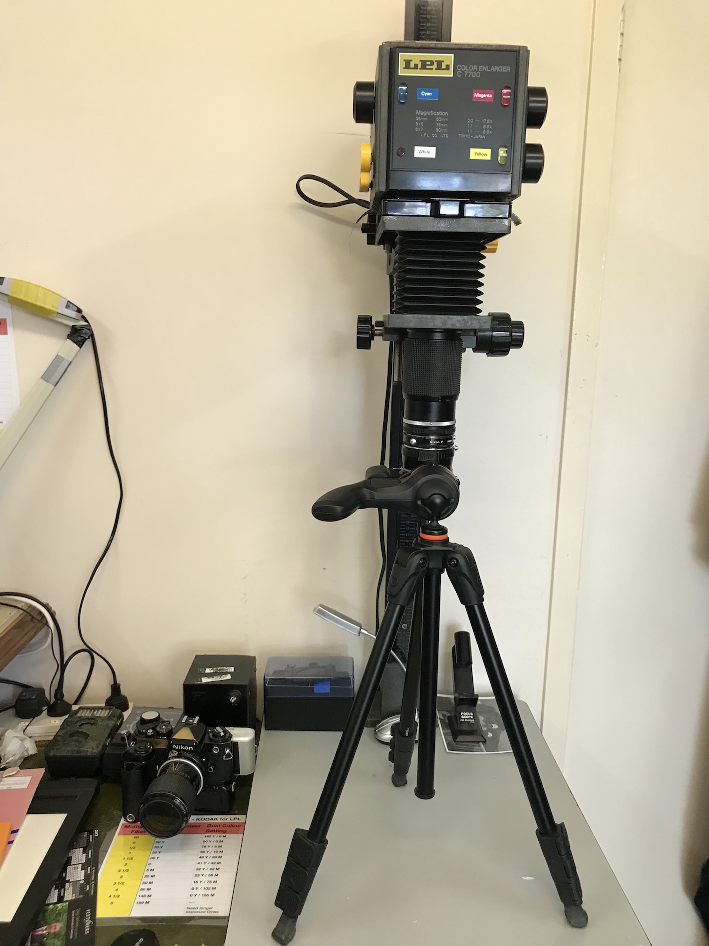

    Yer I know, that title is a bit deceiving. But I thought I could use my enlarger as a light box for scanning negatives so I could see if the results were better than using the old OpticFilm 7400 scanner that cost me a $100. Well now that I have sorted out how to reverse the negs to positive without having PhotoShop, I am fairly happy with the results.

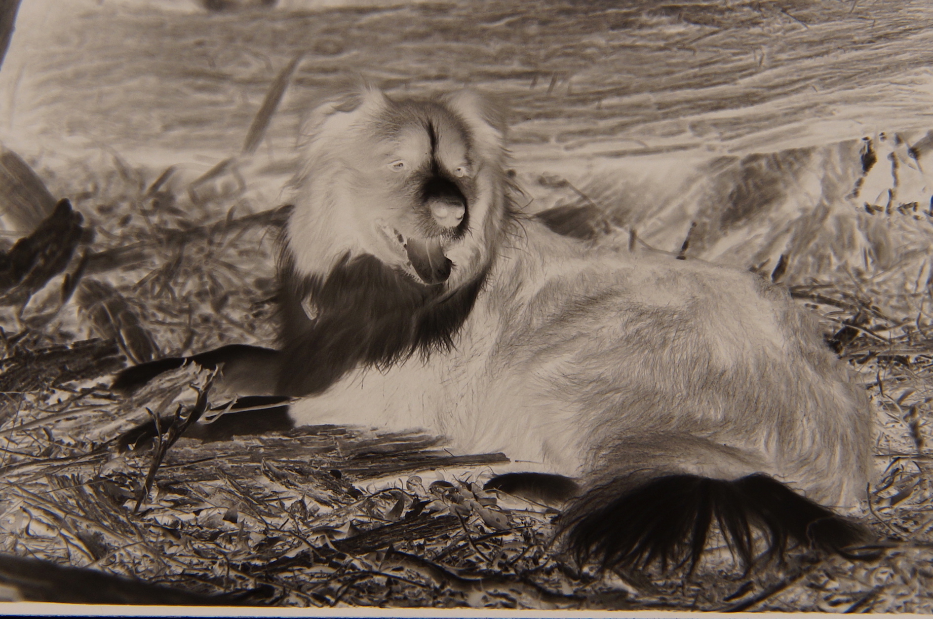

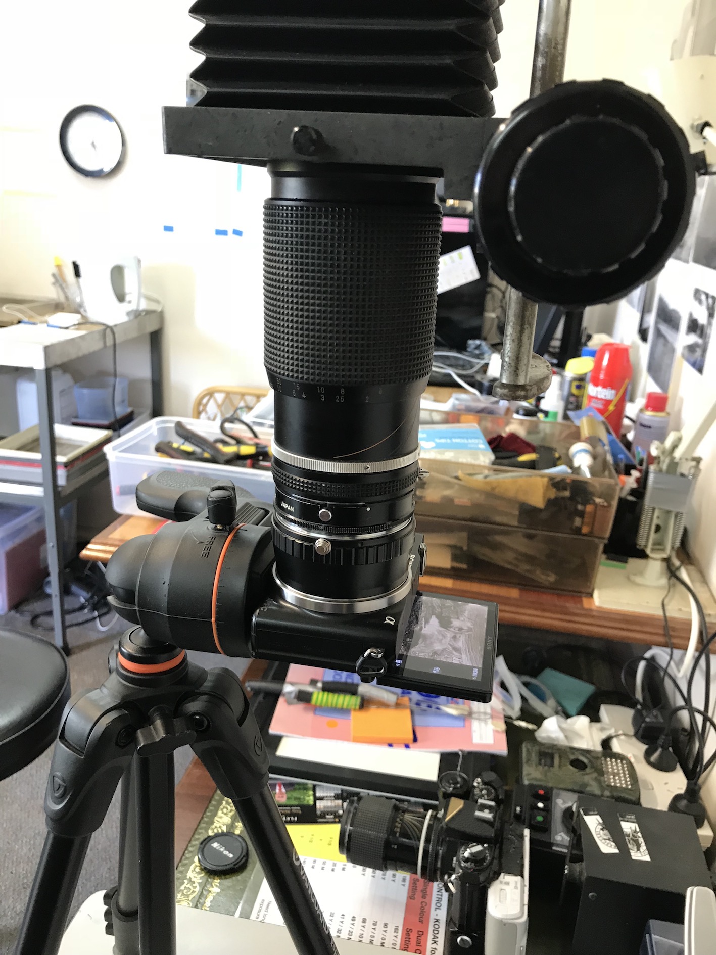

    I used a 16mp Sony Nex 3N with a macro extension on a Nikkor 35-135. I set the lens to F11 and the Nex to ISO 200 Auto WB and 10 second delay timer. For focus I used the yellow focus peaking so it hit the negative spot on and F11 helped I guess. It was possible to lower the bellows down over the Nikkor to block out the light so I did this with the lights in the room still on. The macro was still not big enough as I still had to digital zoom a bit on the Nex.
    Once I had the negative image I opened it in Gimp 2.8. First I inverted then used Colours/Auto/White Balance followed by Colours/Auto/Normalize. I then overwrited the image/exported as JBG. The end result was a 12.5mb image where as the OpticFilm scan was 1.5mb. Bit of a process with the Enlarger setup but once started it would be a lot quicker to photograph all the film strips than it is with the scanner. However the Gimp inversion correction is a bit slow but maybe this can be made quicker via the Mac Automator program. I am dead set trying to not have to buy PhotoShop, but maybe it is quicker than Gimp.

    I don't know why more people don't scan like this, you can also get a camera copy adapter for that enlarger as an alternative approach. I have one for mine, it fairly quickly turns the thing into a pretty solid copy stand.

    Yes Les, it is a Nikkor 35-135 attached to a Nikon macro adapter then a Nex/Nikon adapter. This got about 2/3rds of the image onto the sensor then I had to use the Nex zoom feature to fill the sensor. The old lenses work well as they fit up inside the bellows so room lights don't affect the picture. I have some macro tubes for a Leitz lens so will experiment with these to see if I could get closer to the negative to fill the APS-C sensor.

    If it is strictly for the purposes of blocking ambient light then a black shroud would be easy. I don't know how your zoom lens performs, but I would bet that any prime would provide much more resolution then that zoom.

    I have used this process as well. I would recommend not using a zoom lens if at all possible. In many cases it will loose some contrast and will not be as sharp as a prime or macro lens. Personally I use a Nikkor 60mm macro lens on both Nikon DSLR's and Panasonic m4/3 cameras. The results are much better than I can get from a Epson V750 pro scanner. I have also used a colour corrected light table as a light source.
